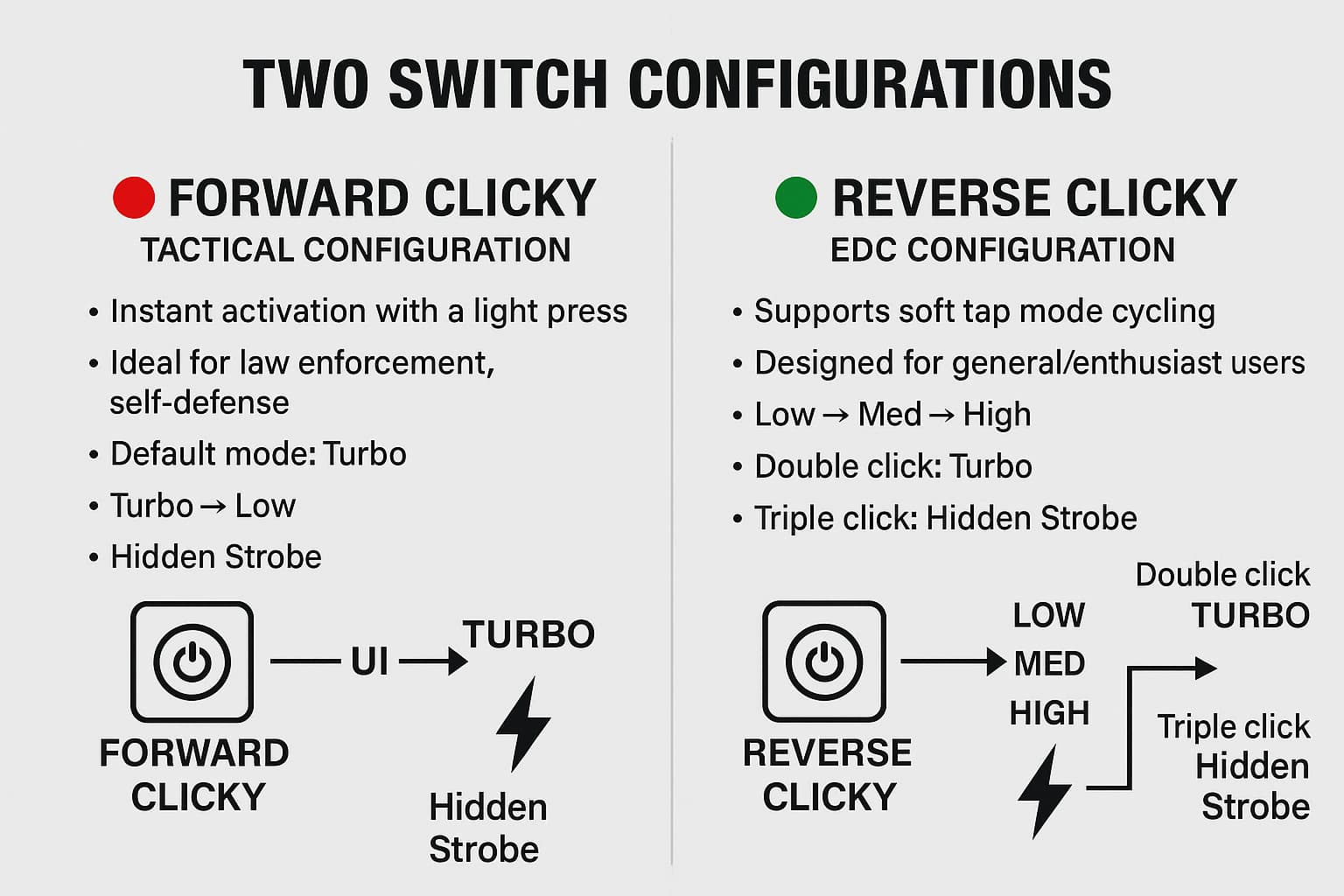

We’ve carefully considered the different preferences from the community, and we’ve decided to offer two switch configurations to better serve both tactical users and everyday enthusiasts:
:red_circle: Forward Clicky (Tactical Configuration):
  • Instant activation with a light press (momentary-on)
  • Ideal for law enforcement, self-defense, and high-stress scenarios
  • Default mode: Turbo
  • Simple two-mode logic (Turbo → Low) + hidden Strobe
  • No mode memory
:green_circle: Reverse Clicky (EDC Configuration):
  • Supports soft tap mode cycling (Low → Med → High)
  • Double click for Turbo
  • Triple click for hidden Strobe
  • Designed for general users and flashlight hobbyists
  • No Moonlight, no unnecessary complexity
This way, users can choose the configuration that best fits their use case. The UI and hardware are tuned accordingly for each.
Let us know which version you’d prefer — we’re listening and building based on your input.
Thanks for being part of the journey!

Moonlight is very important for some and usually accessible through “Long press from off”.
Your UI still has room for that, so maybe implement it.
Nice!
I like that reverse clicky UI.
I rarely use Turbo because it causes most flashlights to quickly overheat, so L/M/H should work for me. :slightly_smiling_face:
