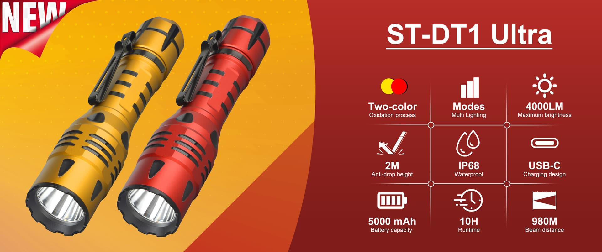

⚡ [FEEDBACK] | Building Our First Flashlight – Dual-Anodized SFT-90X – Help Us Get It Right! SABERTOOTH ST-DT1 Ultra
Hello BLF friends :waving_hand:
We’re a small team of engineers and flashlight lovers from Shenzhen, After years working on structural design and surface finishing for other brands, we finally decided to create our own light — something that blends performance, personality, and precision.
Introducing:
** SABERTOOTH ST-DT1 Ultra – Dual Anodized Tactical Flashlight**
:hammer_and_wrench: Built around SFT-90X LED, CNC-machined, dual-color anodized, and 100% field-tested.
:fire: Why it’s different?
:red_circle: Dual-Anodized Finish – Not painted. Not printed. Real dual-zone anodization (Black + Red / Black + Gold). CNC first, then separated anodizing process. Took us 50+ failed prototypes to get it right.
:triangular_ruler: Quick Specs:
Spec Value
LED Luminus SFT-90X
Max Brightness 4000lm
Max Throw 980m
Battery USB-C 21700 21750, 5000mAh
Modes Turbo → Low (cycle) + Strobe
Length 165mm
Weight 162g (w/o battery)
Colors black
Waterproof IP68
Switch Tail switch (Tactical + Memory + Double-click strobe)
:gear: UI Operation:
Single Click: ON/OFF (with memory, 3s delay)
Tap When ON: Cycle Turbo → Low
Double Click: Strobe (anytime)
Press & Hold (OFF): Momentary ON
:speech_balloon: Why we’re here?
We’re preparing to launch on Kickstarter soon, but before that, we want to hear from the people who really know flashlights: You guys.
We’d love your feedback on:
  • Design details (structure / UI)
  • Colors you like
  • What you’d expect in this price/performance range?
Looking forward to your feedback and questions.
We’re here, we’re building this with you.
Cheers,
SABERTOOTH

Keep the red and yellow too, as they are in the photo, they look very nice and unique… ! And make the other colors similar type like them !

We definitely kept the red and gold (scarlet fangs and black and gold armor) - we agree that the anodizing turned out better than we expected. Glad to hear the photos reflect that uniqueness.
If we release new colors like Navy Blue or Forest Green, we’ll make sure to keep the same double anodized finish - not just a color change, but full metallic texture and contrast, just like the originals.

I really like the general design and the unique colors of your first model. The dual anodization process sounds promising!

I love the Red and Gold colors and dual anodizing!
