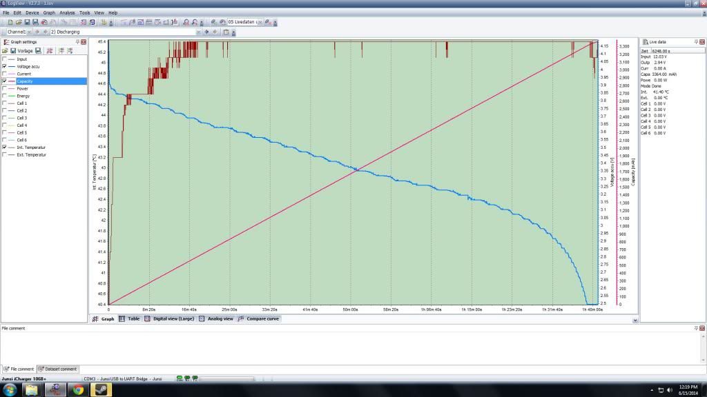

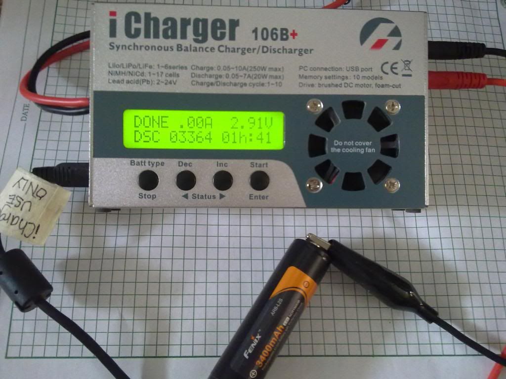

This 3400mAh cell discharged an excellent 3364mAh @2A discharge rate. I believe the cell inside the label is a Panasonic 3400 NCR-B.
Wow not bad. Can you measure voltage sag under different amperage discharges? It certainly looks good though.

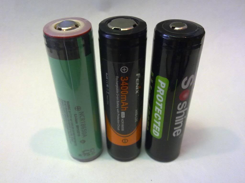

edit—- in the photo, the fenix battery appears to be shorter than the panasonic battery—- so how could that be a panasonic battery inside the fenix ??? p.s. — i already know that i am probably wrong about this.

The protection pcbs used by the protected Panasonic and the protected Fenix shown in the photos are of different kinds/design/dimensions. Assuming both cells are using the NCR unprotected series as base cells, the difference in total length is in the pcb used.

And even though it’s shorter, it does not take into account the protection and raised top of the cell, so the actual ‘insides’ of the panasonic can fit inside this Fenix battery.
