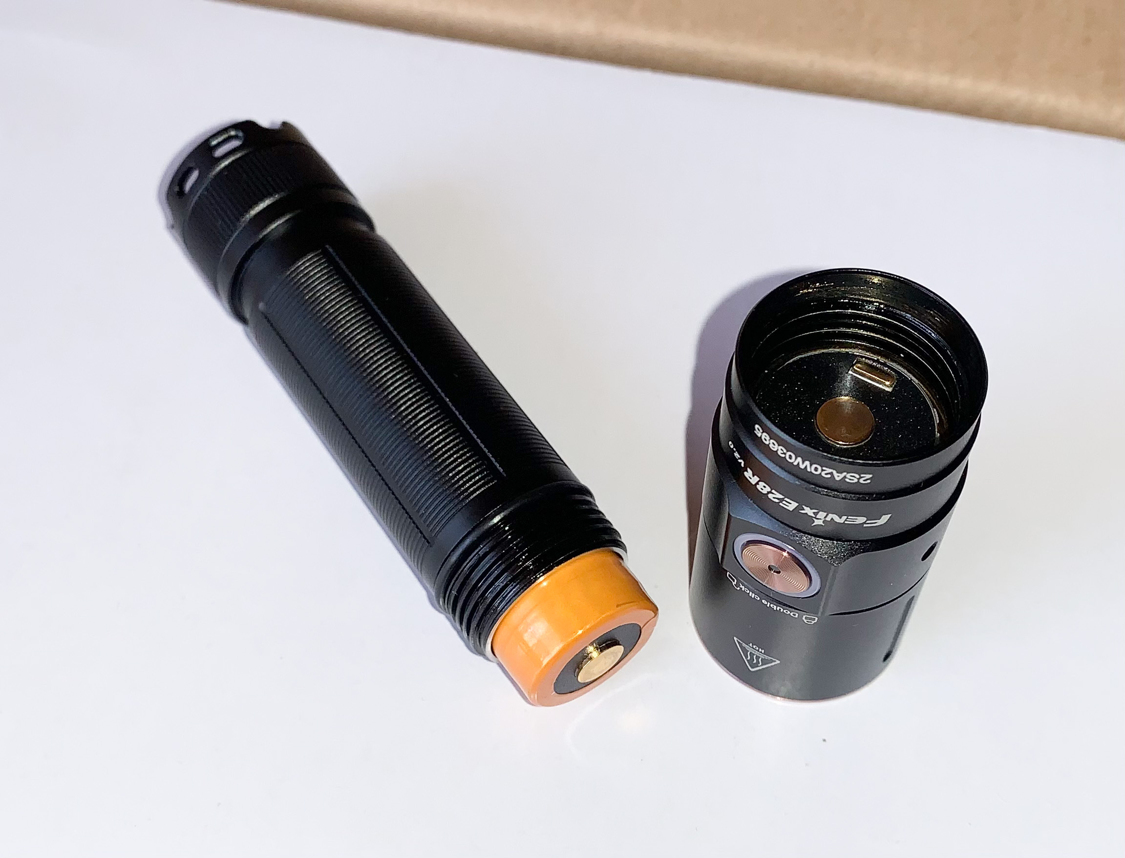

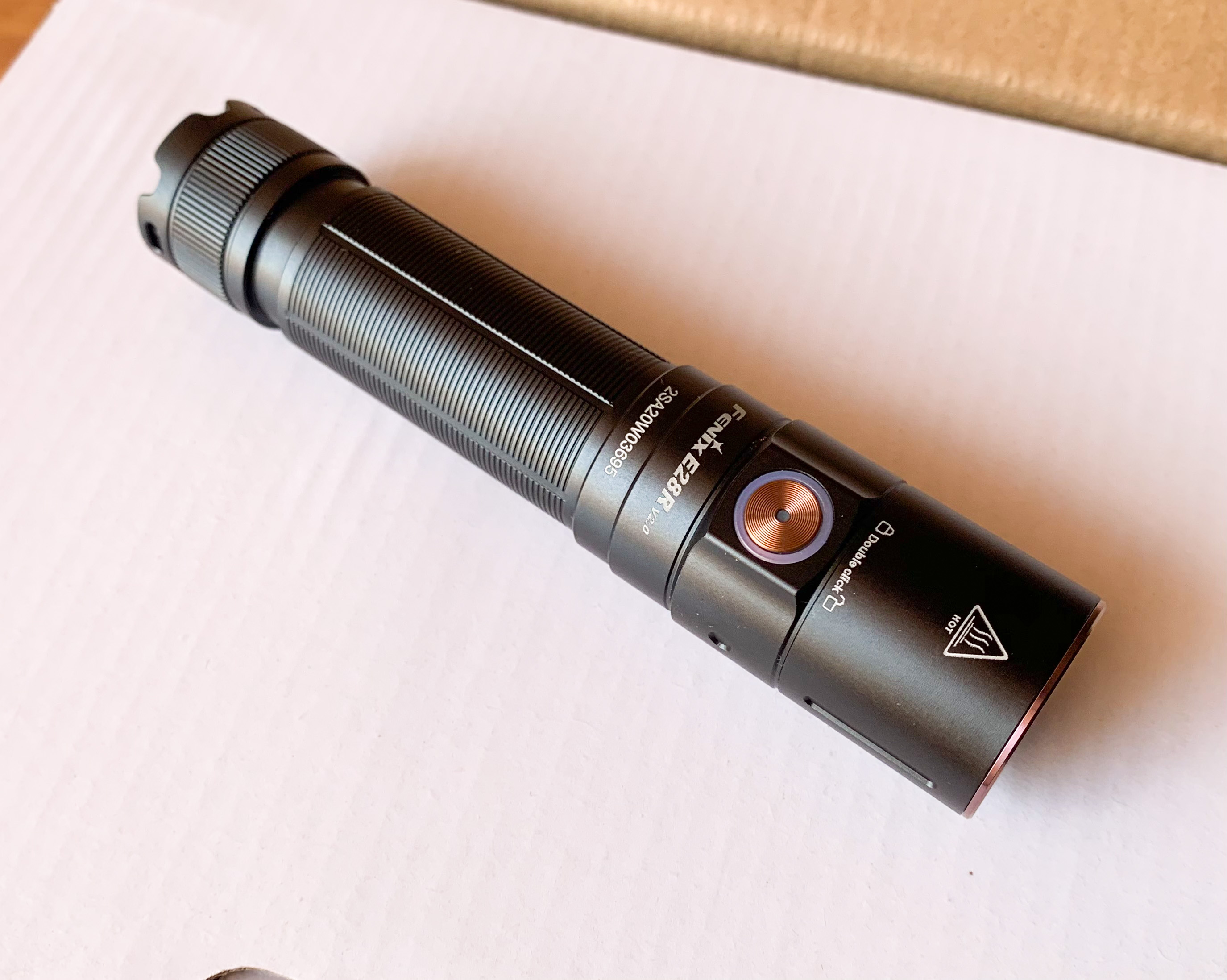

I just received a Fenix E28R V2.0. That light ticks most of the boxes for my EDC needs, except for the throw: I’d prefer to have a SFT40 in there, instead of the SST40.
Unlike many other lights, this one doesn’t have a tailcap per se, it’s the whole body that unscrews from the head.

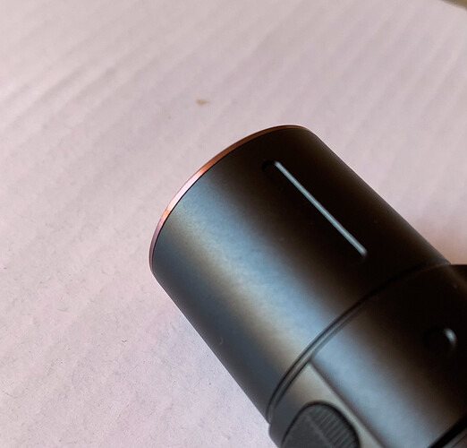

Now, look as much as I can, I don’t see any further separation line on the head, except around the bezel. It’s like everything was fitted in from there.
Does anyone know how to take that apart? Is the bezel just glued in, or is it screwed-and-glued?

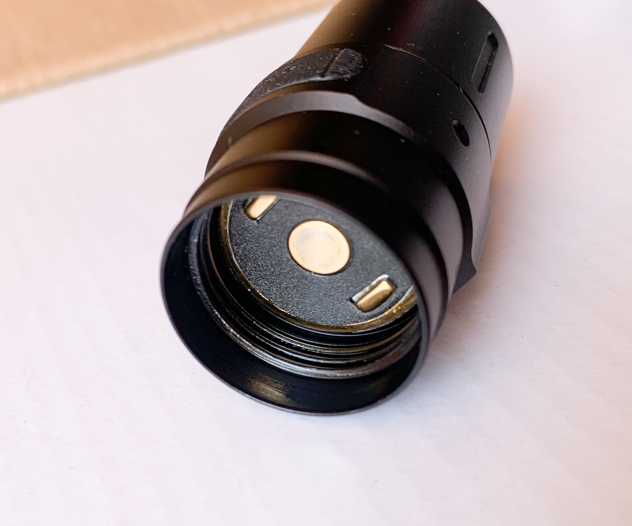

The only alternative would be that the contact plate is screwed in after everything else, and that the plier holes are under the black insulating pad, but this would leave a hole much smaller in diameter than the head…

I checked closely, the bezel is pressed in with an interference fit, there is a very slight bulge in the head’s circumference at that junction.
I have half an idea on how to go about it… Thermal expansion of aluminum is about twice that of stainless steel, if I can get a momentary difference in temp of about 100C between bezel and head, there will be a 0.2mm difference in circumference. I know how to hold the bezel without marring it (nor the head). I’ll give it a try when I have some time on my hands. If it works, I’ll get that SFT, I really need the throw…
