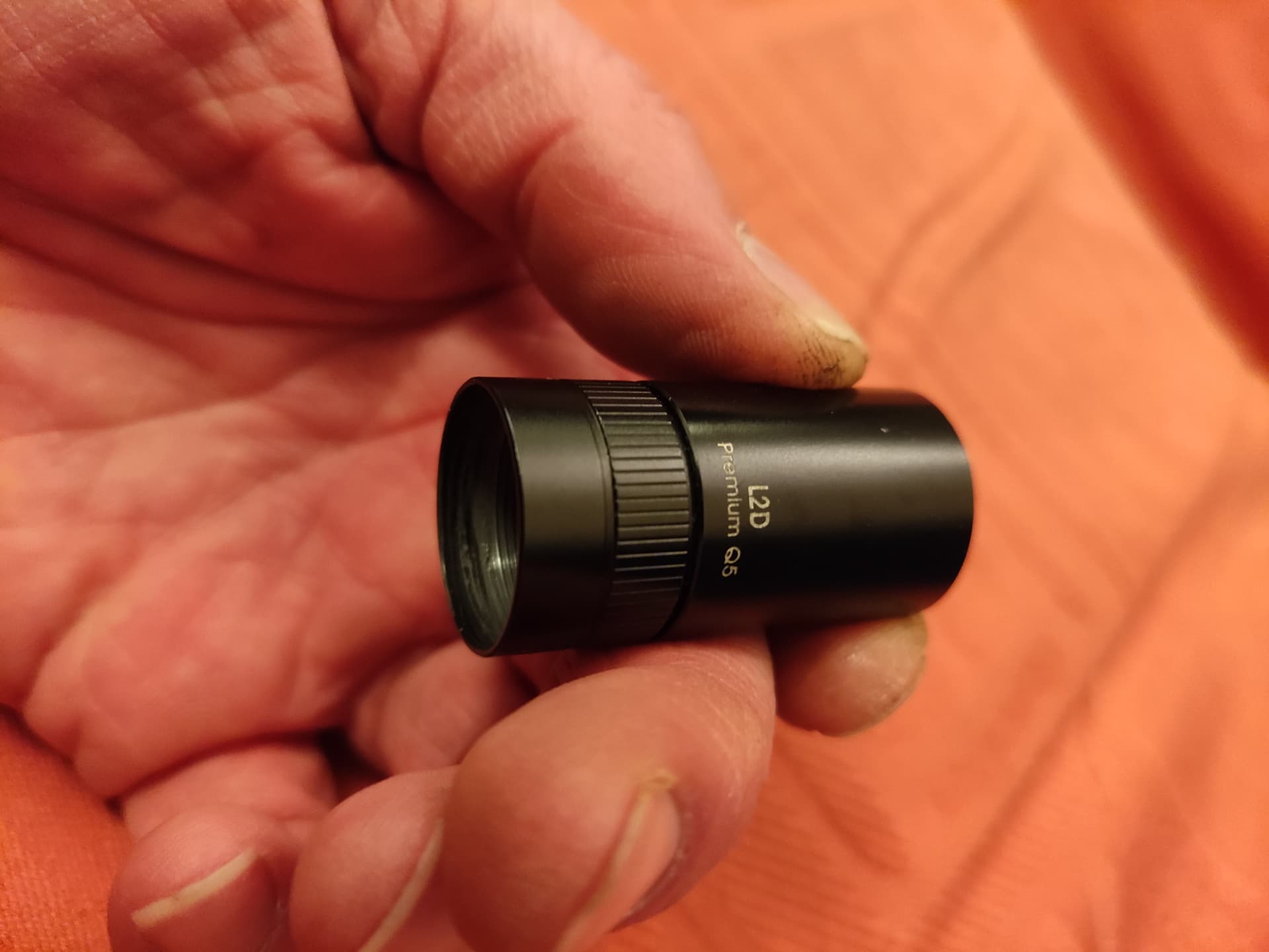

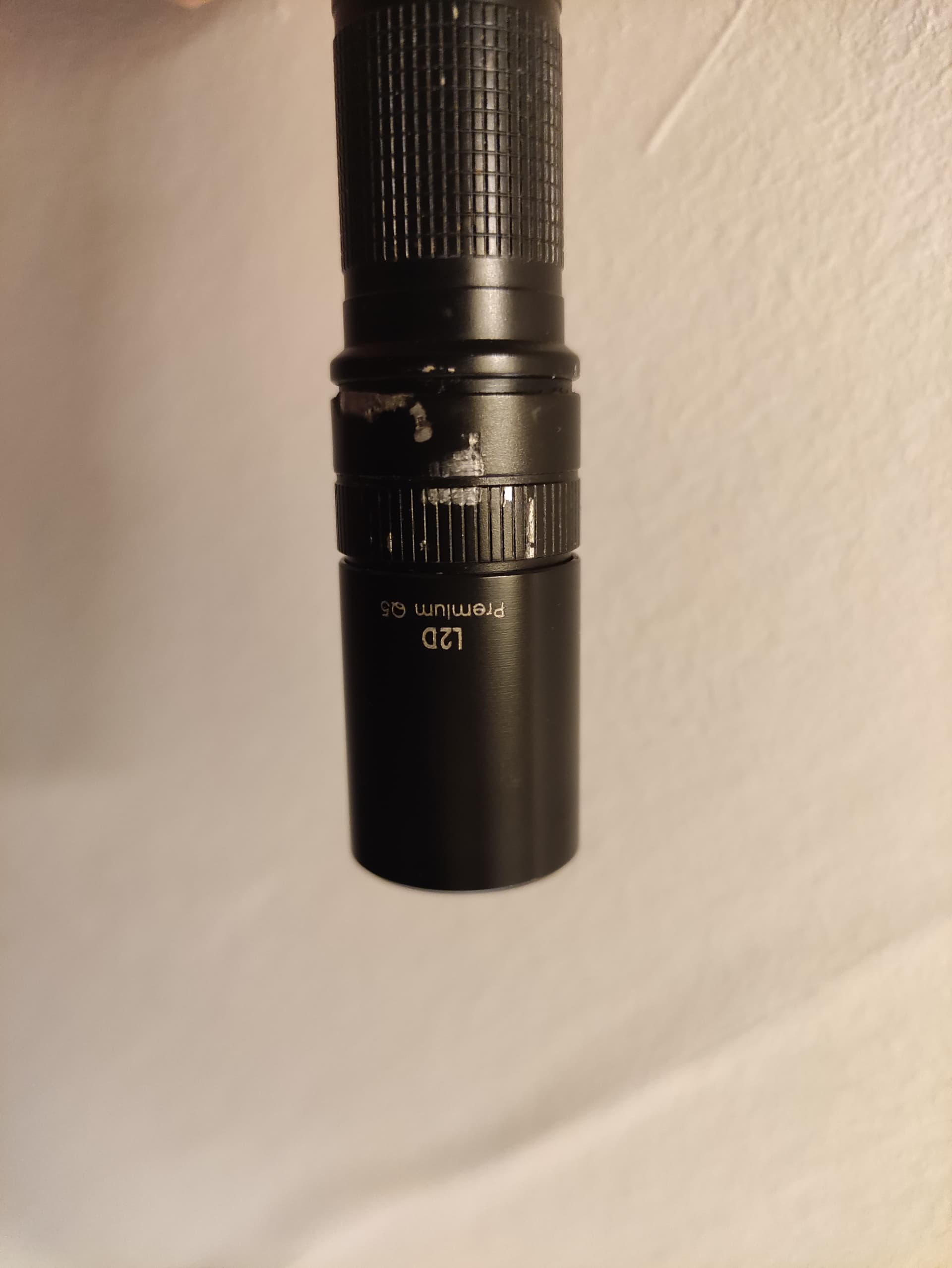

I also have an old L2D that I managed to fry by trying 2 x 14500 li-ions in it. Trying to get the head open, I presume that the part below the laser etched ‘premium Q5’ is separate and unscrews, am I right, and if so is it normal thread direction? Can you advise on the best way to get this open? Is it going to be dunking in boiling water for a bit to soften glue/threadlock? And what tools are best to use? I’m not experienced with modding at all apart from swapping switches/tires around in convoys which hardly counts. If I can get it open I’d be happy with anything I can get to fit in there to make the torch work again. Maybe the parts from a convoy T4 (are the cells in that parallel or series?).
I used strap wrenches for my LD20, didn’t need boiling or anything, just firm pressure until the locktite gave way. I forgot which direction it threaded, think it was normal.
Your assumption about where it unthreads would also be my best guess.
While attempting to unthread the bezel, ensure you have the head screwed onto the flashlight body- it will help prevent deformation of the head of the light.
Regarding a new driver, I’m not sure the T4 driver will physically fit, photos on Simon’s website it looks quite tall, and I’ve no idea the diameter of the original Fenix driver. The T4 driver has a wide voltage input range to accept 2x AA or 14500 cells.
Given you fried a driver with 2x14500 cells, I feel it important to say now that unprotected lithium cells in series are a tad risky. To minimise the risk, they should be “married” and always charge them together to the same voltage before putting them in the light.
Thank you for your answer, including all of the advice on what drivers might be compatible, it’s very helpful, plus the safety info about the batteries. It was really pretty stupid not to have checked if it could take li-ions before slamming them in there.
Unfortunately I’ve made a bit of a pig’s ear of opening the head, used an axle clamp in a vice which worked fine to hold one half but strap wrench on the other kept slipping. Eventually I lost patience and used a sheffield footprint wrench with some rubber wrapping. Got a lot of force but no joy and managed to gouge the coating too. It’s quite impressive that the head still unscrews off the body smoothly after the force I used, no deformation has taken place
I’ll give it a rest and come back to it again for another go when I get or make a more suitable tool.
I’m just wondering if the head splits on a reverse thread on this model, I put a hell of a lot of force through it.

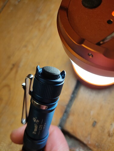

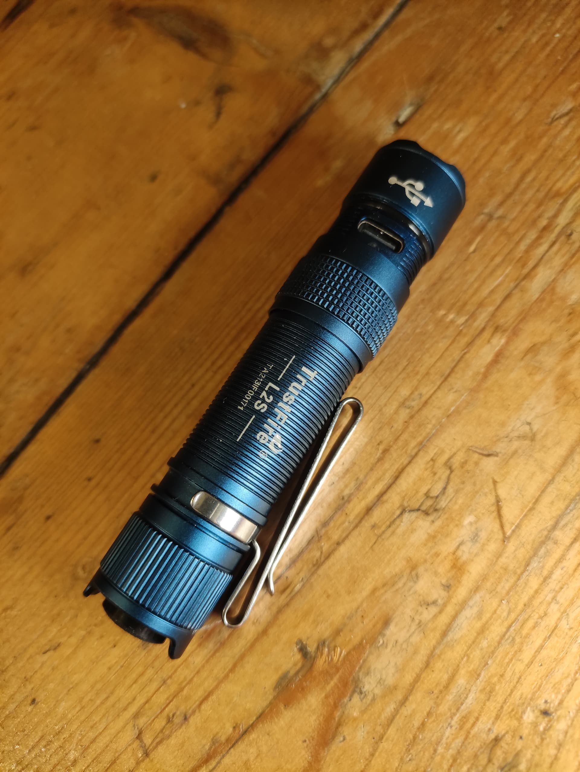

In the meantime there is a slight upside, I have re-purposed the very nice rubber button from the L2D to use in the tailswitch of this Trustfire L2S. It’s a cheap light but with an interesting USB port covered by a threaded collar. It also is extremely well regulated. The button that it came with was really awful, but this improvement has turned it into a light that I actually like a lot.
If I get the L2D going again I’ll swap it back.
