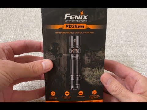

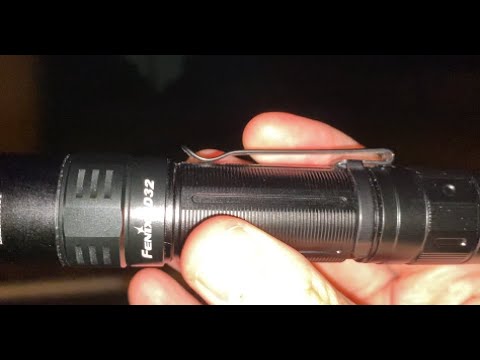

Which do you think would be a better EDC, the Fenix PD32 V2 or PD35 V3? Open to other 18650 light also. Just want quality components and reliability. Have a Warrior Mini 2 now but I am not impressed with the throw.
I have both, and the PD32 V2 is definitely the better light.
Mainly because the LED and beam profile is so much better. The PD35 V3 I have uses an SFT-40 with very green tint. On all but the highest two modes it’s very unpleasant to use. It’s also a little cooler than the PD32 V2 on turbo, at ~6500k. The spill is also very wide, with the hotspot being pretty spotty and only slightly larger than the PD32 V2 hotspot, so while it has ~500 more lumens than the PD32 V2, they’re spread out over such a larger area that visually, it’s no brighter than the PD32 V2 in actual use, and it’s just too wide for my taste. It also makes the hotspot and spill brightness ratio a little unbalanced, so on lower modes, the spill is too dim to use for walking, and in order to make it bright enough, the hotspot then becomes too intense. It’s still useable and some might like it, but it’s not ideal as an EDC IMO, maybe more as a tac light.
The PD32 V2 has a fantastic LED and beam. The balance between hotspot and spill is great - the spill is still plenty wide and visually brighter, and the hotspot is big enough with a bright corona. It’s great to use. The tint is also fantastic. ~5500k on low, no noticeable/bothersome greenishness, and very clean and neutral on turbo. Being a little warmer at ~6000k on turbo is also nice.
The PD32 V2 is also a bit smaller, and having no side switch makes for a smooth body that’s very ergonomic to use. I love the UI on it. Uses a unique two stage e-switch that mimics a forward-clicky mechanical switch from off with mode memory, and a reverse-clicky switch while on. So from off you get momentary with a long travel until you hit the second stage for constant on so you won’t accidentally full-press, and from on, a quick tap switches modes. It’s a lovely UI to use, very easy and intuitive, and useable without switching hand positions.
The PD32 V2 does only have 3 modes, so not everyone prefers it, but I find each mode perfectly spaced, and it makes it super fast to get to the level you want, or to leave it where you want (I leave mine in turbo). I can activate it and set the brightness I want while it’s in my pocket, then pull it out to use.
And of course, the PD32 V2 throws further. It’s super impressive, one of the top highest throw lights you can get with a ~25mm bezel, at 395m.
Only reason you would get the PD35 V3 is you REALLY need the 5 lumen low mode. I find the 30 lumen low on the PD32 V2 perfect for my use, but if you’re doing super close up stuff all the time, or got a ton of use out of the firefly mode on the warrior mini, maybe you’d want a lower mode.
The PD32 V2 is one of my all-time favorite lights. I think you’ll really like it especially if you want throw.
