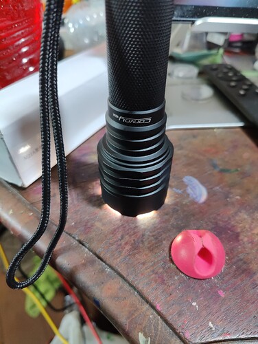

Finished my first build of C8 M21A
I finished my first build of C8 M21A with 20mm 3v 8amp buck driver 12 group with SFT40 Convoy LED. I also installed a metal button with green LED.
If it doesn’t look very bright it’s because I had an 18650 battery in it instead of the 21700 battery. Once I put it in the light lit up just fine.
My hands shake so the soldering was not great but it will hold. I think I’m going to get a rechargeable soldering pen to do the next build.

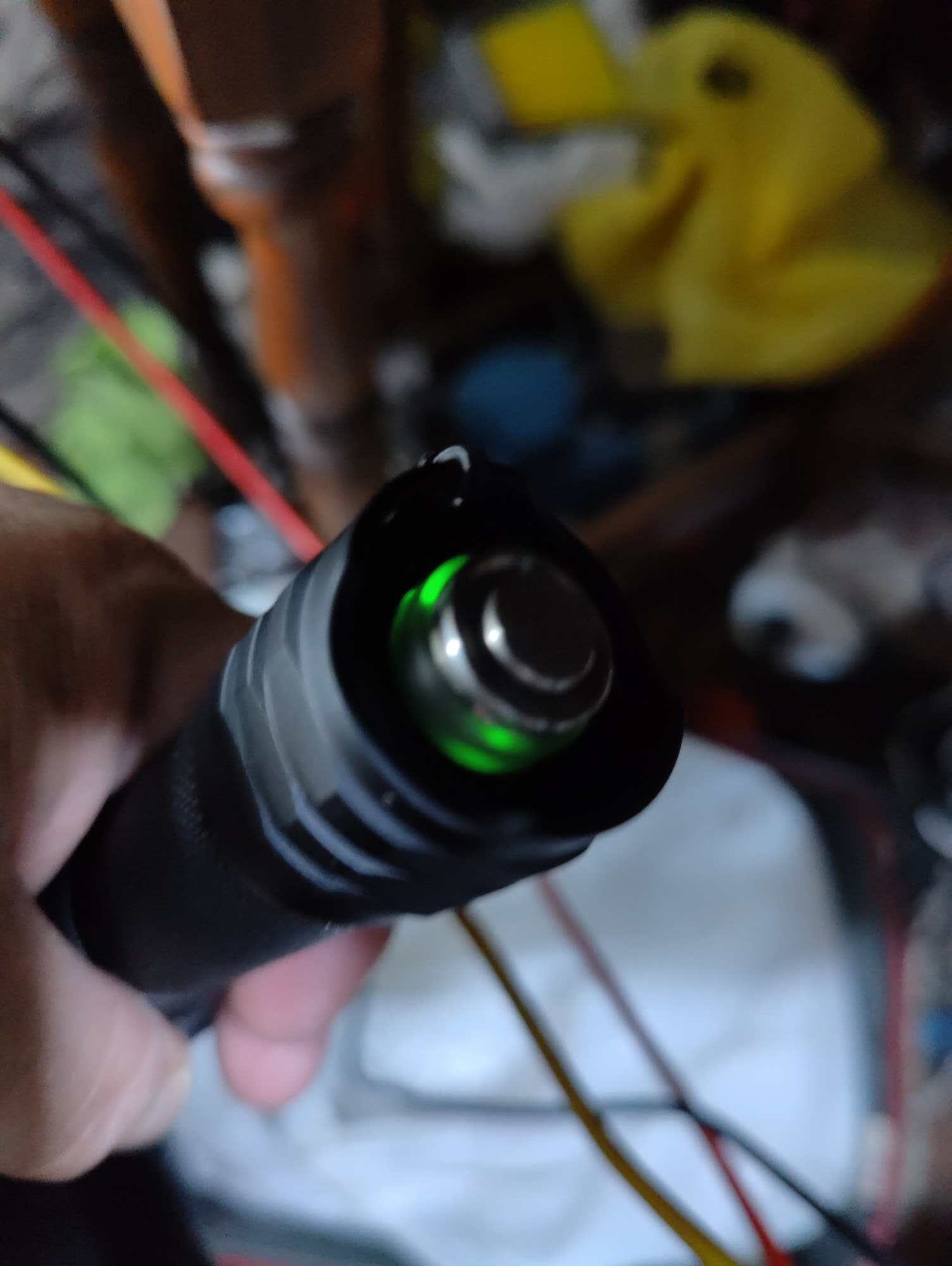

I will take some pictures tonight but one thing that concerns me is that the LED on the button doesn’t shut off. So I may switch back to the original button. Any info on the LED light would be helpful.

To turn off the illuminated tail switch you can loosen the tail cap just a little and it will disconnect power.

The size of the battery shouldn’t matter for the brightness. Any 18650 battery that can deliver 8 amps would be good.
And a green lighted switch should last a long long time, like years. Of all the colors, the green switches are the most efficient by far. If you have a multimeter, you can measure the current. My green ones, which I swap out the resistors to make less bright, measure around 0.08mA. That’s over 7 years on a 21700 5000mAh battery!
Thanks neutralfan. I went back yesterday and read the description of the lighted switch and saw that too.
