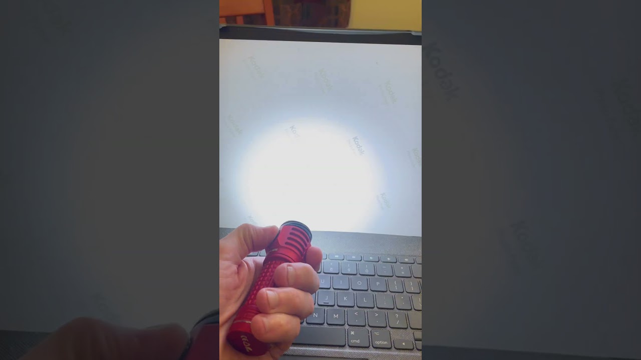

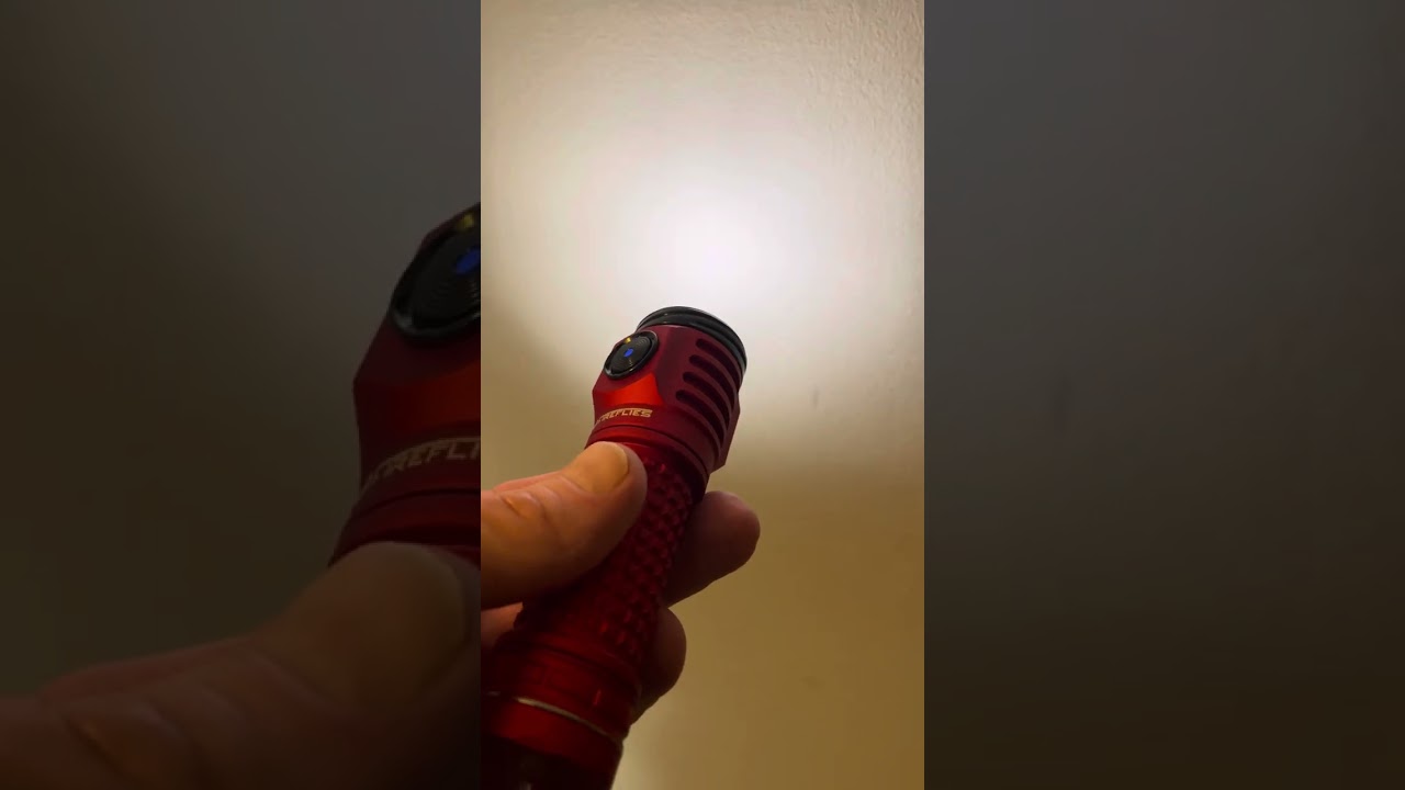

But it has an annoying flicker at low output, it’s not unlike PWM. And it also suffers the same problem as my Astrolux FT03 Pro as in the ramping is really jittery from on at low then up. The NOV-MU also gets to high (not turbo) and then immediately drops back down a bit. These are immediate impressions within 5 minutes of popping the battery in, I can see the light being returned just for that flicker.
I’ve put a couple of videos together, I think I caught the flickering when on constant low bestin the first video, and the jumpy ramping better in the second. No idea how to mute a video.
Nuther flicker vid, anybody else have this with a Fireflies?
