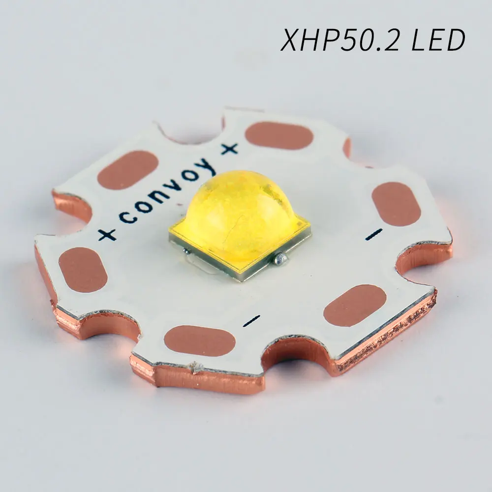

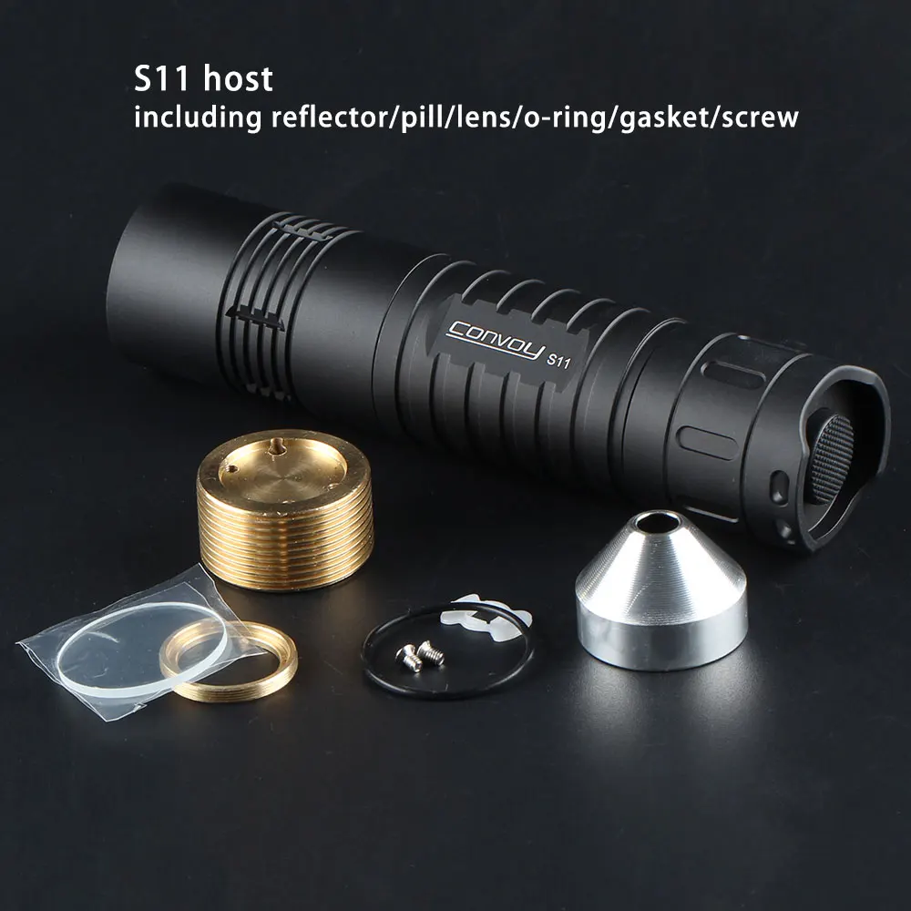

I am completely new to the whole DIY/modding experience of flashlights, and I would like to try it out for myself! I have looked at these links as a potential build, but am not sure what to do in terms of the driver? I would really like to stick with the same host (Convoy S11) and led (xhp50.2) if possible, but am open to other led and driver combinations.
