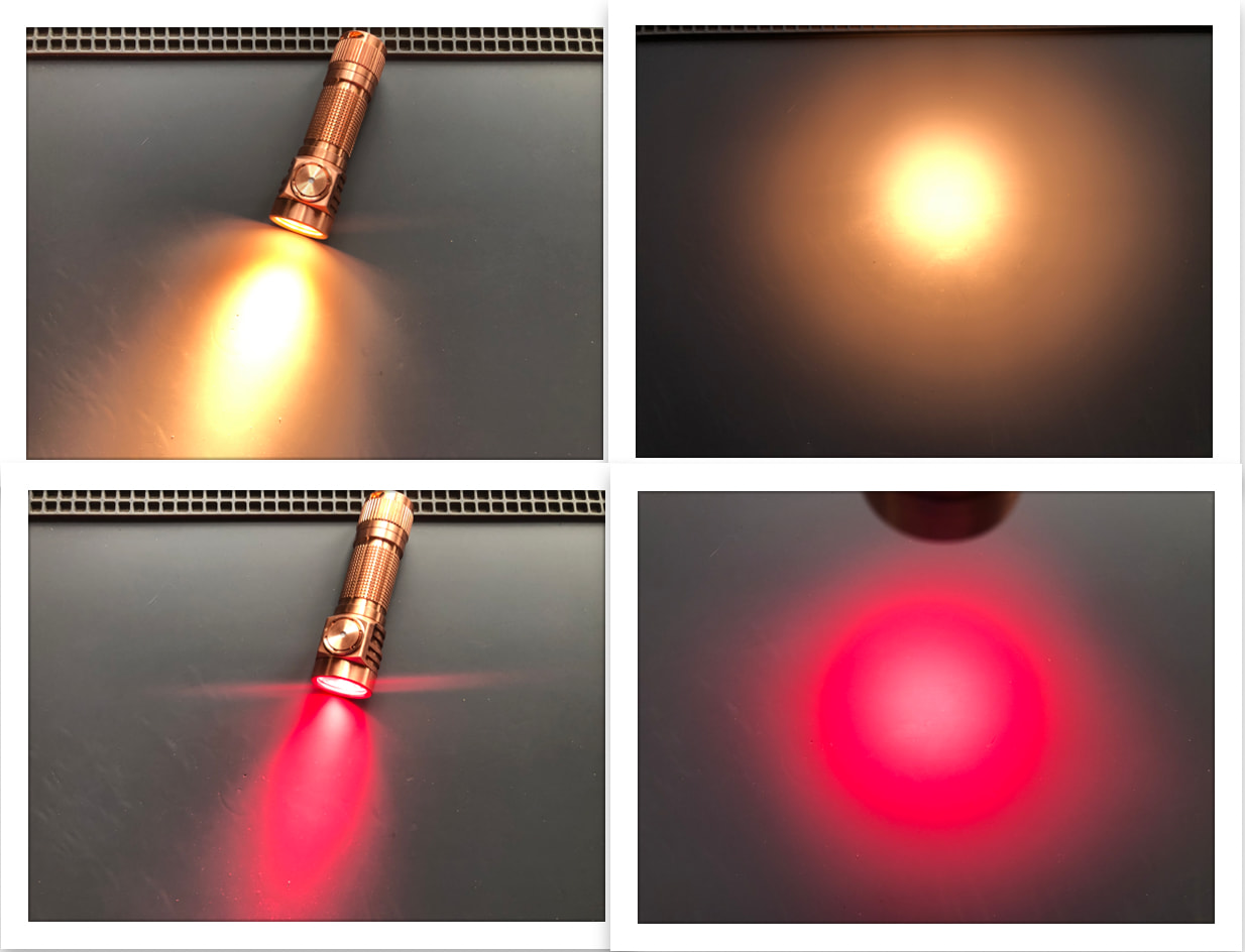

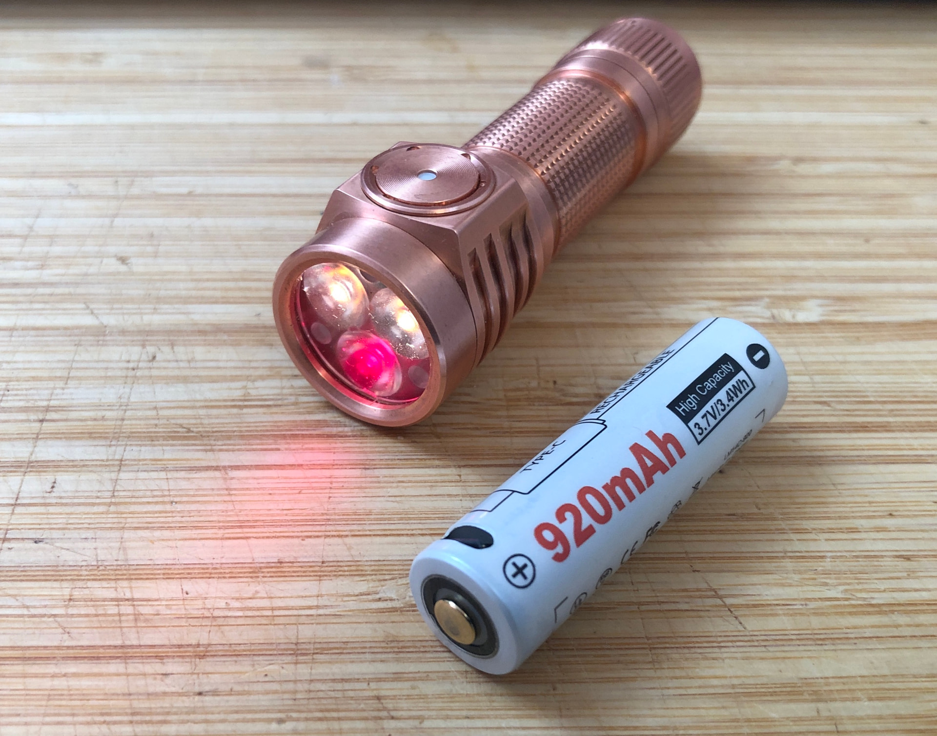

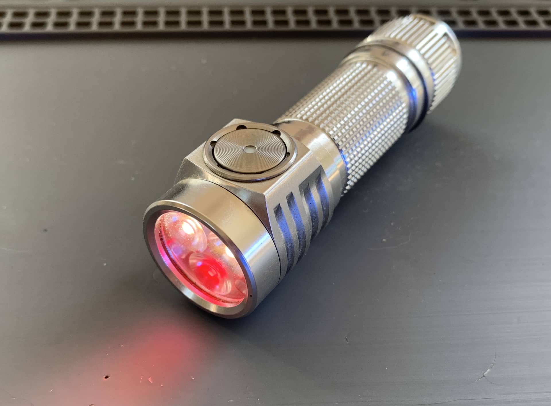

Just received my new Dual Channel Copper Emisar D3AA with 2x NTG35 2700K and 1x 660nm Red.. It is very nice!
Here are a few pics and observations..

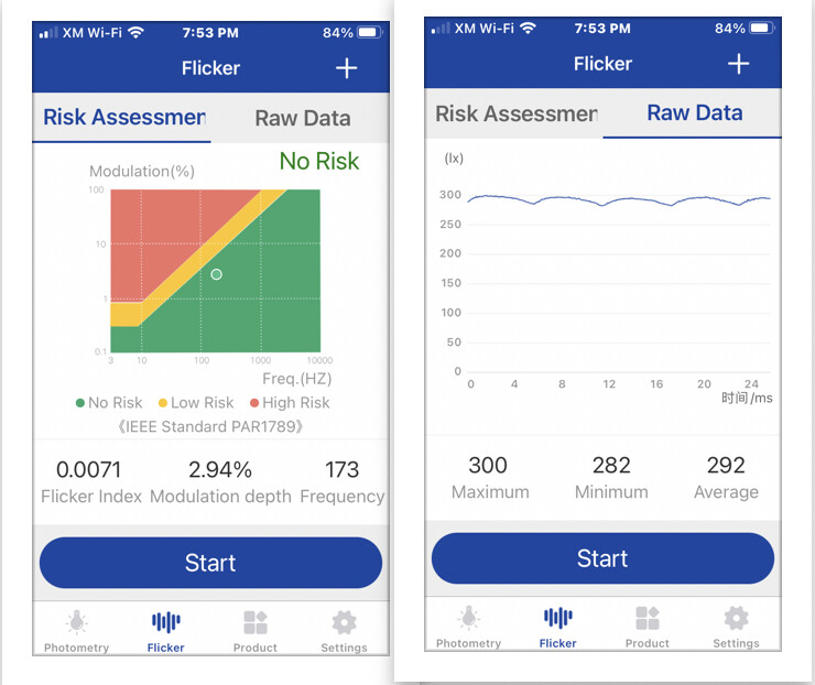

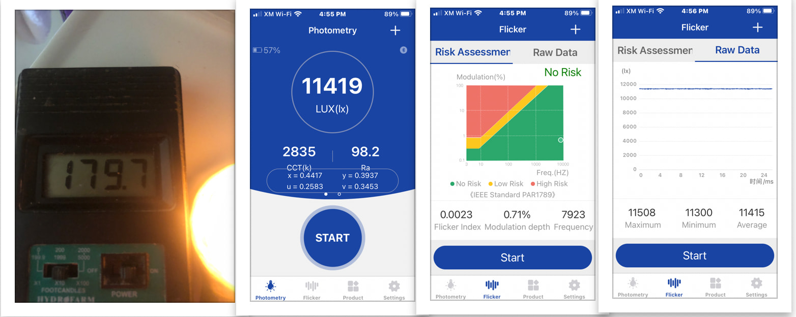

this is Opple 3 Flicker Index test on step 5 of 70 = 180 lm:

There is NoPWM at any output.. and the Flicker Index and Lux Riple are extremely low. Im very happy with these features of the Linear Driver.
There is a slight preflash of white, when the light is turned on at low output in channel 5, but not in channel 1 or 2. The preflash on channel 5 is eliminated by disabling Smooth Steps.
The magnet can barely hold the light sideways.. but that does not surprise me, considering the weight of Copper.
btw, the Red LED produces a Square beam.. Im not too bothered by it, I dont expect perfection from the shared Optic.. still really happy with this light :wink:

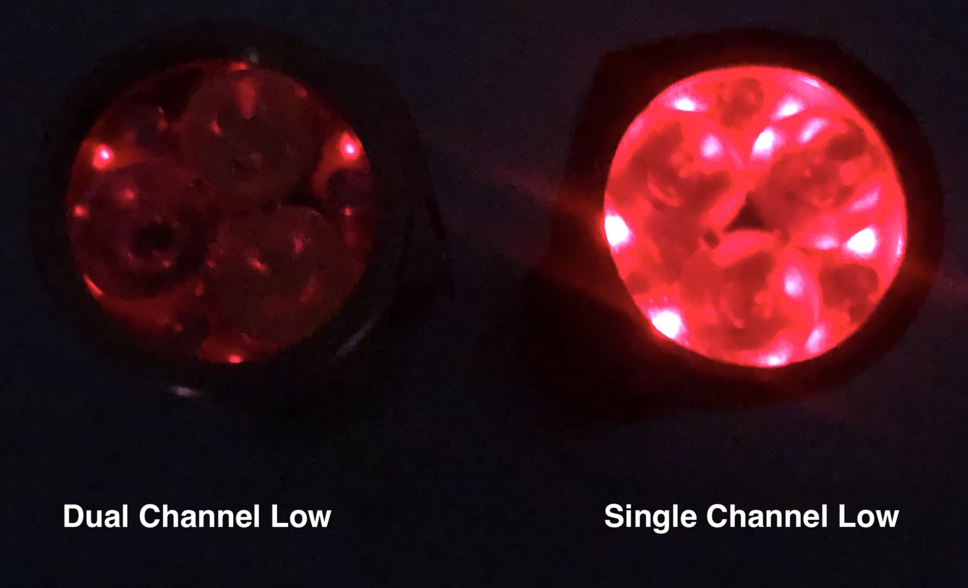

Im entertained by the RGB LEDs, including in the button, when Aux are on High Brightness.. I can barely see the Low Brightness Aux, they are Much Dimmer than on my single channel D3AA. Invisible during the day, but sufficient on the nightstand in the dark.

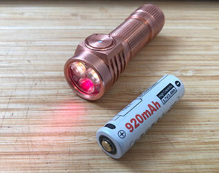

The metal button cover looks and feels nice. Im happily surprised to learn the light Does have Physical Lockout at the tailcap.
Firmware is 0135-2023-10-31

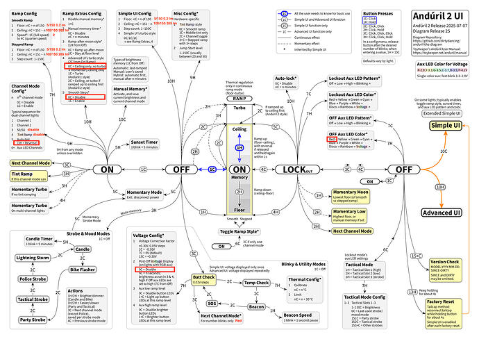

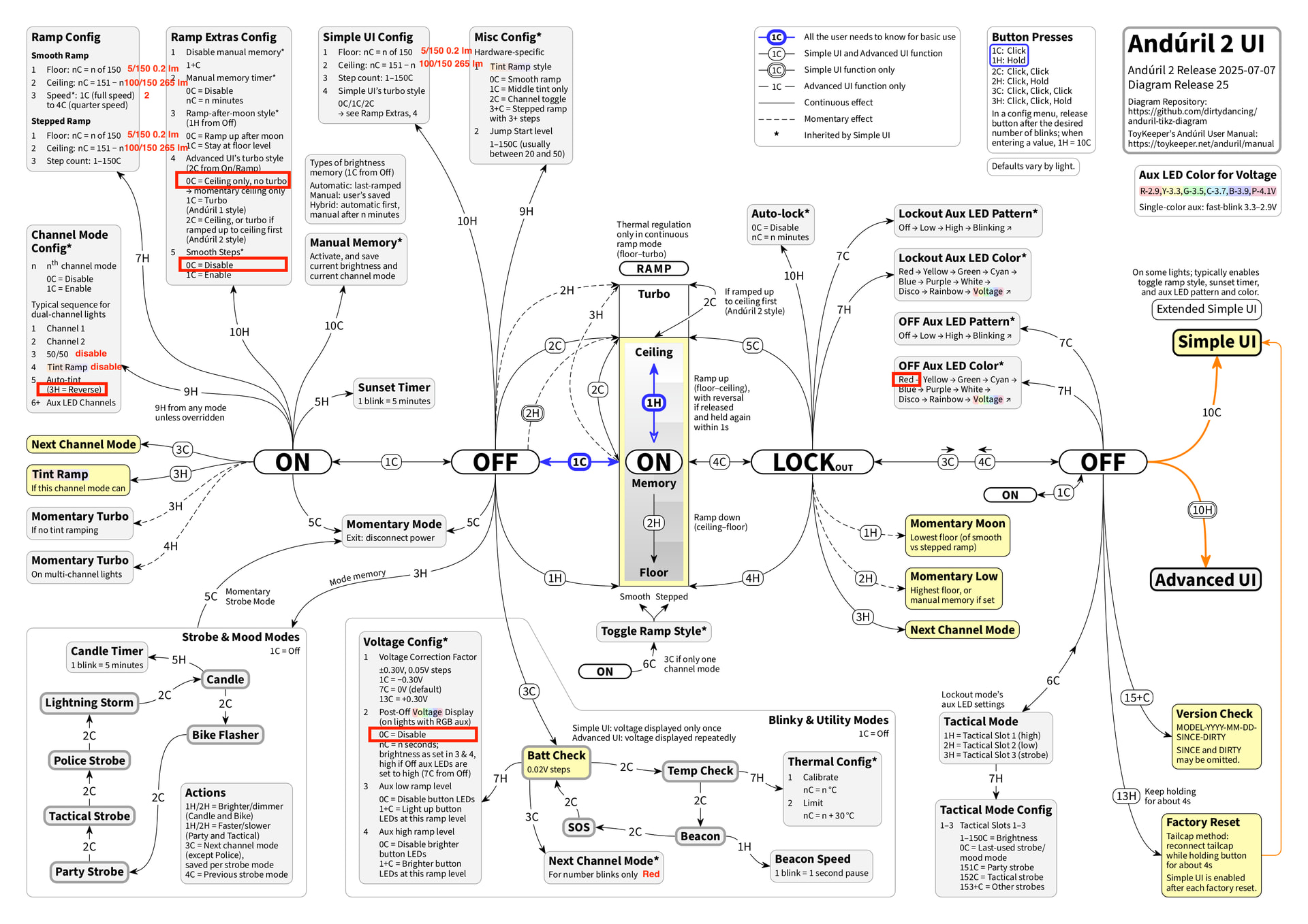

changes Im making to defaults after Factory Reset
  1. go back to Advanced
  2. set batt check blinks to use Red Aux
  3. change Aux to Red
  4. disable Turbo
  5. disable channel 3 and 4
  6. disable POVD
  7. disable smooth steps to get rid of the preflash on the mixing channels
  8. change channel 5 (auto channel mixing) to lead with Red from Low and add white as output increases
  9. Lowered Ceiling to 100/150 = 265 lm in channel 1, white LEDs.
    1. Lowered floors to 5/150 which gives 0.2 lm White, and 0.02 lm Red. The Flicker Index reports No Risk:
my Options:
9 Thanks

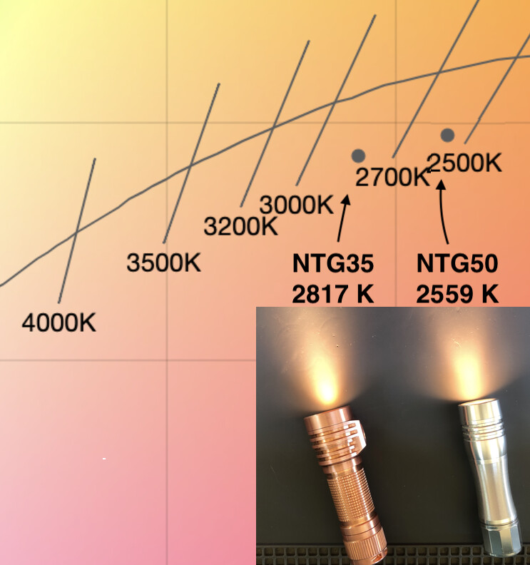

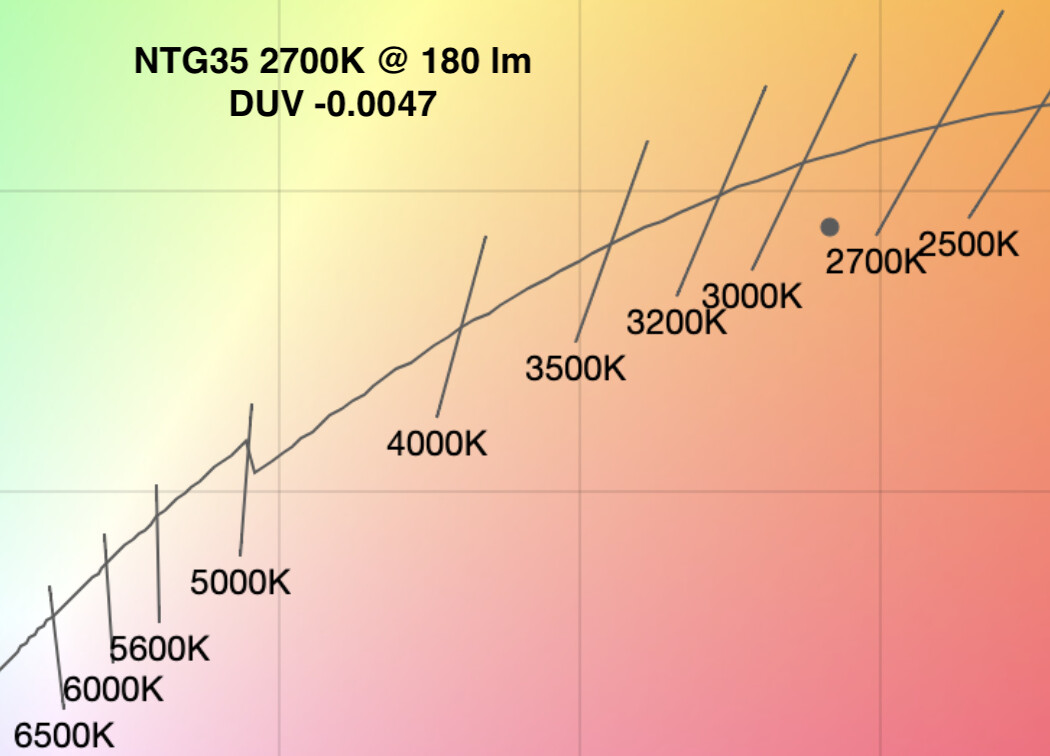

compare 2700K NTG35 and NTG50:

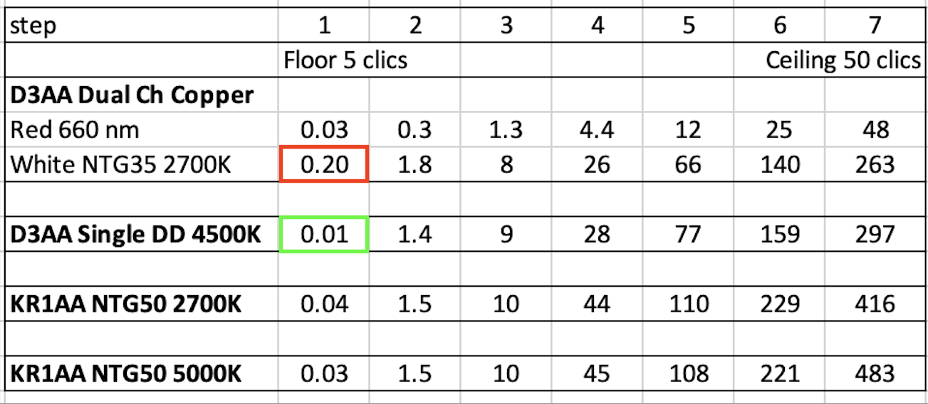

Some Output Data, comparing Dual Channel D3AA to Single Channel D3AA and two KR1AA w different LEDs:
(all on LiIon w same floor and ceiling)
Notice ramp tables are not the same on KR1AA and D3AA drivers:
eg. KR1AA 2700K ceiling output is 40% higher than D3AA DD 4500K ceiling output.
(in addition to effect of LED difference on outputs)

This Copper one has been my nightstand light since it arrived 3 months ago. In the middle of the night I only use the Red channel:
This lighter brother still lives in my pocket :wink:
At dusk and dawn, I use the blended channel much more than expected.

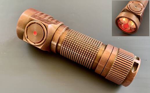

The raw metal Copper light, lives on my nightstand, so it has remained in perfect condition. The color of the copper has changed to be less shiny from natural oxidation.
I carry the Clear Anodized Aluminum daily and it has remained in excellent condition. I keep it in a pocket by itself, not mixed with keys nor coins.
I like the flat metal switches very much. They do not rattle, and the silver light does not turn on accidentally in my pocket.
I am very happy with the runtimes. My uses are indoors and mostly at around 20 lumens or less. I get very long runtime from a 14500 battery because I use the lights for short periods of time.
Here is what both lights look like today:
The output on red is about 7X lower, without making any manual change to the output. The red LEDs just naturally have lower output than the white LEDs.
