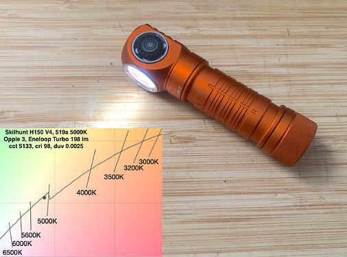

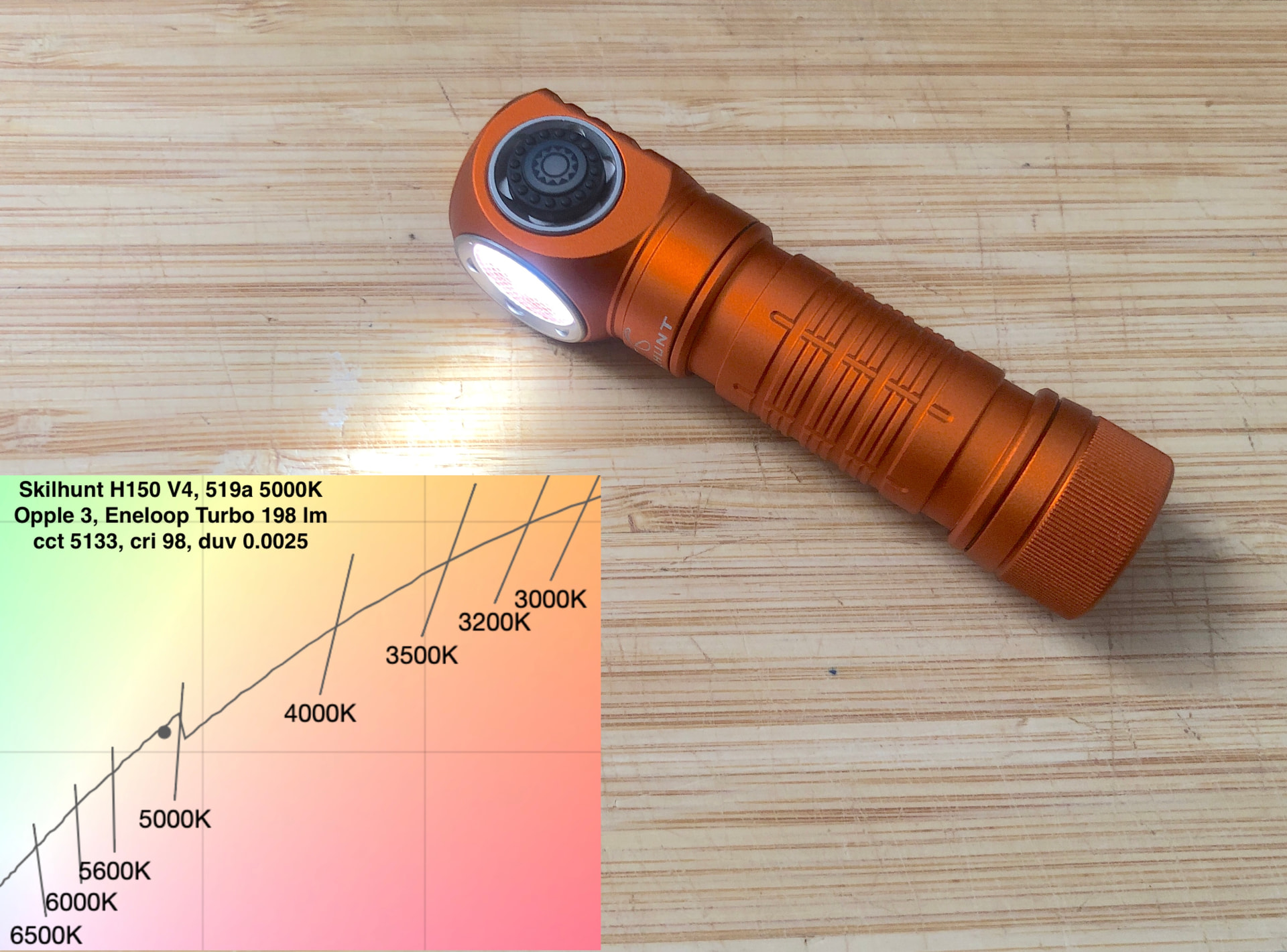

First Impressions Skilhunt H150 V4 with 519a 5000K LED.
Received this Skilhunt H150 V4 with the new Buck Boost Driver that promises to be more efficient, with more constant output, cooler running, and with higher maximum output than the previous version.
The 5000K color temperature and neutral tint are excellent for a task light. The beam has nice even diffusion thanks to the Beaded Tir Optic, which I find very useful for close work. I really like how small and lightweight the H150 is.
