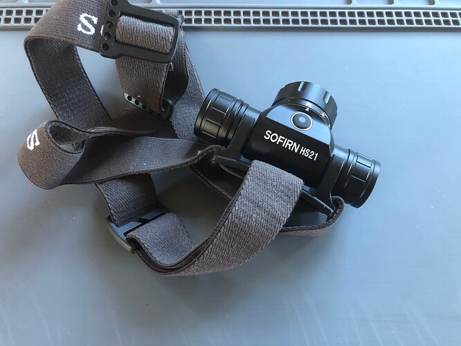

This is a very nice headlamp. It fits well and is very comfortable.

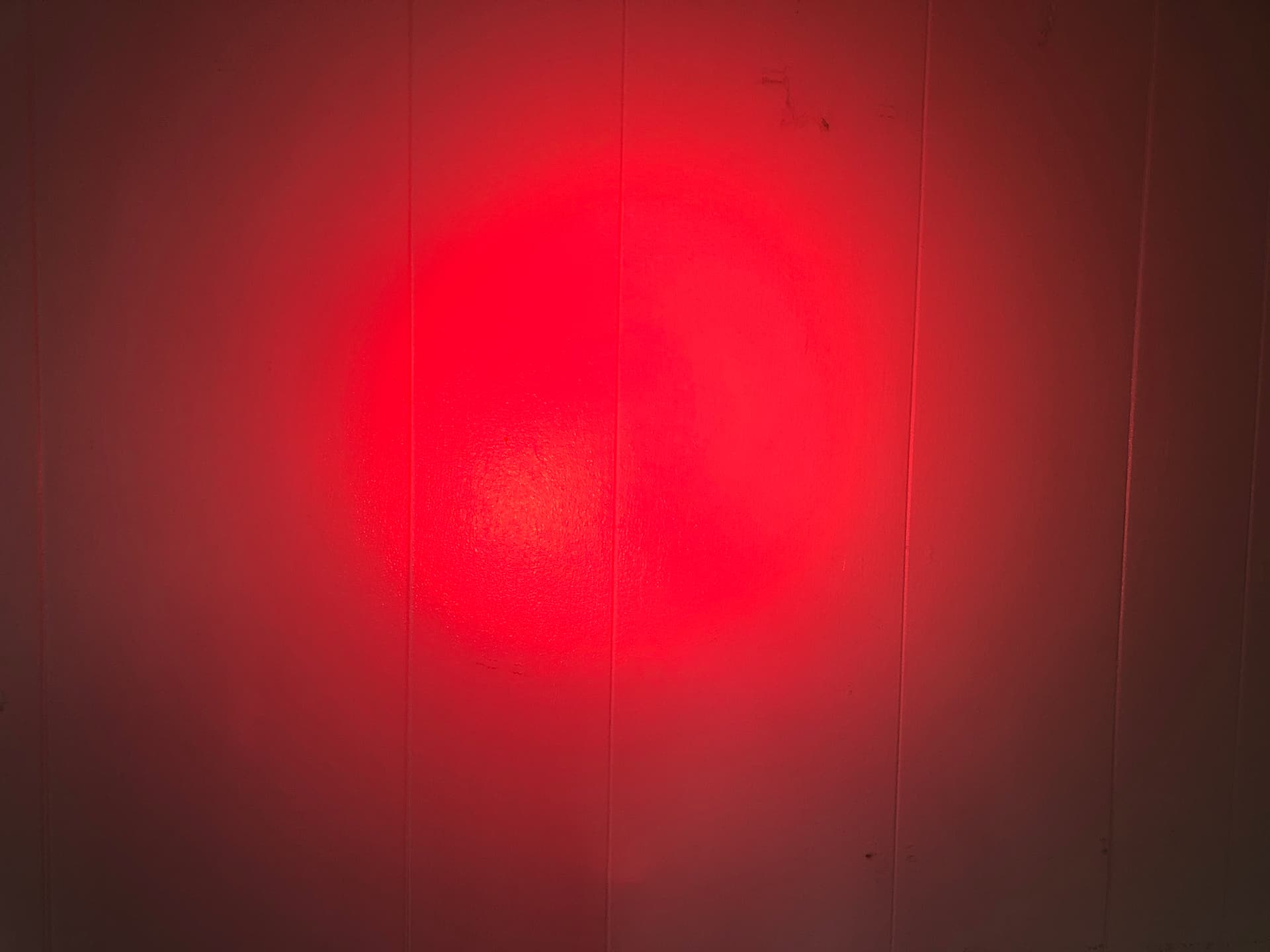

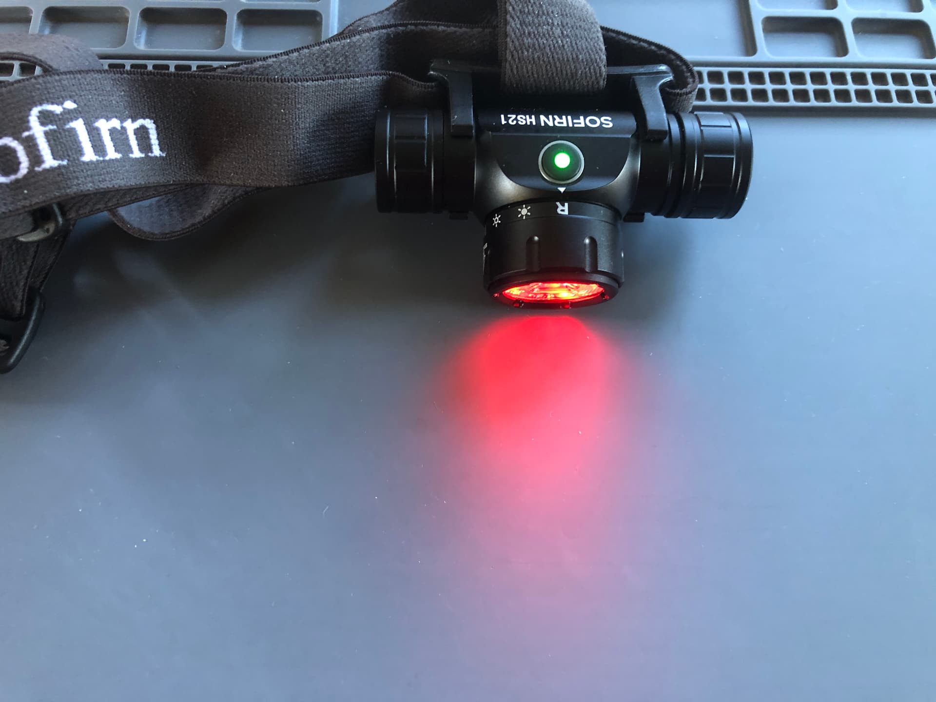

Red Flood:

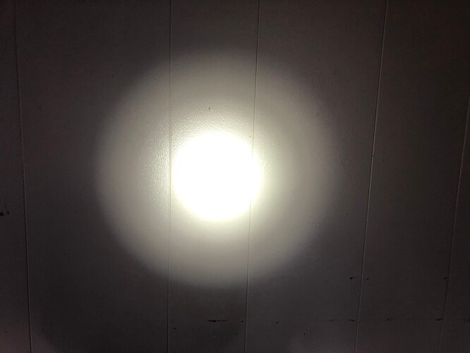

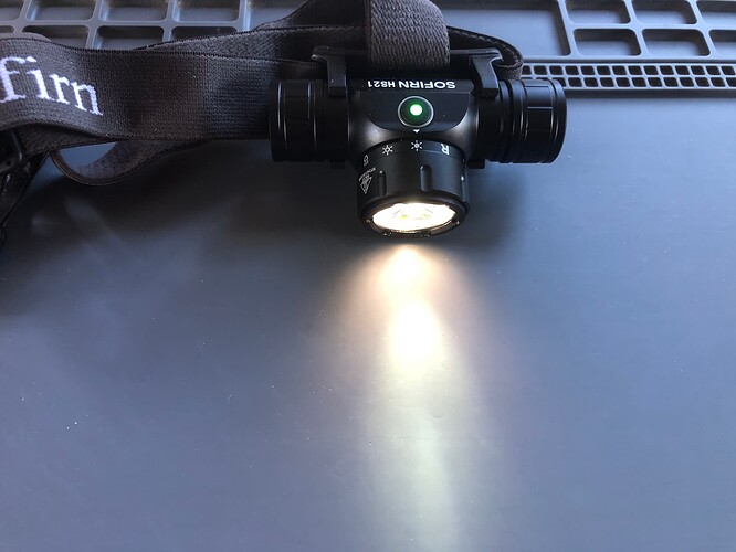

White Flood combined with White Throw:

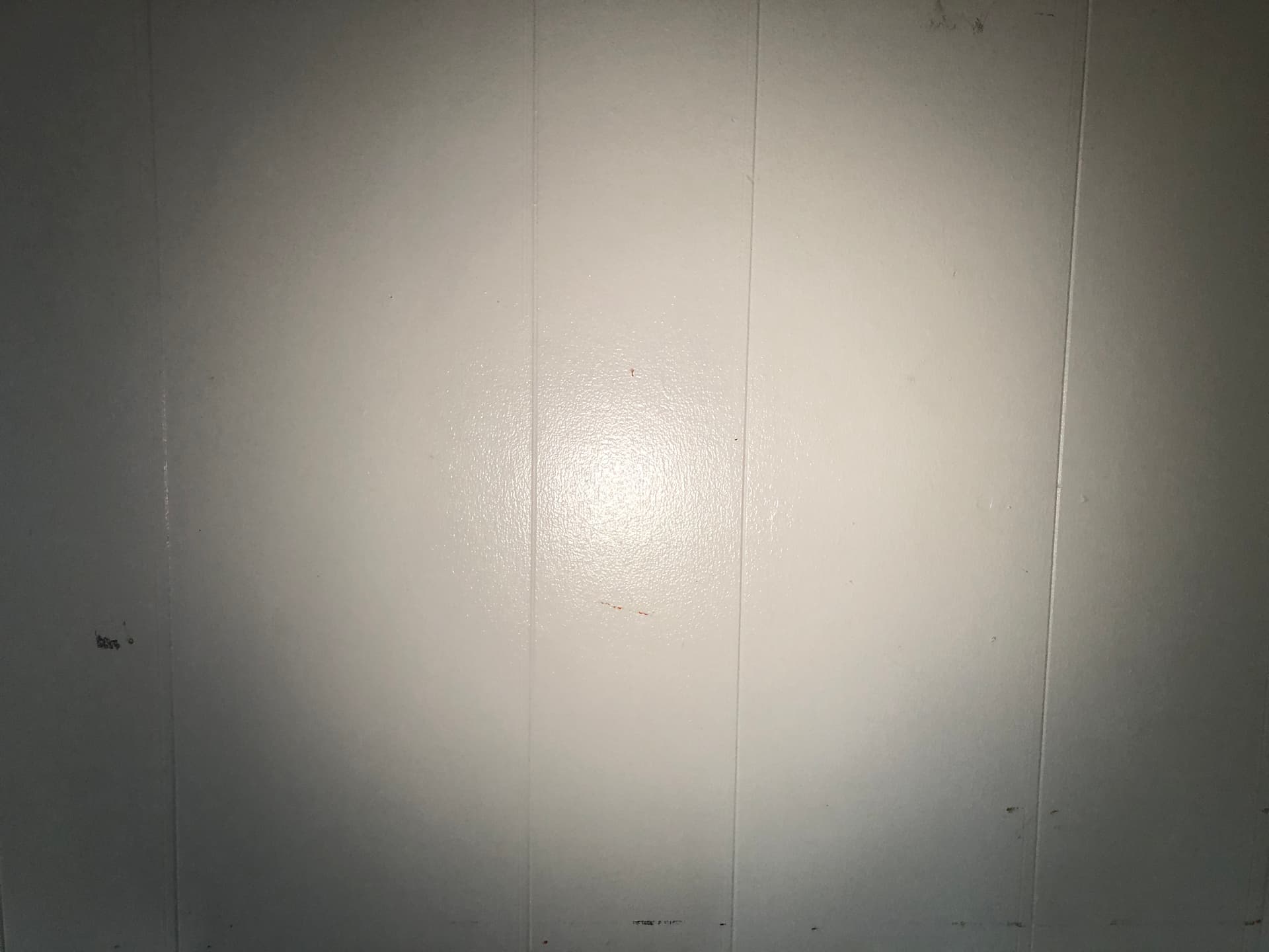

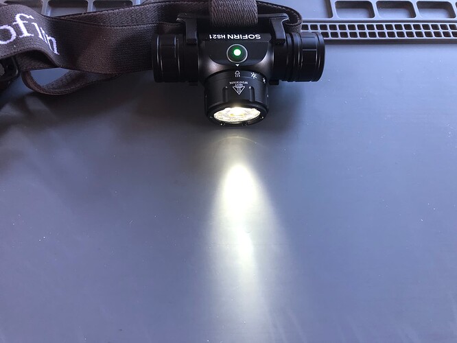

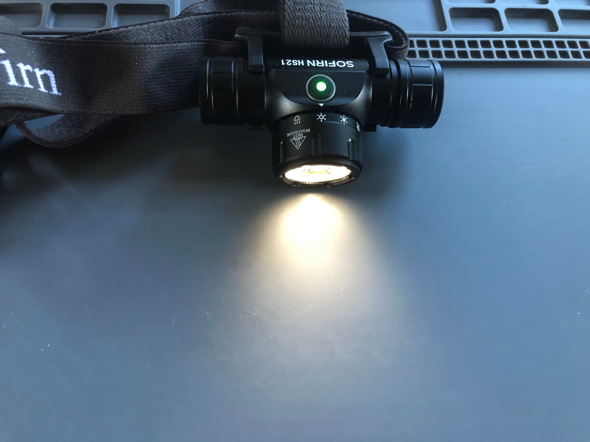

White Flood:

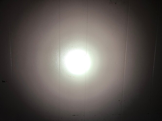

and White Throw beam:

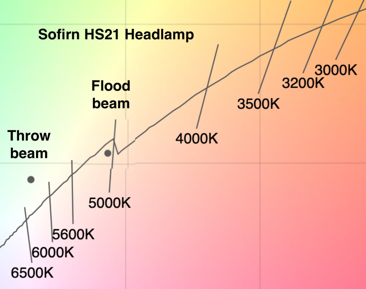

Opple 3 data at the lowest output level for each mode
Flood and Throw beams:

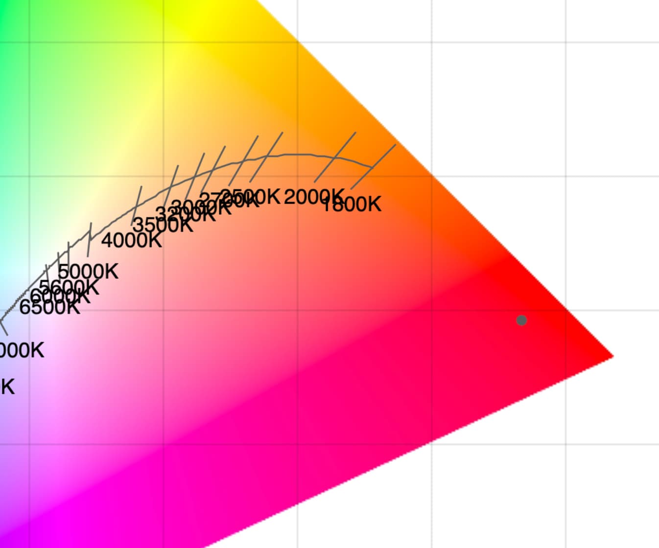

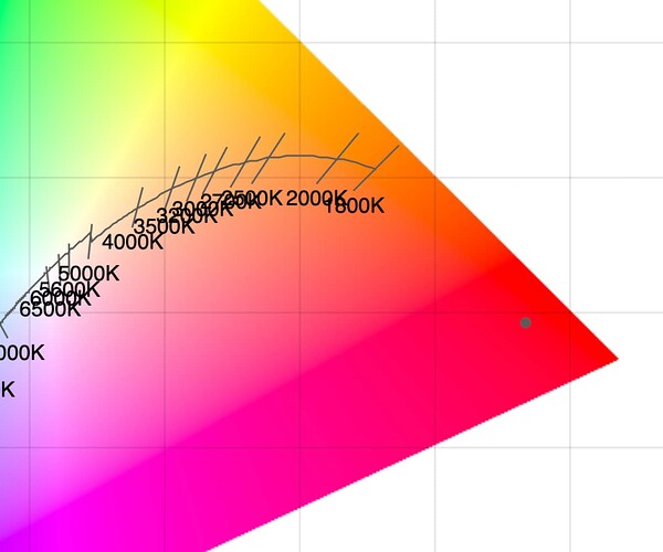

Red Beam:
There are Four positions on the Rotary Bezel, which selects the following LEDs:
  1. The Red LEDs are 620 nanometer, with a floody low mode of 0.2 lumens that seems suitably low for dark adapted situations. The beam is wide and floody with even diffusion and no artifacts.
  1. The White Throw LED combined with the Floody LEDs produce a combined beam of about 5900K CCT, w CRI 76 and Tint DUV of 0.0063. The low mode of 1.8 lumens is suitable for illuminating the ground near our feet, or something in our hands or on a table.
  1. The White Flood LEDs are 5100K CCT, CRI 100, and Tint DUV 0.0016. The low mode of 1.5 lumens is suitable for illuminating the ground near our feet, or something in our hands or on a table. The Tint and Color Rendering seem excellent and the Floody beam is nice and wide, and evenly diffused. A very pleasant close range mode.
  1. The single Throwy LED is 6300K CCT, CRI 68, and Tint DUV 0.0096. The low mode of 1.4 lumens has a tight focus that can illuminate the ground a couple of steps ahead. The beam has a nice bright round hotspot that reaches forward very well.
