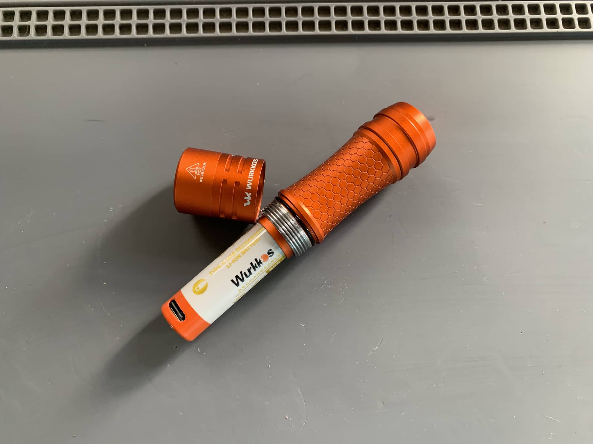

It arrived with a big black 2 way clip installed. I took a photo and then promptly pulled it off, which predictably left a couple of marks in the clip groove. The marks would be hidden if I decide to install a clip again. I dont wear a baseball hat, and dont like to have to lift the clip blade to remove the head.. For now Im enjoying it without a clip. I hope Wurkkos will ship the production version without the clip preinstalled.
The little TS10 without a clip feels very nice in hand! :wink:

Battery is a Wurkkos 14500 w USB-C, which arrived at 3.6V so I took it out and plugged it into a USB-Cable to charge it. I then installed a fully charged 14500 to do the following tests.
I tried to do factory reset with 13H, but nothing happened. I then completely removed the head and while holding the button screwed the head back on. This produced a factory reset (LEDs ramping up, a flash, and then off). After that the Aux came on at Dim output. Battery check did just one cycle and stopped. This tells me the light is now in Simple UI.

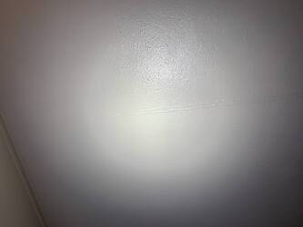

The beam shape on a wall looks nice to me, with a diffused hotspot plus spill. I did not notice any obvious artifacts in the spill.
Here is a pic of the beam shape on my ceiling:

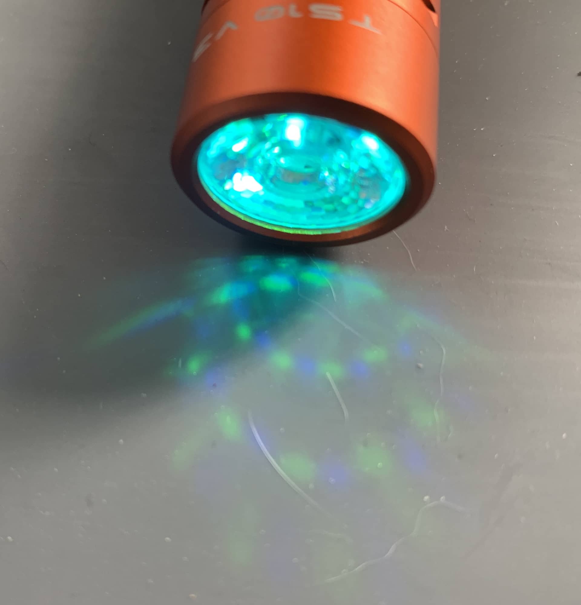

On bright Aux, in this next photo we can see the expected dots from the beaded outer edge of the optic.
I can feel a slight texture when I touch the optic. This tells me there is no glass. I like that there is no glass to break if the light is dropped.

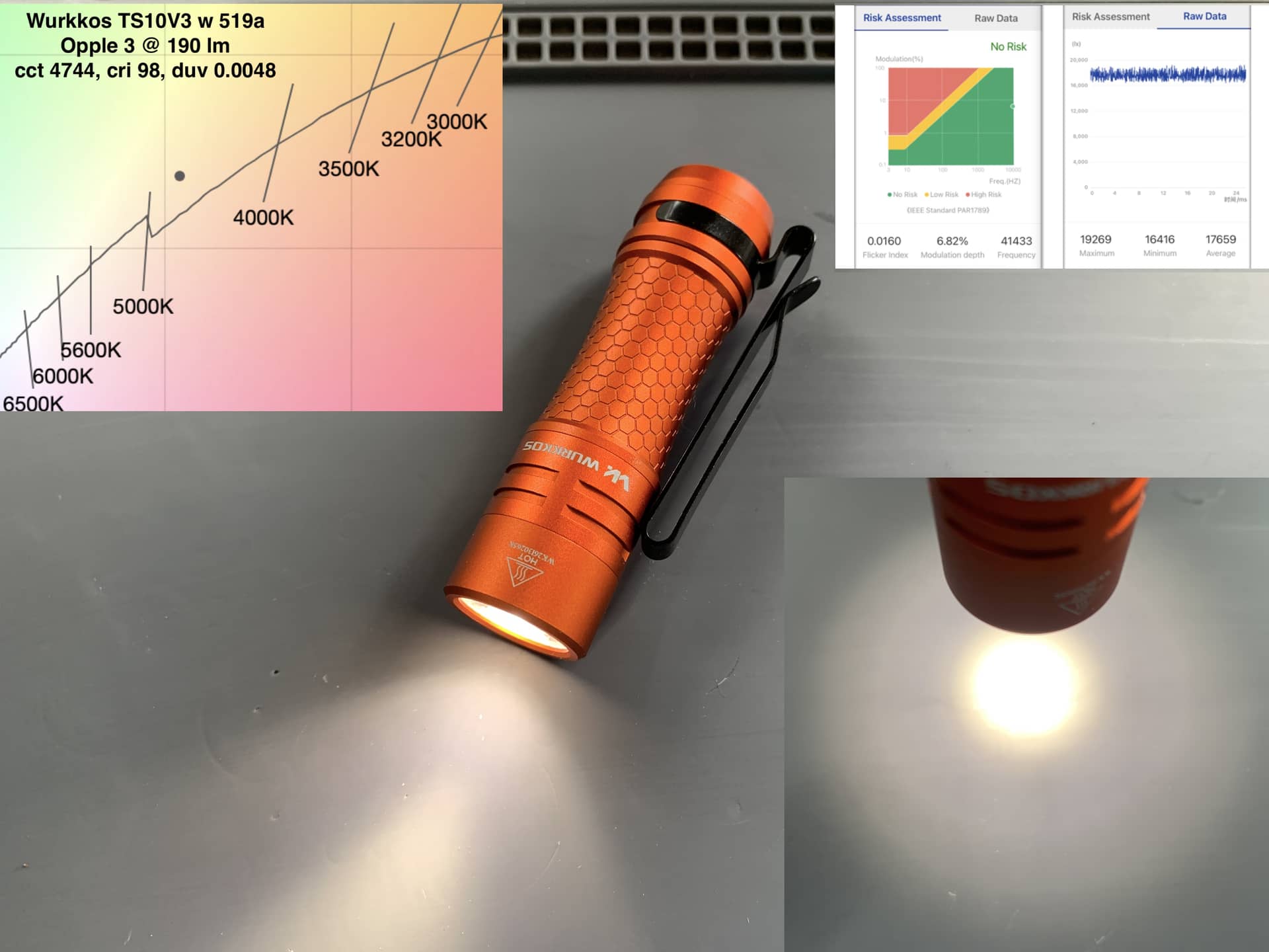

I went back to Simple UI to do some Opple tests. I did another Factory Reset to determine the default startup ouput. The light turned on at 36 lumens, which turned out to be step 2 of 5 in Simple UI. I went to step 3, which gave 190 lumens on my homebrew meter.
I used that 190 lumen output to test the CCT, CRI, Tint DUV and Flicker Index on my Opple 3. The results are in the composite first photo above

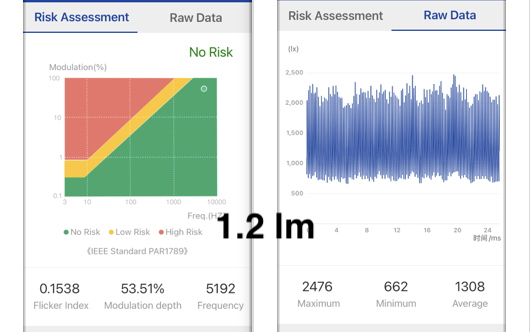

Next I wanted to see the Opple Flicker Index results on the lowest output, so I went to Advanced UI, switched to Smooth Ramping and turned on the lowest low of 1.2 lumens.. here are the results:

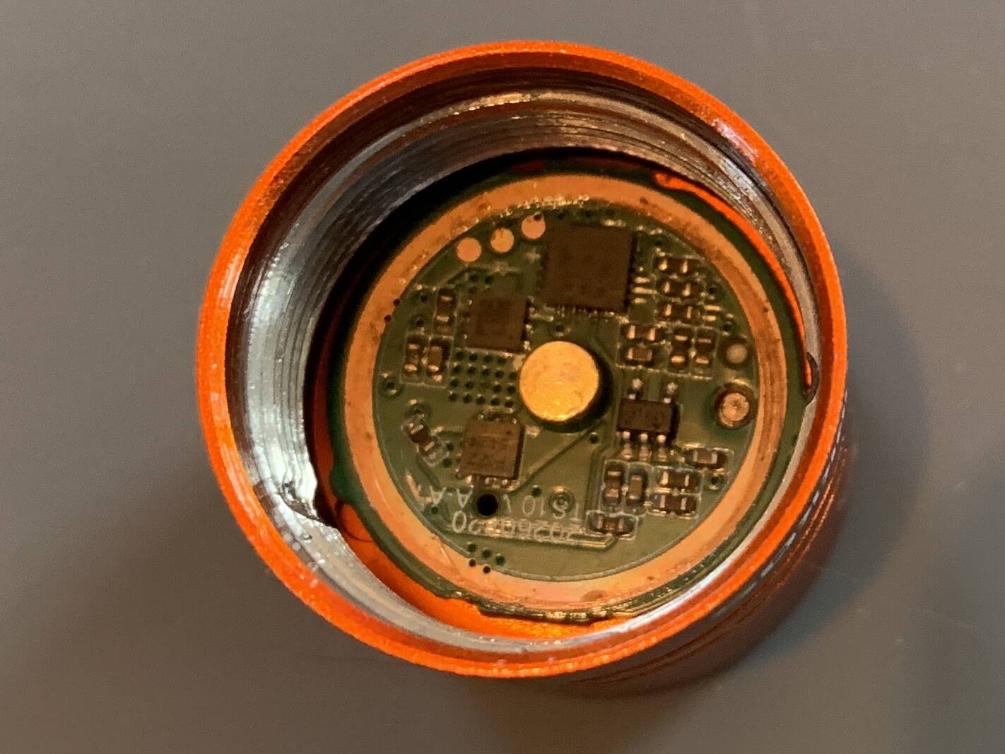

I do see some flashing pads on the driver, but I have no reason to reflash the firmware atm.

Finally, you mention it doesn’t look green to you, but 0.005 is about as green a 5000k 519a as I’ve heard of. Typically they’re closer to 0.002 and often even better.
thanks for commenting
the tint seems less green than my Opple reports for a couple of reasons
  1. my Opple reads about 0.0025 high
  2. at almost 5000K positive DUV is less noticeable
  3. I mentioned that I was looking at the tint during a sunny day.. sunlight has a nominal duv of 0.0032 so it makes the positive duv of a 519a a close match to my daylight adapted brain.

I did set the floor to 1/150 and it still measured the 1.2 lm default of advanced smooth ramping.. so that is as low as the buck driver is going to get.
Waving the light vigorously does not produce dots at that floor level, so I can say with confidence that there is no visible flicker at floor.
And even though there is 73% Riple depth, the frequency is over 5000Hz, which is beyond the visible range.
I intentionally tested the Flicker Index on floor, as that is usually where the deepest Ripple, and highest Flicker Index will be found. But this is not a light that I intend to use at outputs below 10 lumens.
