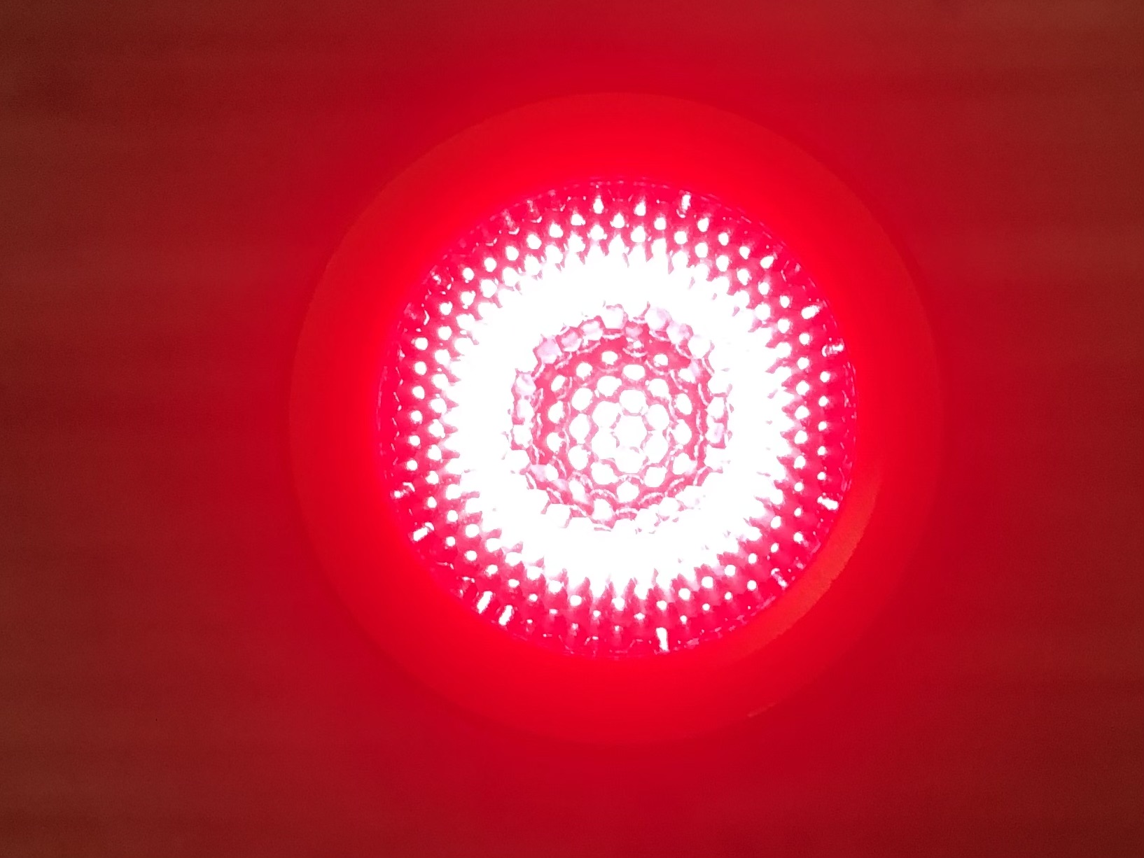

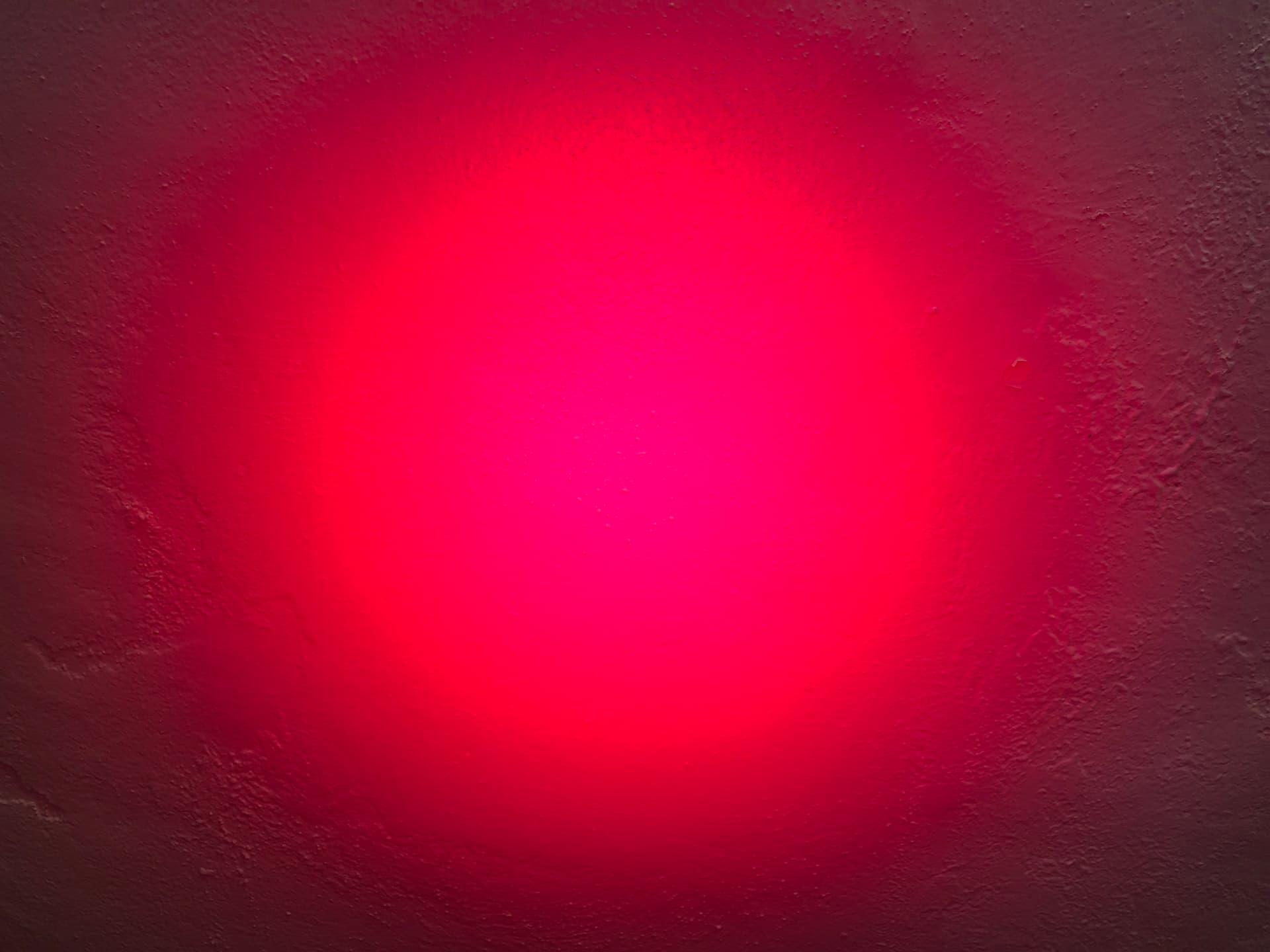

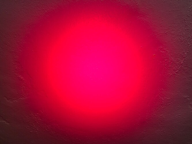

I like the beam shape from the Tir in the Wk03, it produces a useful round hotspot.
