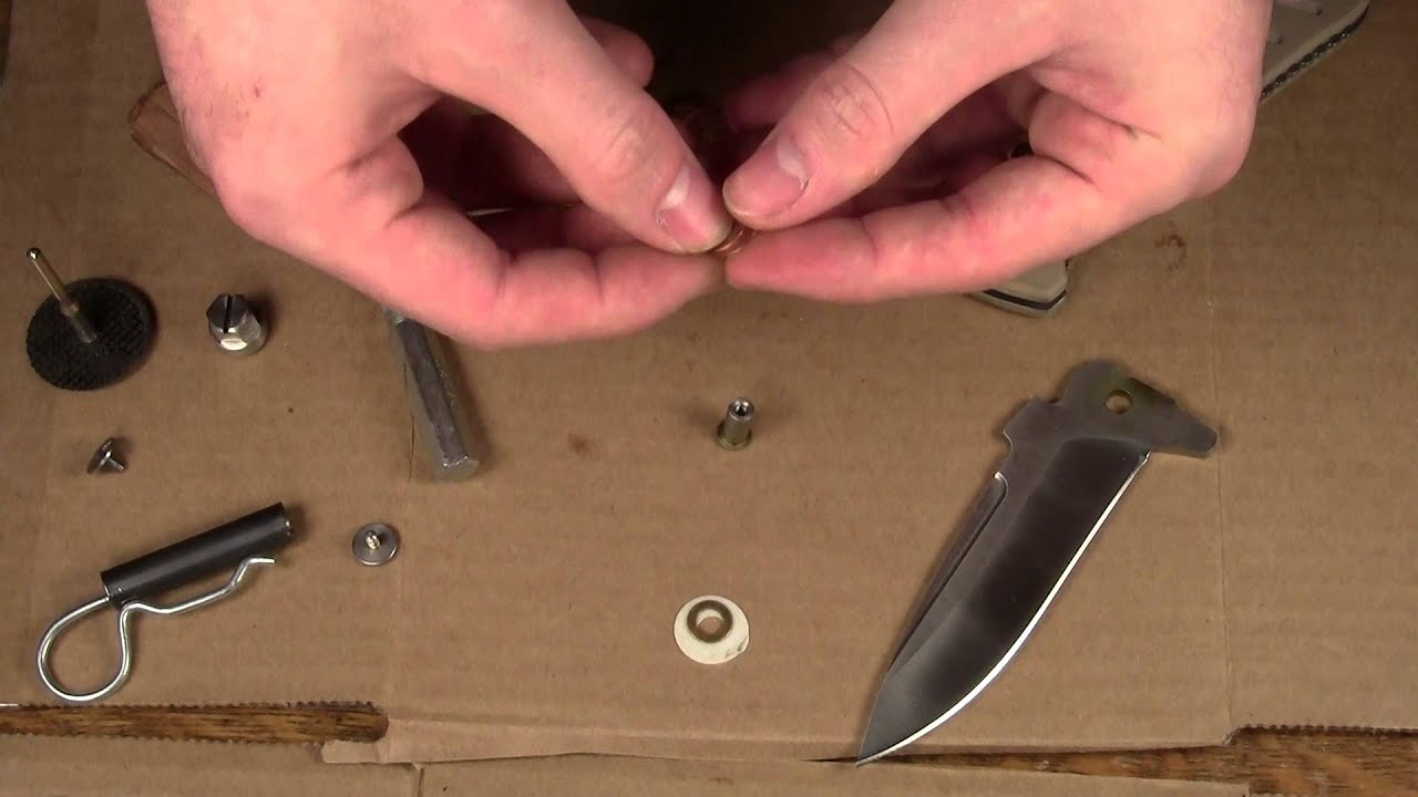

Nice collection, the clone is the Paramilitary right? Very addictive those clones. I’m trying not to buy another Military, for the money the clones are a very good knife, just in the shape of something someone else designed. Lots of views on that but in the end it’s my money to spend as I see fit. The EL-01KH is a very good knife, I’ve got a few and converted some to torx pivot screw and phosphor bronze washers, it makes a difference!
The EL-05 I haven’t had for long but I like wood scales. I see a Ganzo and a Kershaw but I don’t know the other.
Incidentally SRJoben sells a conversion kit for the EL-01 now, well worth the money.
Pivot kit for EL-0x Enlans
Joben video on fitting his pivot kit.

Thanks 8steve88 for the lazylizardgear washer kit link :slight_smile: now i have been sanding down the slip surfaces on my own for my personal ones and all the knifes i have been gifting this Christmas, and that takes way to long to keep doing :slight_smile: i hope i can get a similar smoothness with the washer upgrades.
I will order some washers for the Enlan, but i really like my original pivot screw so i am just going to buy the bronze washers
I wish fasttech would just sell the knife upgrade parts like they do with their flashlight mod parts…….
Do anyone know where i can find some washer upgrades for the Sanrenmu: 710, 7010?
Not as easy, the ones I’ve bought from USAKnifemaker are only imperial sizes, the SanRenMu’s are metric. The Enlan EL series has a 6mm/¼” pivot but the next size down they sell is too small a hole. The problem is the framelock and linerlock foul the outside diameter of any phosphor bronze washer that I’ve got. The upside is that I had plenty for using like this -
The washers from USAKnifemaker are reasonably priced but they refuse to send them any other way than USPS Insured Small Box, 30-40 washers rattling around in a 75mmx100mmx100mm box at a cost of $24 postage, joben sends his by letter at $7, much more reasonable. Jatagan sell a few limited sizes but again are crazy prices for postage. The screws aren’t so much of a problem, it’s a standard M3 size thread.
It’s a pity Enlan don’t sell EL-s with this pivot screw
Boker Magnum A-Stan. You get the tin and the Torx key for scales and pivot.
You might still have some flatting to do on the phosphor bronze washers but nowhere near as much as standard washers, they have been getting better on the stock ones though.

But i have to be honest i really don’t get why everybody don’t seem to like the original pivot screw on the Enlan, i think they work great by just adjusting them with my nails, the first i opened by just my thumb and index fingers nails and the second Enlan i opened first time with the chuck of my cordless drill but then it was easy to only use the fingers to open and close the pivot screw.
Isn’t thats why the are shaped like that so you don’t have to have any tools to adjust it?

Non of my Enlan EL-01 did originally flip open without any wrist movement, so i sanded down all the slip surfaces on them with finer and finer sandpaper on a sheet of glass and lubed them up with coconut oil after cleaning up all the fine metal dust from the parts.
Now they flip open butter smooth with an almost silent movement, to get an even better motion after polishing the surfaces you can open and close the blade many many times by hand to wear in the knife even faster.
I can’t even express how nice it feels it when they are this smooth, just do it it so worth the time it takes if you are a fan of your Enlan, i gifted my best EL-01 to my brother in law this Christmas and i am already missing it :slight_smile: but i plan to hopefully make an even smoother one with lazylizards upgraded phosphor bronze washer well sanded and polished if needed.

The recent EL-01’s that I have are getting smoother from the factory, the earlier ones had a real gritty feel, still usable but not as smooth as I liked, that’s why I started by flatting and cleaning the existing washer (one is nylon/plastic) and smoothing the mating surfaces. I’ve spent an evening or two looking at AliExpress for phosphor bronze washers, they confuse copper with brass so the chance of getting phosphor bronze is unlikely.
I’ve tried everywhere from steam engine to R/C models and they are either the wrong size or too expensive, an effect of the U.K.’s decline in manufacturing industries.
I like the bolster to be a stronger and heavier material than the handle scales.
The Enlan EL-01 will bed in if you keep opening and closing it, or strip it, clean it, make sure all the moving surfaces are smooth then a drop or two of oil and you should be good to go. A washer kit will improve things even more. It might just be a pivot screw that’s a bit tight and needs adjusting.
