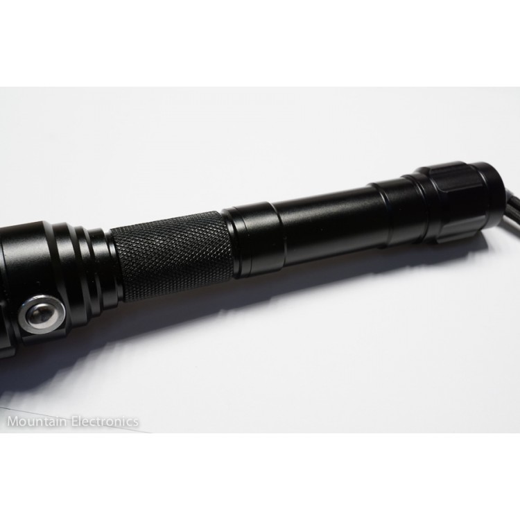

It is a really nice housing and I like the side button but the light it puts out is just pitiful. So it seems like a good reason to attempt my first mod. Iâd like to put a ~3A driver that has simple lo-med-hi modes, and a nice high-CRI LED. The parts I picked out (with some email help from Richard at Mountain Electronics) are:
A few questions:
Are these parts suitable, and/or are there other parts I would want or need?
This mod would basically involve just taking the old parts out and putting the new parts in, correct? Or is this newb in over his head?
Any tips, guidance, or advice youâre willing to offer would be greatly appreciated. :student:

First of all you'll have to see why they put such a led in a flashlight ? Maybe inside is just a narrow ring instead of a pill , as is happening with the most of these kind of budget lights.., but I have to admit that this one is looking good so , open the bezel , remove the reflector to see what is inside , and then decide what you have to do . Because , if it is a hollow pill , even with the led on the noctigon copper, will not survive at 3-4 amps without proper cooling...Anyway , there are a lot of solutions to improve the heat dissipation ,all of us done this at least once , with a light that deserved that !
cbrake10 was right , seems to be a solid host ! You're lucky , go for it..., about the driver , sorry I can't help you much with that , but a lot of guys here knows better , I'm sure they gonna help you to make the best choice...

I've modded a M2-Z and use it often as my e-switch test light. It's a nice simple mod host, C8 size and style basically. Surprised in looking, I can't find any pictures, and not much in notes.
I have a 22 mm triple channel driver in there now, and a XPL V6 2C on a 20 mm SinkPAD. The SinkPAD had to be trimmed slightly, but the Noctigons are more rounded, so would probably fit with no sanding. If you go with a 219C, it's the same XP footprint as an XPL, so probably this LED alignment piece will work: http://www.mtnelectronics.com/index.php?route=product/product&path=25_82&product_id=174
It has a removable pill. In your own pic, you can see the two drilled out holes/indents where you can use a needlenose to unscrew the pill. They are just outside of the black piece. I toss the black piece on these lights after upgrading.
It's a simple light to mod, but you still need to check a few things:
Be sure you order the proper parts, and all the parts you need
Take measurements - old MCPCB height vs. the new replacement. Many times the new one is higher than the old one, and sometimes replacing the LED centering piece can make up for the difference.
With that 22 mm driver you are referencing, sometimes those 7135s on the driver spring side can interfere with the retaining ring,so might need some work to fit. I can't recall if I did it or not on this light. If it interferes, you should be able to sand the inner diameter of the ring to make more clearance.
If you have any doubts about the parts for this light, please ask Richard first at MtnE - he's done a lot of modding on these lights and knows it well. He will probably make sure there's no mistakes in the parts order.
