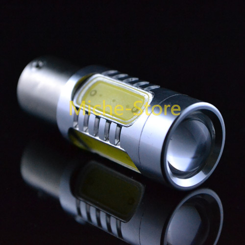

After installing a pair of HID headlights on my truck, I want to change out some of the bulbs for LED ones. The original bulbs are rated at 21w and the LED ones are 7.5W. Installing LED for the indicators/signal lights may make them hyper flash. To prevent this, I’ll need to either install some load resistors or a relay.

The original bulbs are rated at 21w and the LED ones are 7.5W. The ones I see on ebay are mostly 50W 6ohm resistors.

Anyways we’ll see what how these 11W LEDs will look like compared to the stock 21W incandesents I’m replacing.
