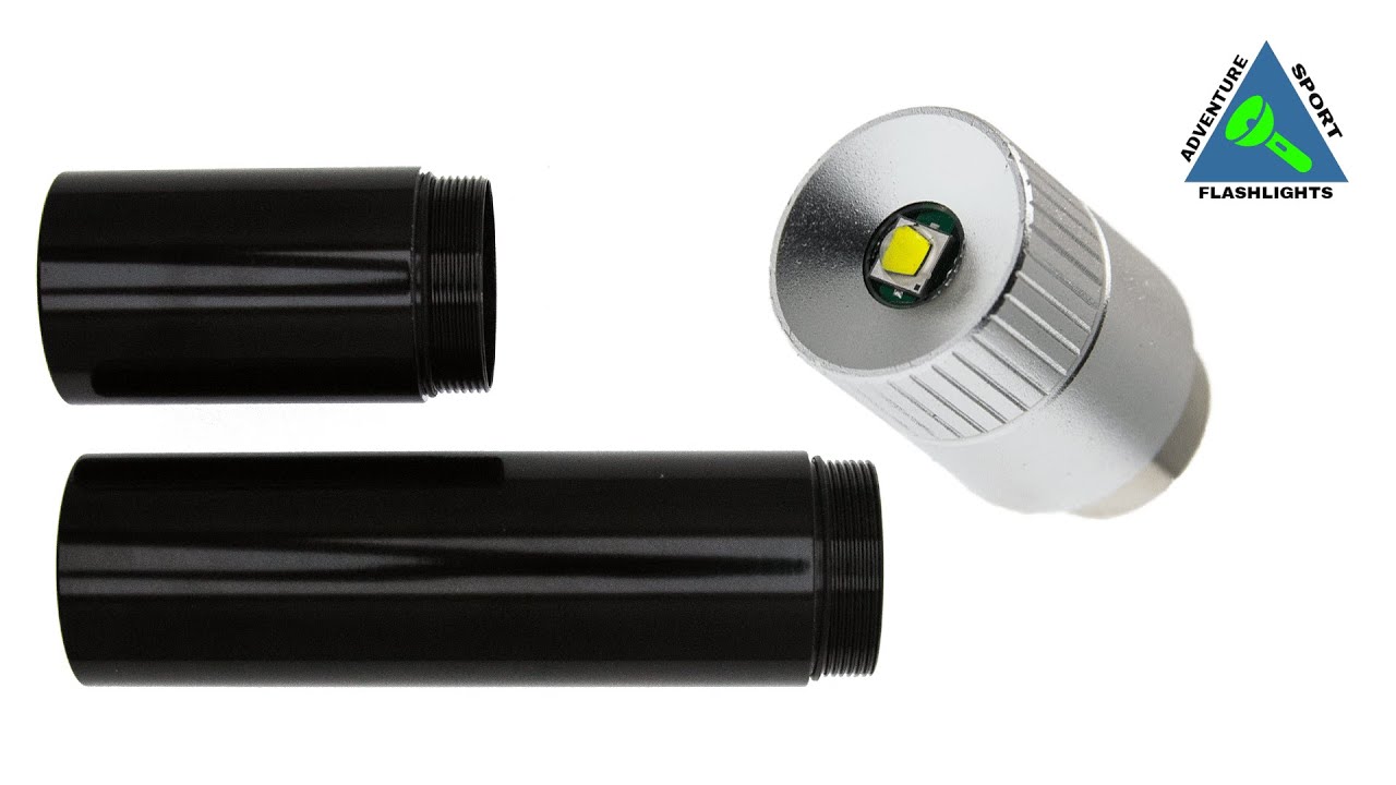

I am upgrading a old 2 d cell flashlight, is there a brighter option than this?

Plenty of alternatives, you can either buy Maglite Nite-ize leds or you can buy this
https://asflashlights.com/led-upgrades-for-maglite/107-conversion-kit-for-maglite.html
But for that amount you can buy yourself a decent light though
thanks, i plan to use d cell replacement adapters that hold 3aa’s each.
30 lumen of the Dorcy one seems very low output. I’m not convinced it would actually be an “upgrade”.

The Dorcy drop-ins are not very good - fairly dim with blue tints.
The Nite Ize 55 and 74 lumen drop-ins are much better.
I have one of these in my old 4D Mag:
I like these a lot. I think mine is rated at 350 lumens.

I went through a few Mag LED replacements and a Nite-Ize, nothing terribly impressive.
’Though I did take one of the Mags and stick it into a 2×AA light. Easy mod. Toss the cap that holds the hotwire bulb, with an Xacto knife lightly shave the reflector hole that you can firmly press-fit the Mag, and you’re done. Consistent output vs dimming with SOC, and about 5× the runtime vs the come-with hotwire bulb.
But in an actual Maglite, those replacements kinds stink. No noticeable increase in brightness (thermally isolated, so can’t do much), and usually crappy blue/purple tint.

Now I’ll be the odd ball and chime in for the cheap dorcy LED. Yeah it’s pretty dim. Yeah it’s a bit blue (about like a nichia ds). But it’s cheap. And it draws only the tiniest current. Your batts will leak from old age before they go dead! I have a couple in my long term emp kit.
Which nite ize do you have and how much heat does it generates? My bulb holder is plastic.
