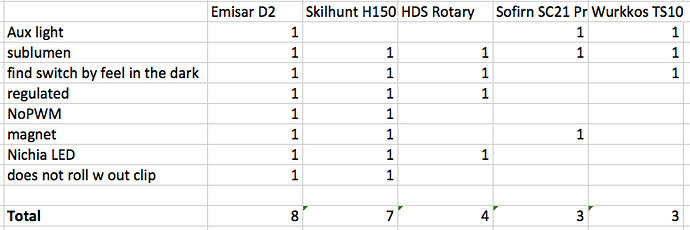

I created a spreadsheet to organize some of my use case priorities… here are the resulting scores for some of my favorite lights:
there are other criteria I did not list, such as weight, battery size, beam type, use case scenario, dual fuel capability… etc
atm, my Emisar D2 w DeDomed 4500K 519a and Red 660nm, both with floody optics, is really working well, for my needs.
And yet you are such a TS10 supported/proselytizer/fan? Or are they out-n-about lights for you? Or do they score poorly in your rubrik yet outperform in the real world? It is fascinating to learn how people use and conceptualize their lights.

this is true
some of the criteria dont have the same priority for me, for example, a magnet is low priority, so the lack of one does not discredit the TS10 for me.

It looks like, according to your rubric, the SC21 Mini would win 2 points on noPWM and regulated output, but lose two over the Pro on sublumen Moonlight and unilluminated switch.
yes, the SC21 Mini does have a regulated driver with longer runtime than the SC21 Pro
For me, the illuminated button of the SC21 Pro has a higher priority, than the driver efficiency of the SC21 Mini.
The button light on the Pro is very useful to me, for nightstand use. It also makes it much easier to locate the small switch button in the dark, instead of having to roll the light around feeling for the button of the Mini.
