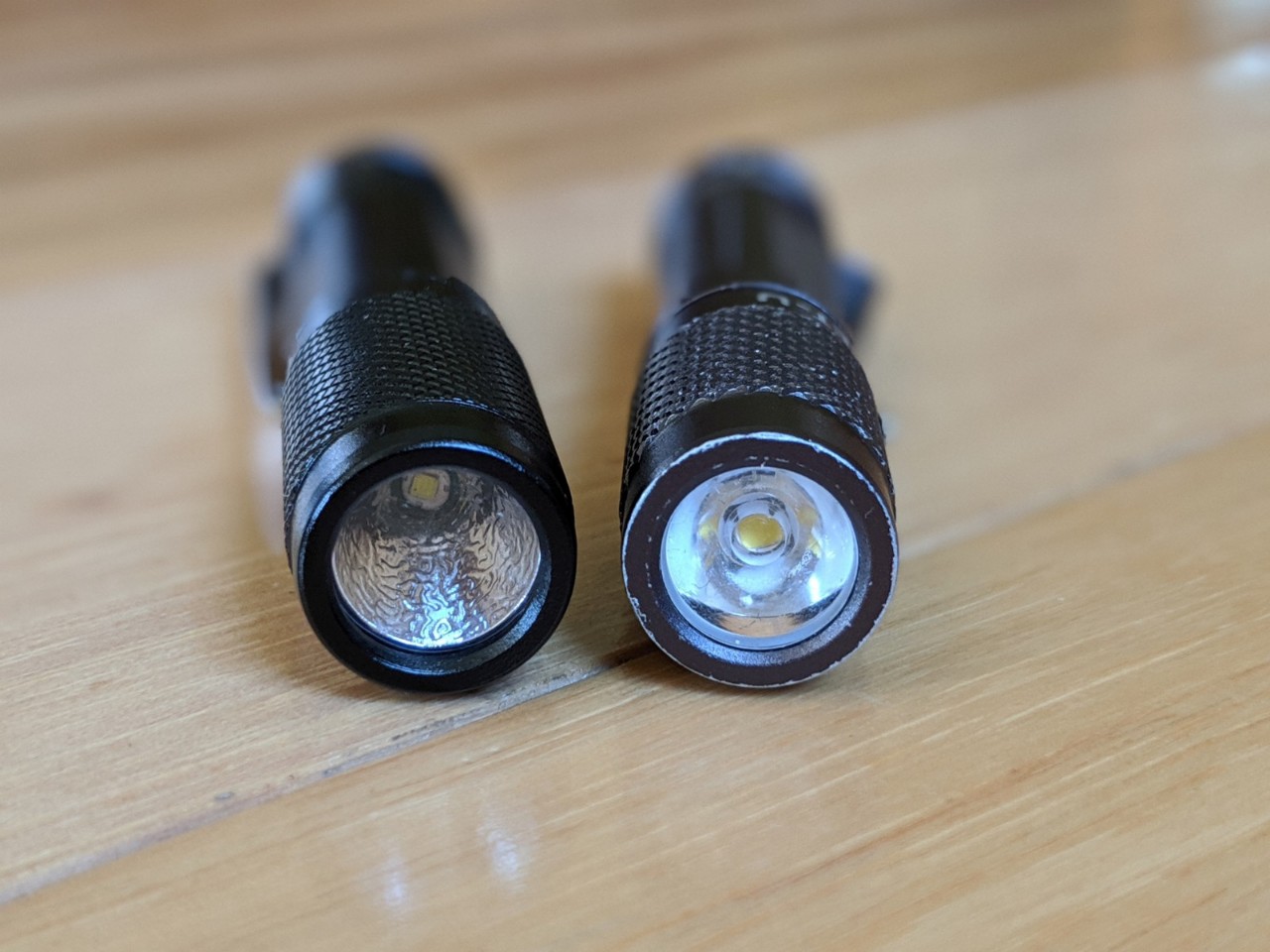

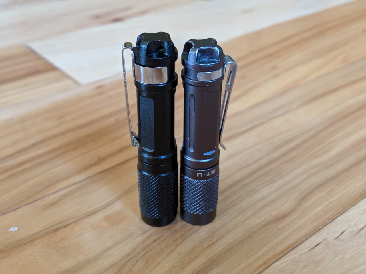

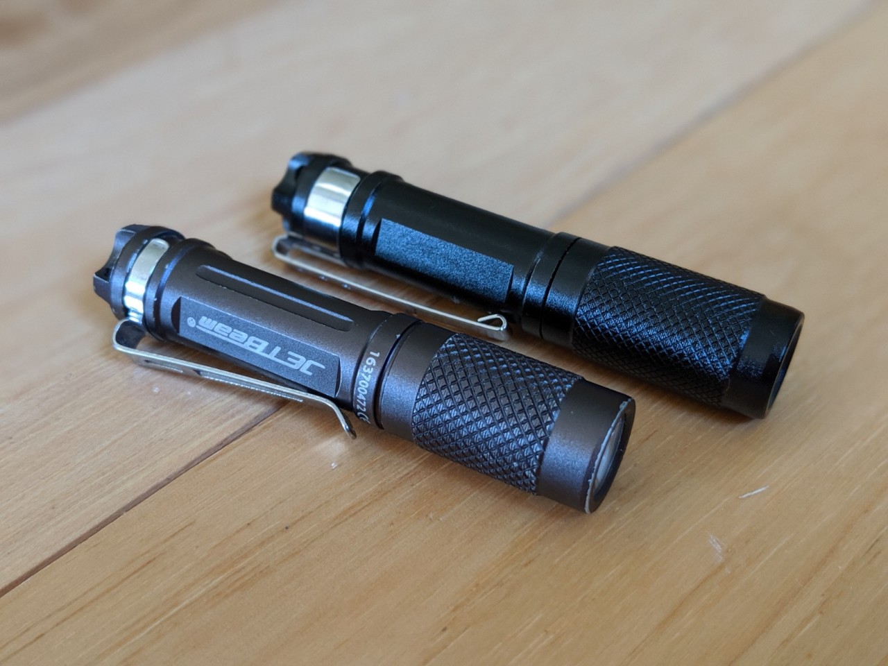

Well, I ordered 3 of these two weeks ago at $1.37 each. They just showed up today. They’re pretty much what I expected:
  • Slightly longer than a Jet-u, but dimensions otherwise the same
  • Cheap, glossy black anodizing
  • 1 of the 3 is missing it’s o-ring
  • The emitters are definitely angry blue

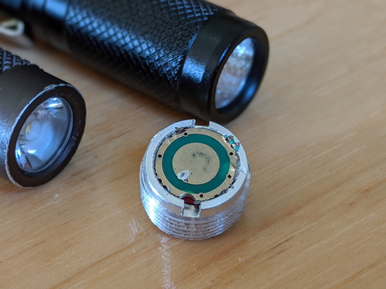

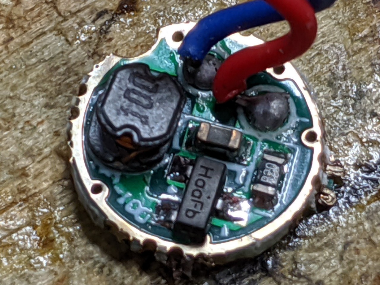

  • Pill is easy to remove. Driver is press-fit but also easy to remove.

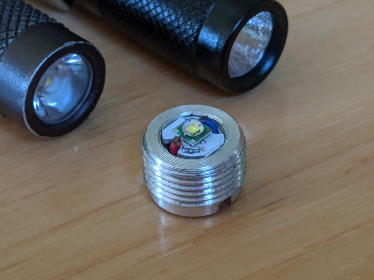

  • MCPCB is 8mm and has a XP-E looking LED.
  • I measured output at 48 lumens
  • The head is slightly too long. You have to really tighten the head down to make electrical contact with the tube. A little filing will easily take care of this.
So they’re not without their faults, but seemingly worth the price paid. I can’t wait to swap the emitters. I might end up playing with the resistors too.

Update: I just reflowed a Luxeon V2 5000K into one. So much better now that it’s neutral instead of angry blue. And I picked up some lumens: it went from 48 to 71.
