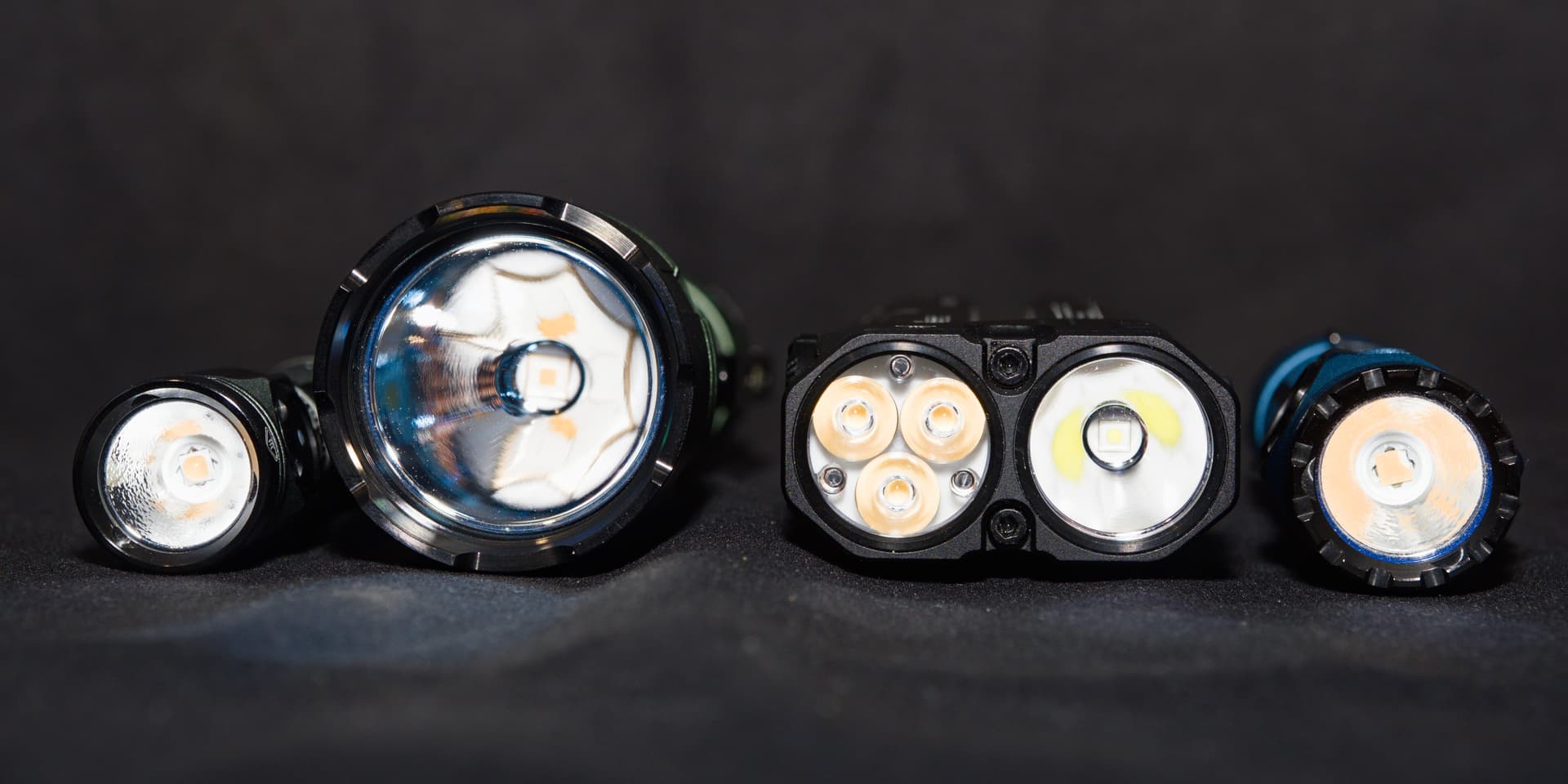

Flashlight of the Year 2025
2025 has been a good year for flashlights, more than doubling my count of ★★★★★ (outstanding) ratings. It’s time to pick a favorite.
Read more…

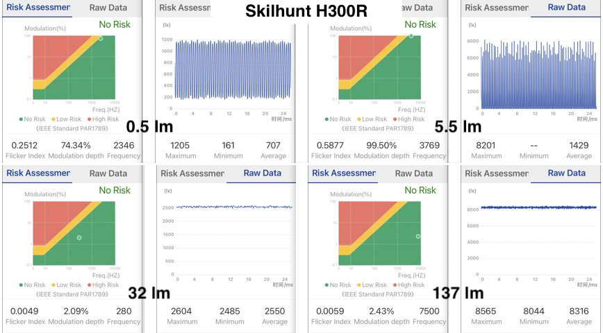

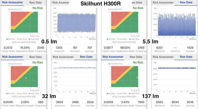

do you have Flicker Index data for that light?
I used my Opple 3 to look at the Flicker Index of my Skilhunt H300R.. it has very low Flicker index on all but the 2 lowest modes:
I don’t have that kind of data. I use a camera’s electronic shutter to check for flicker, which appears as scanlines at a high enough shutter speed. The M150 has a very slight ripple in L2, but nothing like what you’re seeing in the H300R.

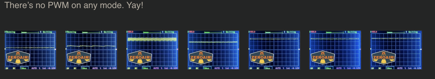

I like that Skilhunt drivers dont rely on PWM. zeroair posted this test of the M150:

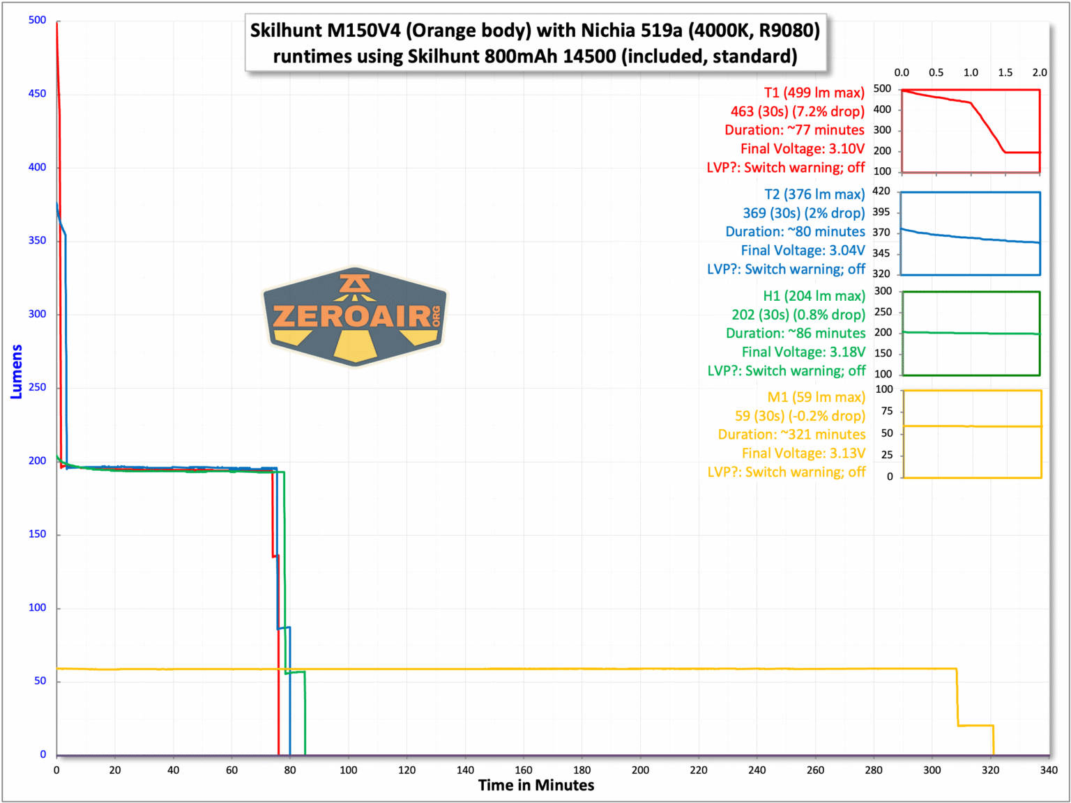

and they have nice regulated output:
