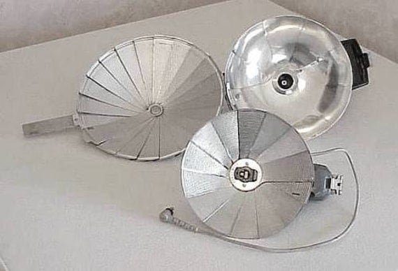

I remember these from long ago, and nowadays they’re cheap on ebay — lots of varieties.
Basically: a battery case with a socket for a flashbulb, and around that a fan-fold metal reflector.
Usually the battery case is at right angles to the light source, but some of them are inline.
The reflector pieces are either smooth or pebble-textured, the curve is defined by the shape — and the reflector leaves, depending on what they’re made of, might work as a heat diffuser when spread out.
So, just tossing the idea out there in case it interests anyone.
Here’s one:
http://www.ebay.com/itm/Vintage-National-folding-flash-unit-Made-in-Japan-/181393190728?pt=Digital_Camera_Flashes&hash=item2a3be06f48
here’s a few more: https://img0.etsystatic.com/019/0/8240198/il_570xN.490680820_di2x.jpg

Making reflective surface that is effective and able not to get scratched when folding would be impossible I think.
I wonder if a decent reflector could be made from reflective mylar and be inflated into proper shape? That would save space for single use emergency signal lights.

I’m old enough to remember using these for flashguns. They were well made — they had to produce an even light distribution across the image and hold up under repeated opening and closing.
The leaves didn’t slide across one another, they were springy enough to separate and stay separate til you pulled the thing around to make a full circle, and that pulled them into the bowl/reflector position. Unclipping them let them separate slightly and stay that way as they were folded, then a clip would press them together for storage.
And the surface was often chrome plate (some shiny, some orangepeel) on some moderately flexible metal, likely bronze or steel. That surface didn’t scratch easily.

Those reflectors were made for flood, not throw, and for a bulb that shines in all directions, about half of the light going backwards, while a led shines only forward: this reflector will hardly catch any light from a led unless it is mounted inwards, the recoil thrower set-up.
This.
And if you do a recoil setup a lot of the light coming directly forward from the LED will hit the center section where there’s no reflector and be absorbed. My guess is you’d get less flood than you would with a mule setup with no reflector.
Good idea, worth posting. The Devil's in the details, of course. Maybe an MT-G2?
It still has the cone of light (115°), coming from a wee (less wee than an XP-G, granted) flat plate. Still not the kind of light source the Parabolic reflector was designed to accommodate. Still a dirty kludge with no real hope except to get more people to notice we don’t have any decent reflectors for LEDs yet. At least these folders get out of the way when you’re not using them. And it’s still possible to recurve them to catch more of the main light output…
