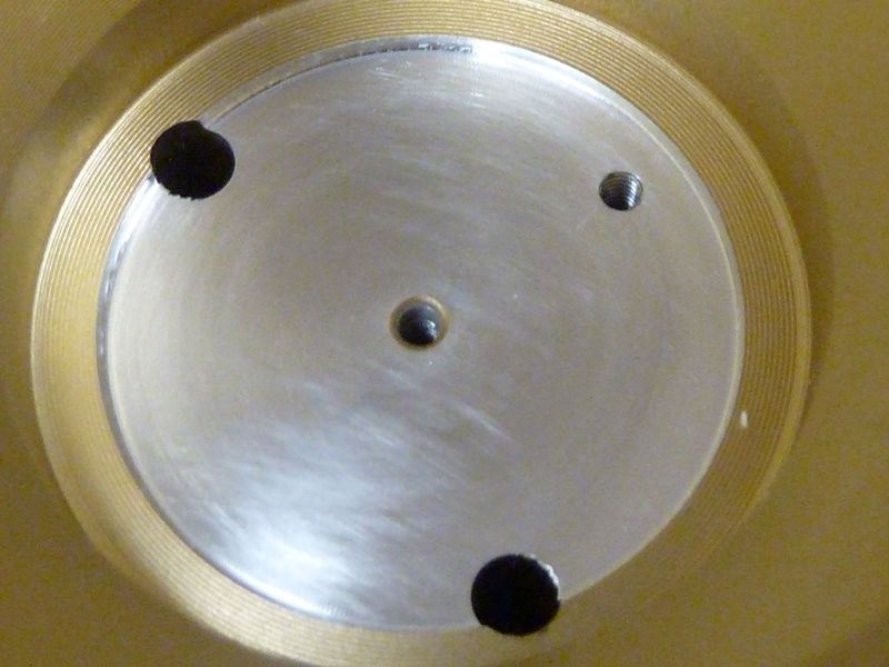

Swapped in the SIRA20DP:
Sanded surfaces down to 2000/2500 GRIT:
Upgraded 18 AWG to 16 AWG wires:
MX-4 - little excessive for good coverage, kapton to protect larger solder joints:
Removed inner spring, added 20 AWG bypass:
Kind of surprising, did not gain much in measured tail amps, possibly 1 amp, measuring 33-34 amps on the 40T, 30T and T50. The tail bypass though made a nice difference, so I think the wires and FET mods gives the tail bypass more of a boost. It's a game of bottlenecks - improve one thing, then the next thing becomes the bottleneck.
