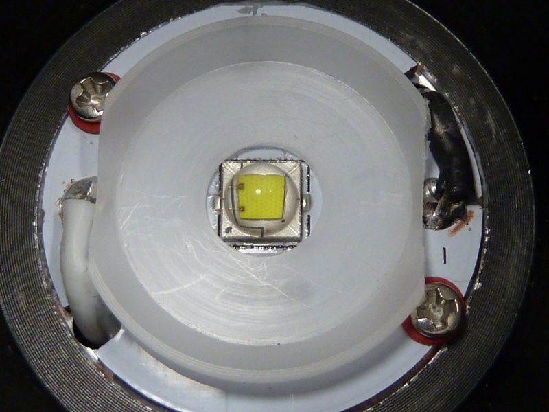

7.- Since I didn’t feel like re-flowing the LED I decided to create a cover using a small syringe
8.- This is how it goes on top of the MCPCB
9.- Secured with masking tape, make sure you clean up any residue of the tape when you are done! There is a piece of glass under that 1200 grit sandpaper (Not shown) I decided not to start at 600 grit paper as Tom E suggested, since I want to control how much material I take out from the back of the MCPCB,

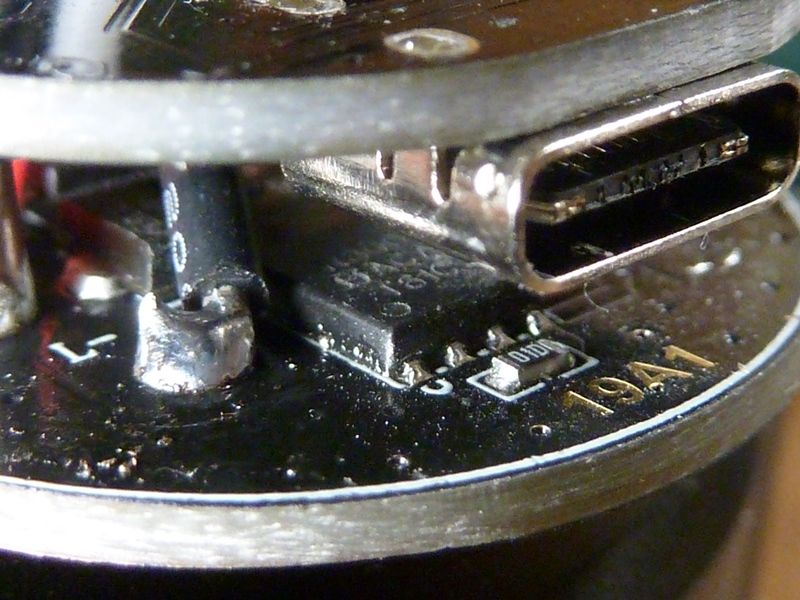

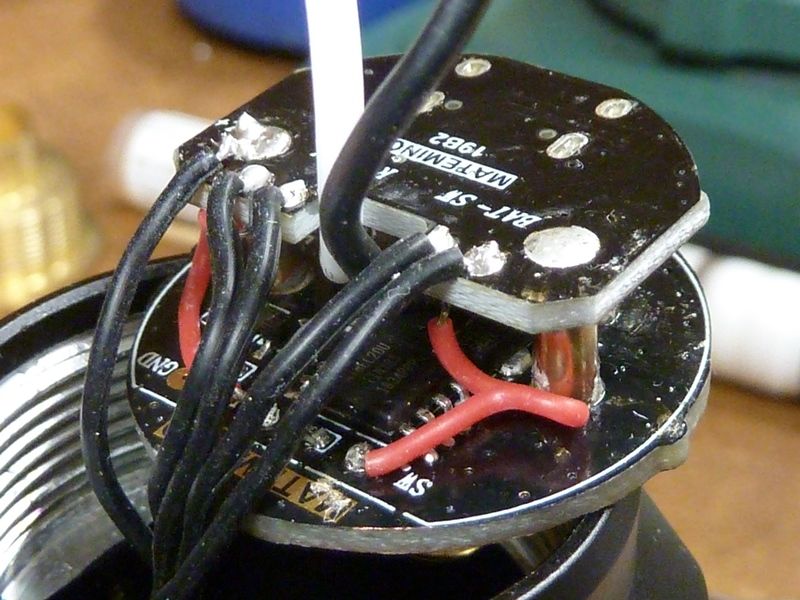

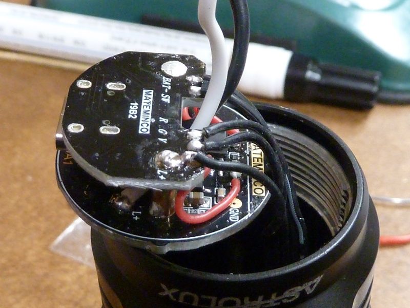

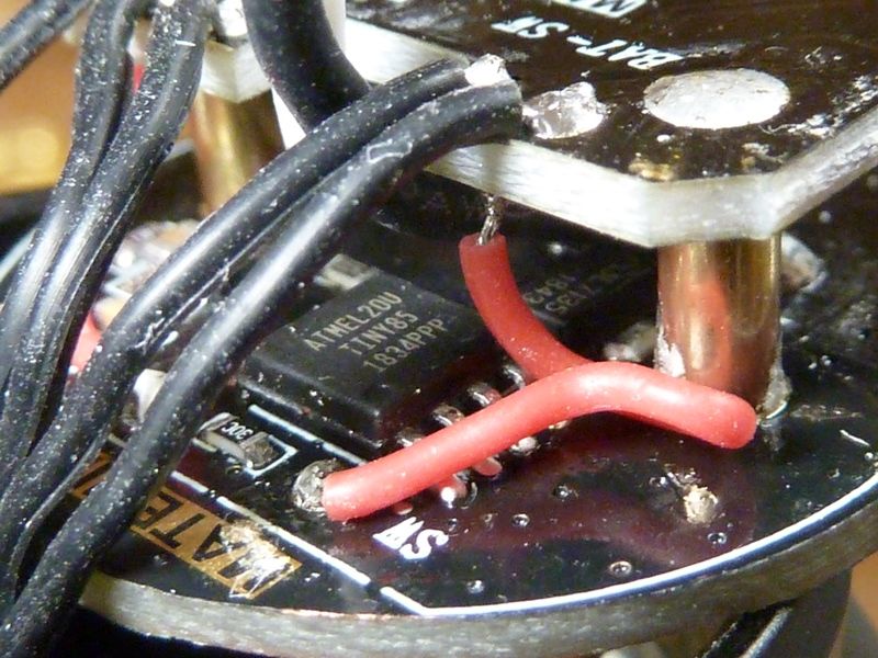

The driver
It's got a 5 wire harness going to the switch (Batt+, Batt-, Red, Grn, Switch) - no idea why Batt+ is needed. 2 boards - the contact board id the LED driver, and the piggyback board is the USB-C charging:
The ATTtiny85 running NarsilM v1.3:

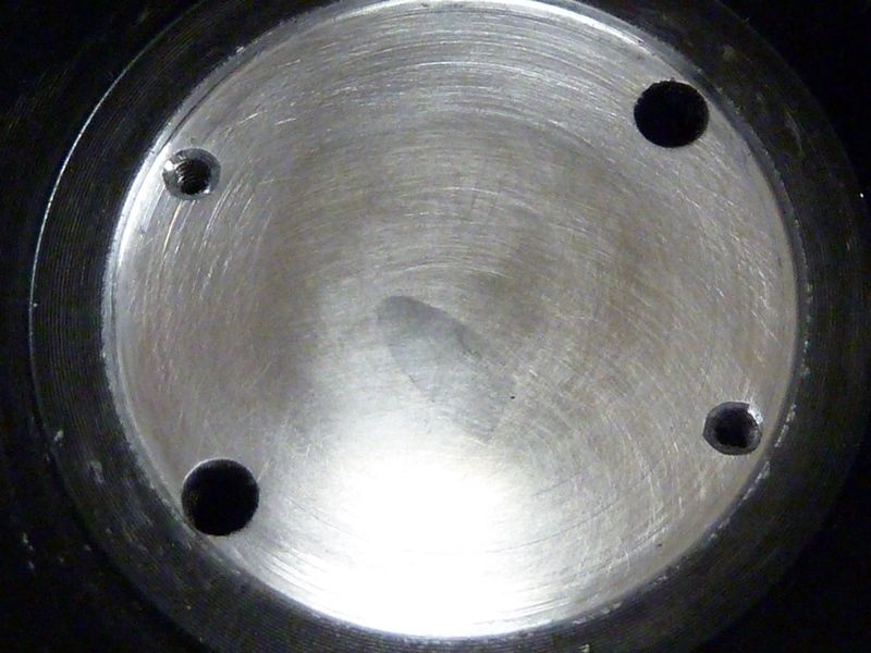

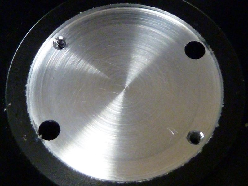

The shelf with machining marks, but after I beveled out the screw holes -- looks nice now, used a simple larger drill bit, works wonders:
After polishing to 2000 GRIT:

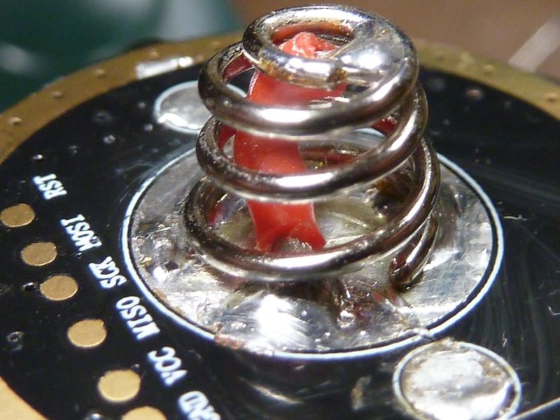

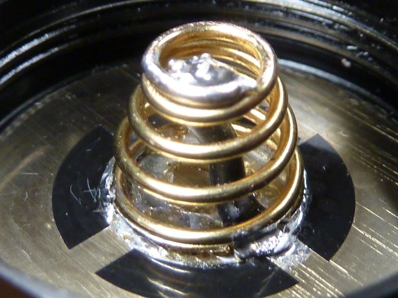

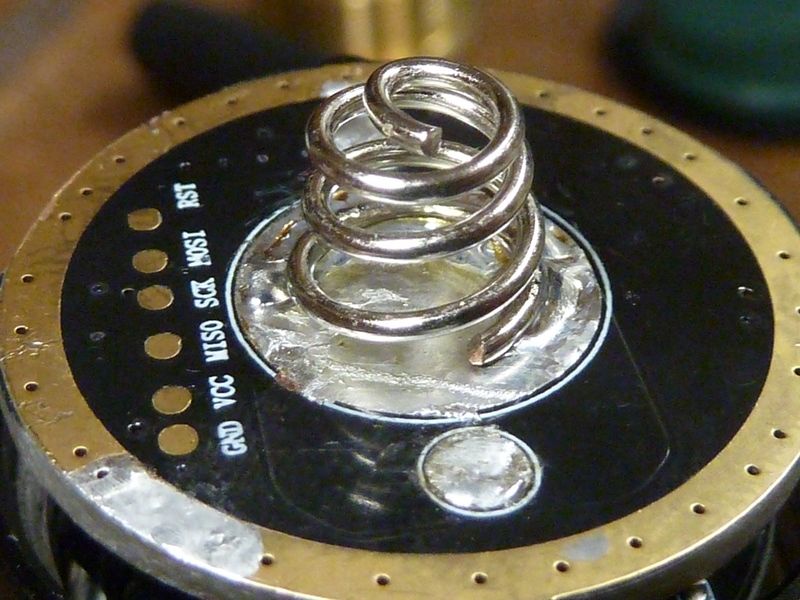

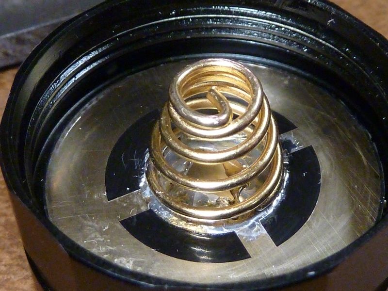

Springs
Replaced the stock double springs with the Blue Be/Cu large from batch #1, cut off 1 1/2 rings off the bottom. I want to get lower compression. Batch #2 springs are too stiff for this usage:
20 AWG bypass:
Tail spring with the inner removed, stock outer, 20 AWG bypass:

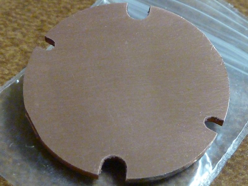

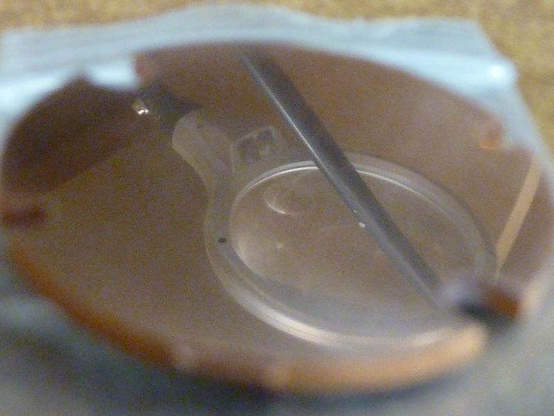

Sanded down centering piece. Could not get the LED centered - the wires interfered:
All done:

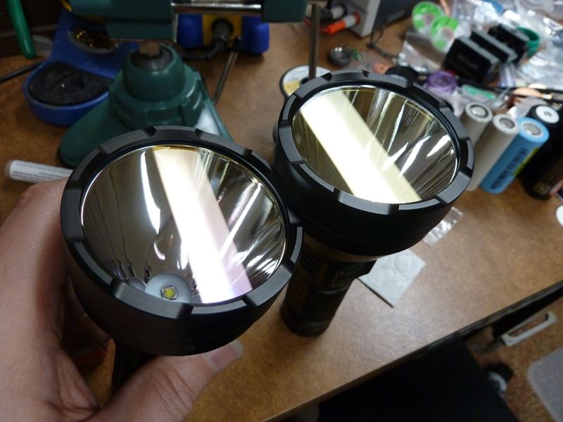

2nd on left, 1st on right. See the purple tint on the left one and yellow on right? It was hard to catch in a pic but much easier to see in real life. Weird they changed the glass:

Is the driver FET+1 or FET+n+1? Whats the pinout they used?
My XP MCPCB will be here tomorrow so I can do some probing then when it’s back apart for the emitter swap but if you took note I can build my FW for the right target tonight.
What in the world. How is this supposed to fit?
Where does the reflector push down on the centering ring?
PS, don’t swap the FET. That might be what’s protecting the led from too much current.
On the inside edge. This centering piece looks like a bowl and the reflector sits inside.
Kind of simple,here is his answer which is in the post,now it will be centered.
I only see 1 7135 in there so looks like FET+1, Q8 style, but weird because TA designed it and TA is known for triples (FET+bank+1).
Ahh, you really want a 28 mm MCPCB though to clear the reflector opening - it's huge - is that what you ordered?

Jason, yea, the reflector (from head pics look' down )has a really big oversize hole. I don't see how you can use anything smaller than 28 mm unless your wires are on the inside of the hole, and routed under, or thru new drilled holes - think someone did mod'n like that.
