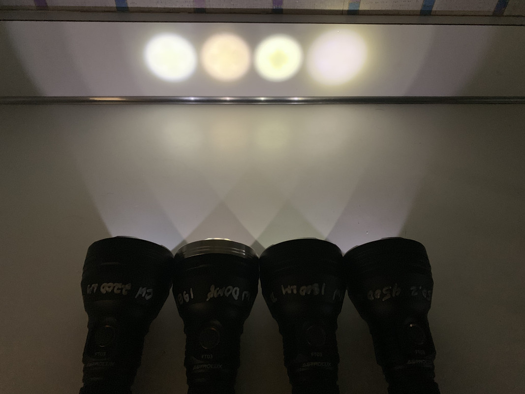

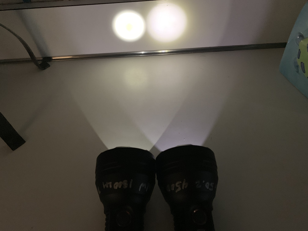

Do you have a beamshot of a stock SST-40 against a domed / de-domed Cree 50.2? I want to see how much bigger the spot gets and if there is any dark spots in the center of the beam of the 50.2
Thanks!
[quote=AlexGT]
Sorry no long shot, beam shots…but the 50.2 looks great, not like a 1st gen 50, prolly because it’s not focused 100% maybe, it looks like any other 70.2 , but in the FT03 stock set-up, it looks pretty damn good really.
FT03 CW (stock) FT03 NW (stock) Dedomed 7500k SST40 FT03 3v 50.2
Clean De-domed (not sliced) SST40 7500k and the FT03 3v 50.2 Dome On
