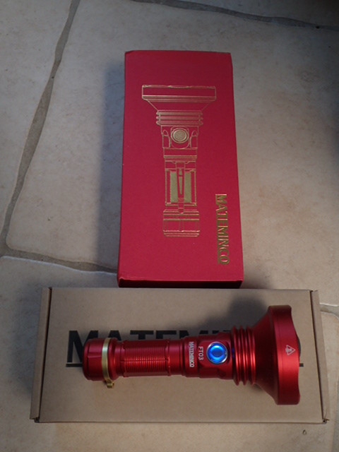

Ordered mine exactly a week ago, estimated arrival in April… it arrived today

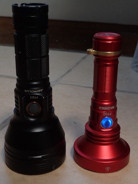

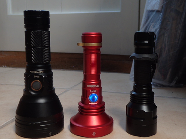

Compared to its namesake it’s a bit smaller than i was expecting.
It’s more C8 sized but with a wider head obviously.
The battery tube feels narrower than i would expect for 21700 sized, feels and looks more like 18650 sized to me.
Fits well in my hand though and the button seems to be where my thumb expects with inital impressions being that it’s easy to find.

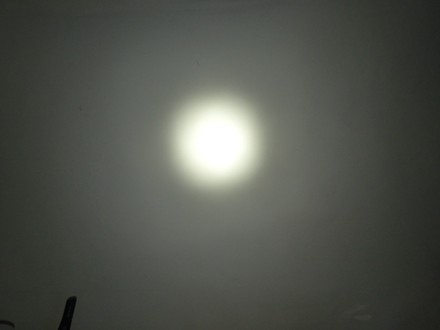

Here’s a quick wall shot. Not the smoothest beam and a bit square but i’m not expecting this to be relevant in use.
The tint is on the yellow/green side which i expected from this LED, though i’m not sure why i expected that as i have no experience with this LED. I like the beam, it seems coherant with no glare but if you’re a rosy fan you’ll be disappointed.

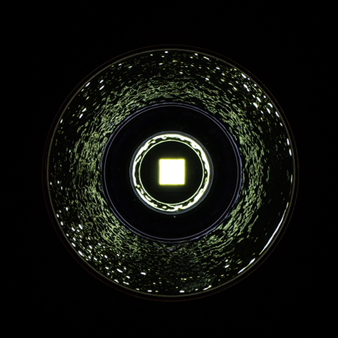

Here’s a lit reflector shot just cos it’s pretty, you can see the lack of reflection from the wide reflector base. I was expecting this from the marketing photos.
