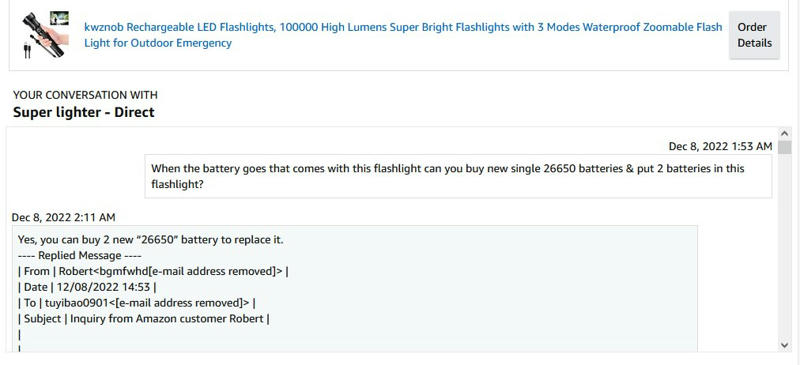

Here is the message I received from the seller before I even bought the light. Seems pretty straight forward he’s recommending 2 - 26650 & 2 - 18650 would be the same voltage. Only difference would be battery diameter & these light use to come with 2 - adapter sleeves for 2 - 18650’s.

Yes, I agree the message from the seller is not clear.

The message from the seller was not clear, but neither was the question. 2 cells, is 2 cells. Configuration is critical… Obviously.
The seller obviously does not know much about what he sells, you can blame him for that, but OP knew the original pack is 4,14v and series wiring doubles volts. so i'm not sure who is more at fault, i'd say 50/50
