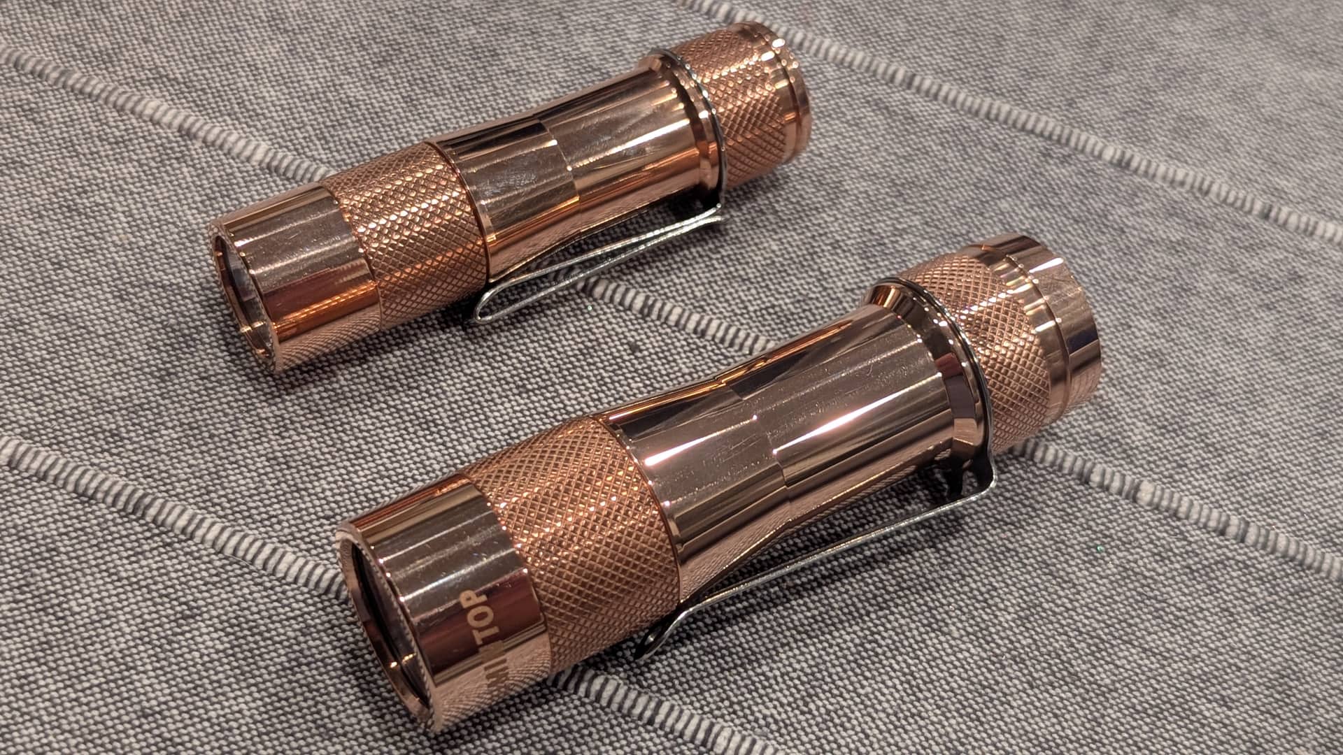

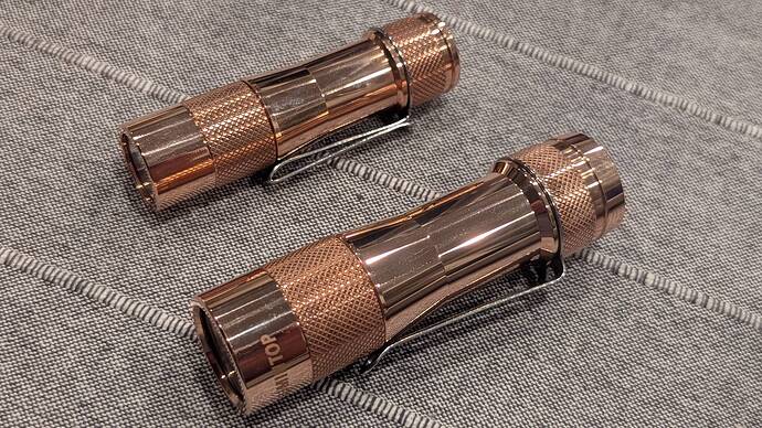

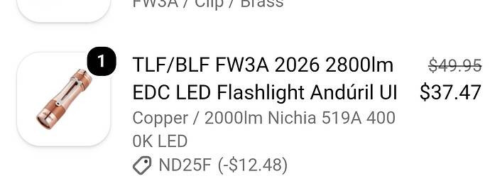

I just ordered this beautiful copper FW3A 2026 they also have polished and stone wash titanium available. I found code ND25F in an old Reddit post and it worked for 25% off of the light.

Just got my delivery today.
9 Thanks
Beautiful!
Is anything glued and do they have Anduril 2?

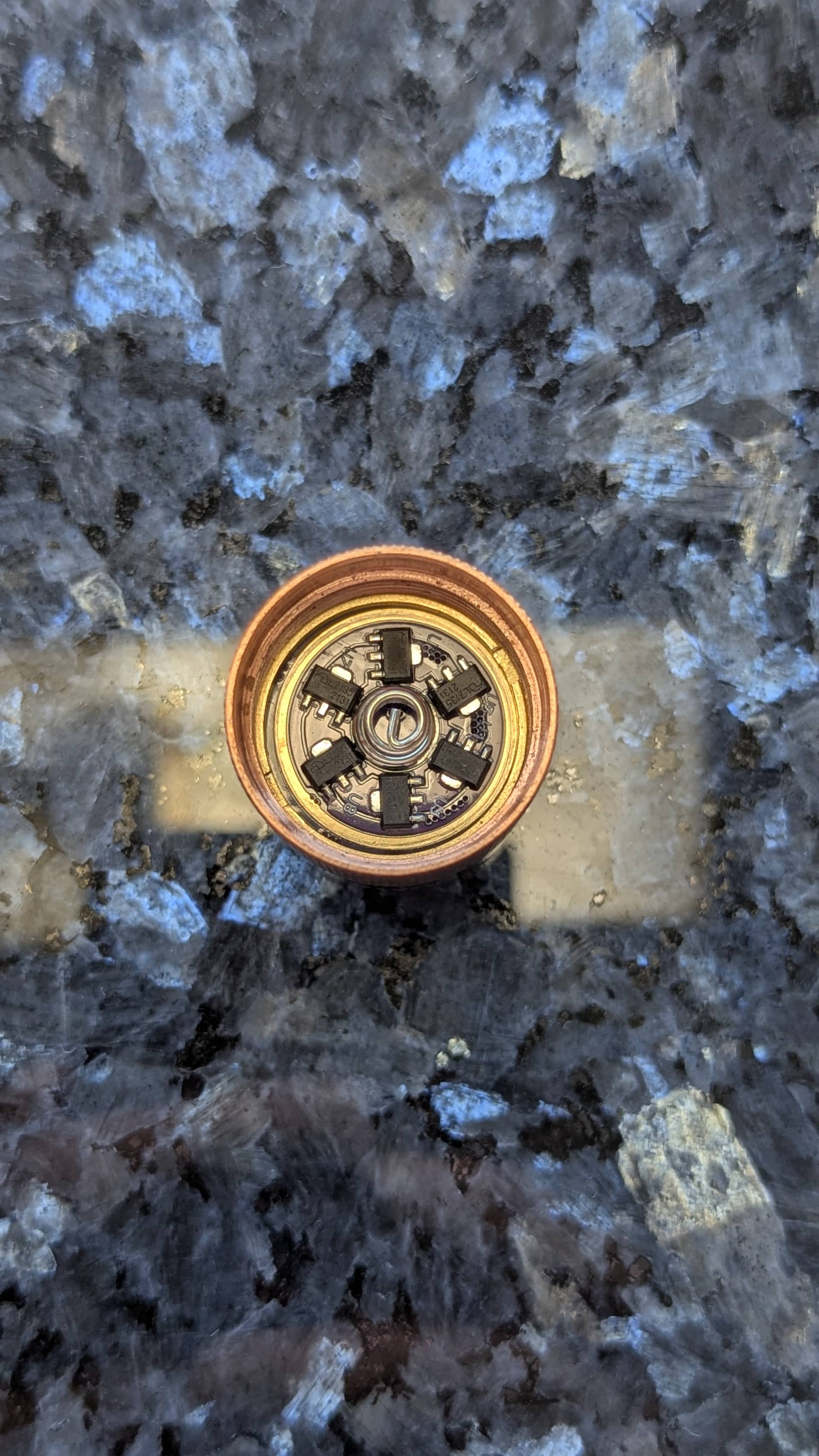

Can you share a picture of the FW3A driver? I’m hoping we can confirm that it’s the 7+1+FET and not the 1+FET driver.
All of the new ones I’ve been seeing are a Red PCB FET+7+1

The driver for the 3A is this one.
Is this applicable to the “new” 2026 model as well as the previous one? I guess I will find out. I ordered one of the new models yesterday.
This is the new ones. Old ones depends on if it’s the Lume driver or not

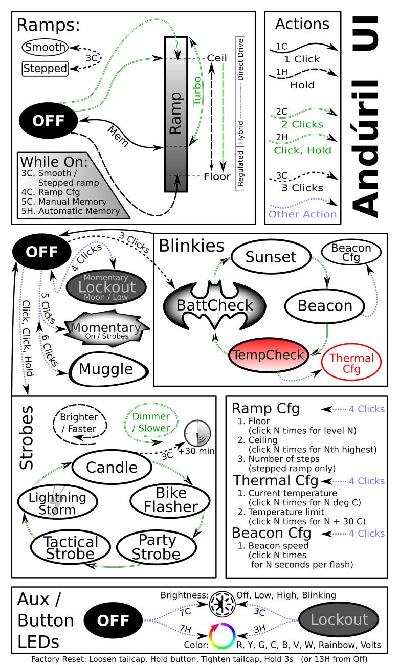

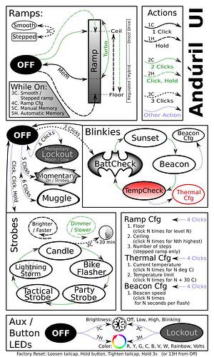

The Anduril 1 UI diagram may be helpful. This diagram is newer than your light though, since it shows features (like RGB aux LEDs) which didn’t exist in 2019.
