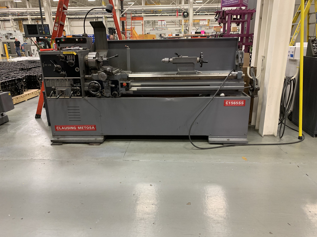

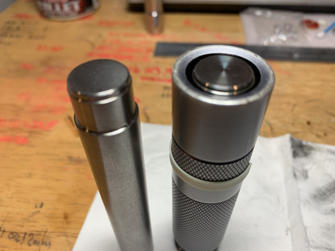

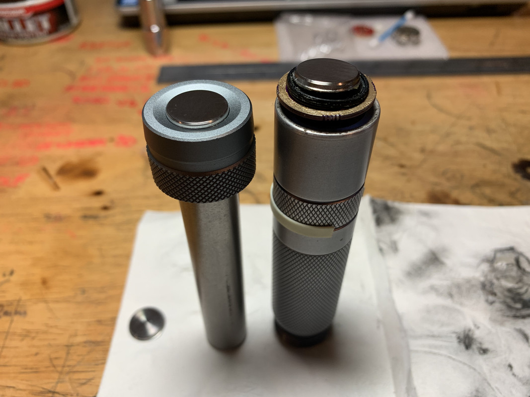

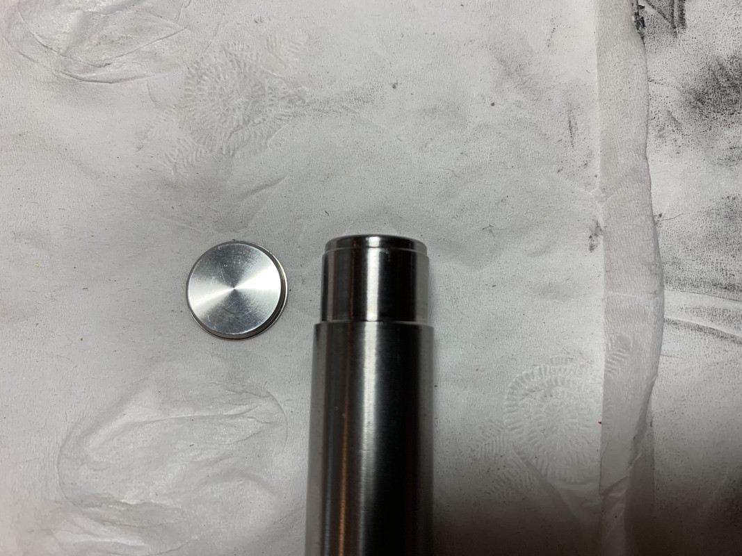

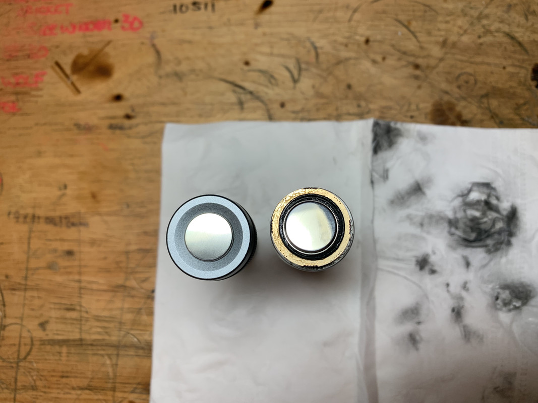

Had a bit of time to play with the Ti Bar today at work on “Da-Beast” mostly testing speeds, feeds, tool edge prep, ect. Need to gather up a few more tools, carbide tipped parting bit, a few 1.5-2-3mm diameter carbide ball nose end mills for the trit slot or slots? More or less what ever I can beg, borrow or steal…. :smiley:
Da-Beast old worn out beat up…… would Love to have it and rebuild it!
wow. what a machine. I have 100% respect for people who know how to use this “beast”.

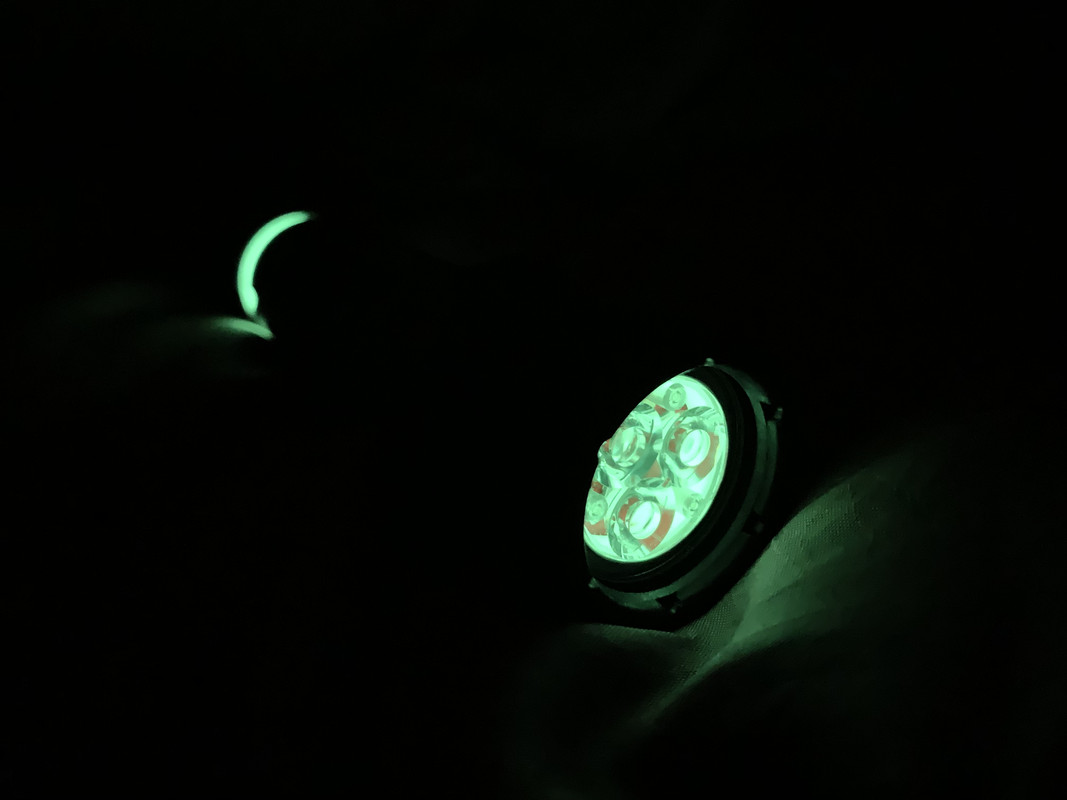

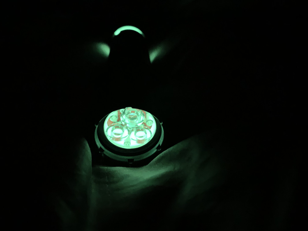

Glow gaskets coming today, drilled out optics ordered/shipped last night, but the trits are/will be on the slo boat from Neal. Neal has them for $5.50 which is the cheapest I could find, but never know when he will ship - ordered an E01 with them, no idea if in stock or not w/Neal, so... ???
I bought my trits from MixGlo and was very impressed with their attention to packing detail and speed of fulfillment.
+1 for Mixglo
Yep, that's where I bought them last, but truthfully, that website is scaring me off with all the hype over shipping, etc. in big colored fonts.
Same here got mine at MixGlo, fast to ship and Daniel answer’s e-mails quickly too! :+1:
When the Glow Die’s….
The Tri’s come Alive!

Installed some GITD tape. Works pretty well. But trits would sure be nice…
Good one!! :beer:
@ xevious …. Thanks for sharing, interesting info. :+1:
I tried to apply a strip of GITD tape to the inside of the head but couldn’t get it to stick very well. It worked fine in my Convoy S2+s. Just me and my crappy tape?

Maybe crappy tape? I used a quality one. Might also be in how you applied it. After cutting a strip, peel off a couple inches of the backing, then anchor the starting end along the inner tube wall right adjacent to the MCPCB. There’s a distinct “band” of smooth metal there, then a slight lip. Thickness of the strip should match it I estimate about 3~4mm. If you’re using a GITD tape strip taller than that, the optic might press against it and pry off the wall.
While applying, use a toothpick to assist. Give light pressure on the tape initially using the toothpick to help with getting the alignment right, then press down with the tooth pick to firm up adhesion. Go 1/4” at a time. When you get near the end, snip off the excess, then follow up with running the toothpick all around the tape. It should definitely stay for 2 reasons — 1) it’s a totally protected zone, with no chance of being touched, and 2) the heat will help bond the adhesion to the inner wall.
