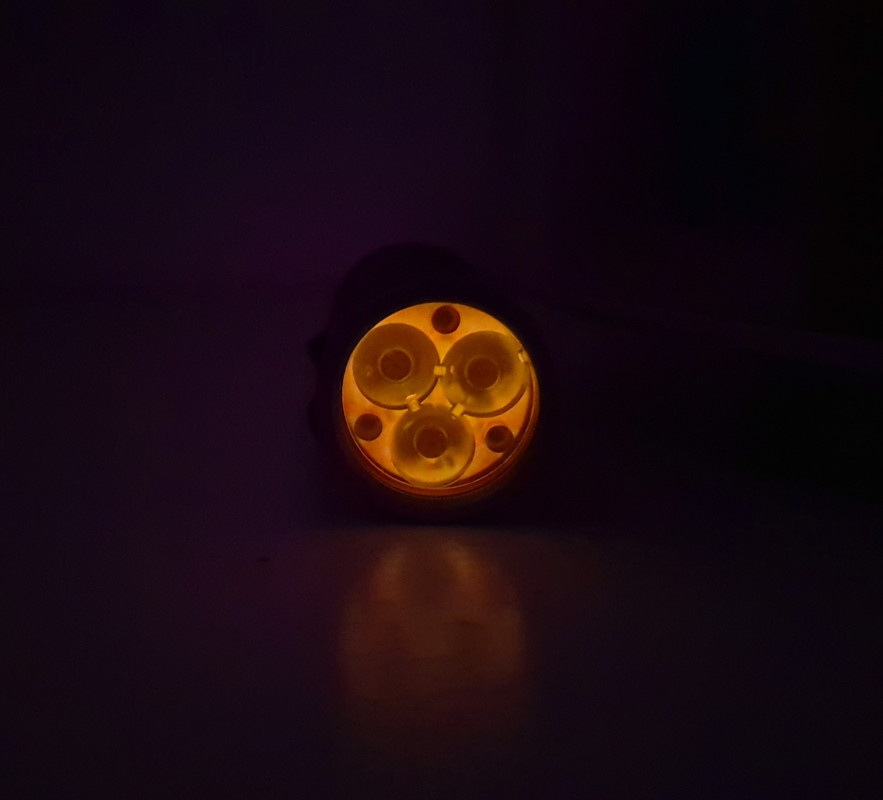

Full glow:

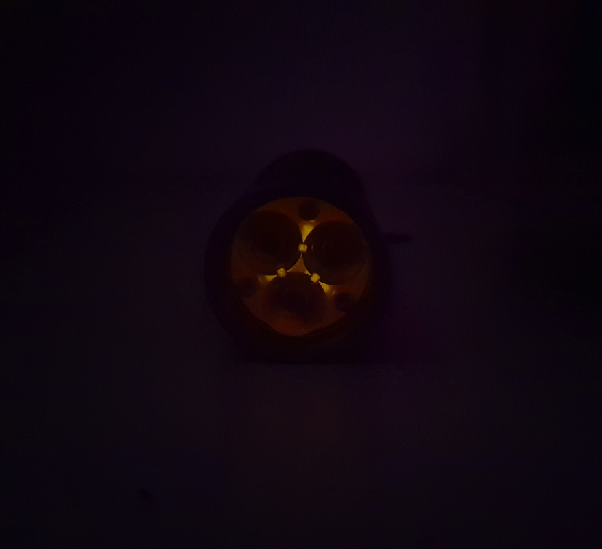

Just trits:
Quite a difference.

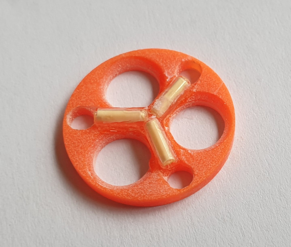

That printed one looks pretty useless.

That looks great! So how long did you wait for the GITD ring to “fade off” from light exposure before taking that photo? If the tritium is strong “just” enough to cause some illumination of the GITD ring, that’s really cool. And innovative — haven’t seen anything like this before. I may end up not waiting and getting a GITD insert to do this mod. :slight_smile:
The full glow is after around 5sec turbo.
The trits only shot I took after an hour. But it looks fairly similar after half an hour.

OK… so the trits actually might not have any noticeable influence. An hour later isn’t long enough to know if the GITD has totally worn off. I find that my Tec Accessories GITD key fob will be slightly glowing like 7 hours after exposure to a bright flashlight.

After eight hours the non glow picture looks the same. The orange glowring is dead within an hour after a short charge.
