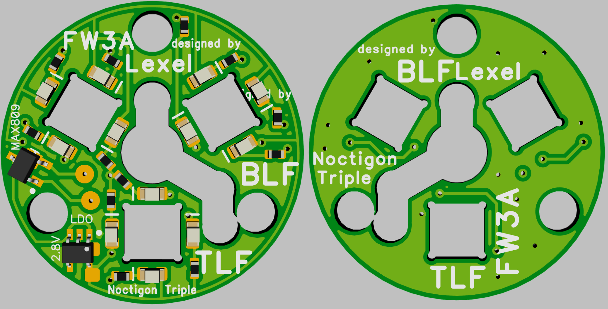

I’m waiting for the $30 model because I’ll be immediately swapping to rosy Nichia emitters too. :slight_smile:
Will you be offering these for sure Lexel?
