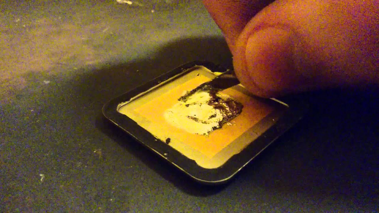

Video I just found of a guy who made some liquid metal paste with recycled indium solder plus gallium:
www.youtube.com/embed/P_JyKEyzeno
Enjoy! :-)
Cheers ^:)
