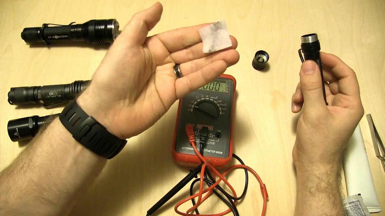

I believe there is a video of troubleshooting flashlight problems that goes thru cleaning and tightening things, which eliminates a lot of problems. Not sure where I saw it however. Hoping the original poster gets his light working again.

I don’t know if this it the video Saypat had in mine, but it should help you troubleshoot most flashlight issue. For all their advancements, flashlights are still pretty simple tools.
