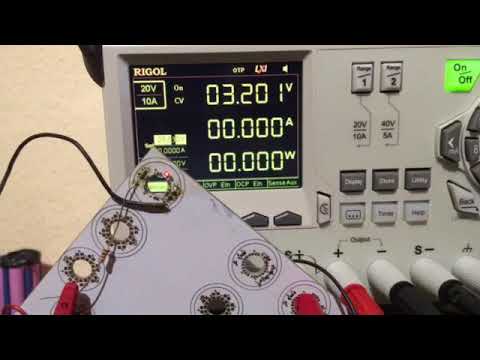

old values showing hysteresis
https://youtu.be/8g3PkN4f5WE
new values, works better

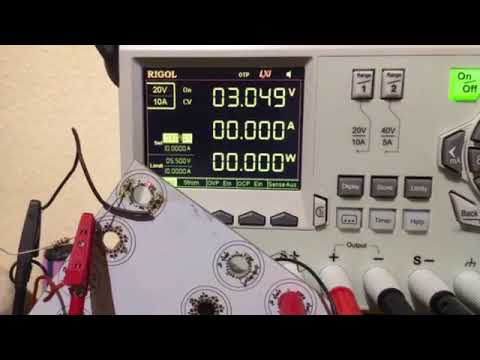

I got a major problem here on my builds I can not firgure out
I removed hysteresis and adjustable reference, but it is still odd
If I put the board on my PSU and it is on I can connect it it is lightning up, reducing the voltage makes it go red and then turn off
But when I increase the voltage it does not turn on anymore or go from red to the other color
I measured the voltage on the ina+ and b+ and it is higher than the reference, but I got to disconnect the PSU to turn it on again
PS
finally found it running the comparator on 2.8V LDO with a higher voltage from your voltage dividers at levels above the 2.8V did not work
running the Maxim 9022 with 2.8V reference from LDO and Vcc on battery supply works now
seems it can not compare higher voltages than its Vcc or close to it
