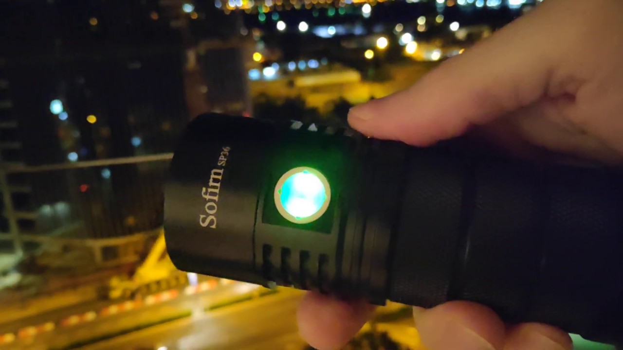

Two sofirn Sp36 including bats for that price? You get redundancy
Built in charging so you never had to take it apart … just clove hitch (or double clove hitch) some stretchy cord as a lanyard
Ans buy a liito kala 402 or other such charger and keep it in a sealed pouch as a backup as well for 10$ USD
Or a dive light … sofirn makes a few and you can get 2 with bats and charger for your budget

I like the SP36 more than any sane person should, but the primary challenge is that it has no lanyard mounting holes.
