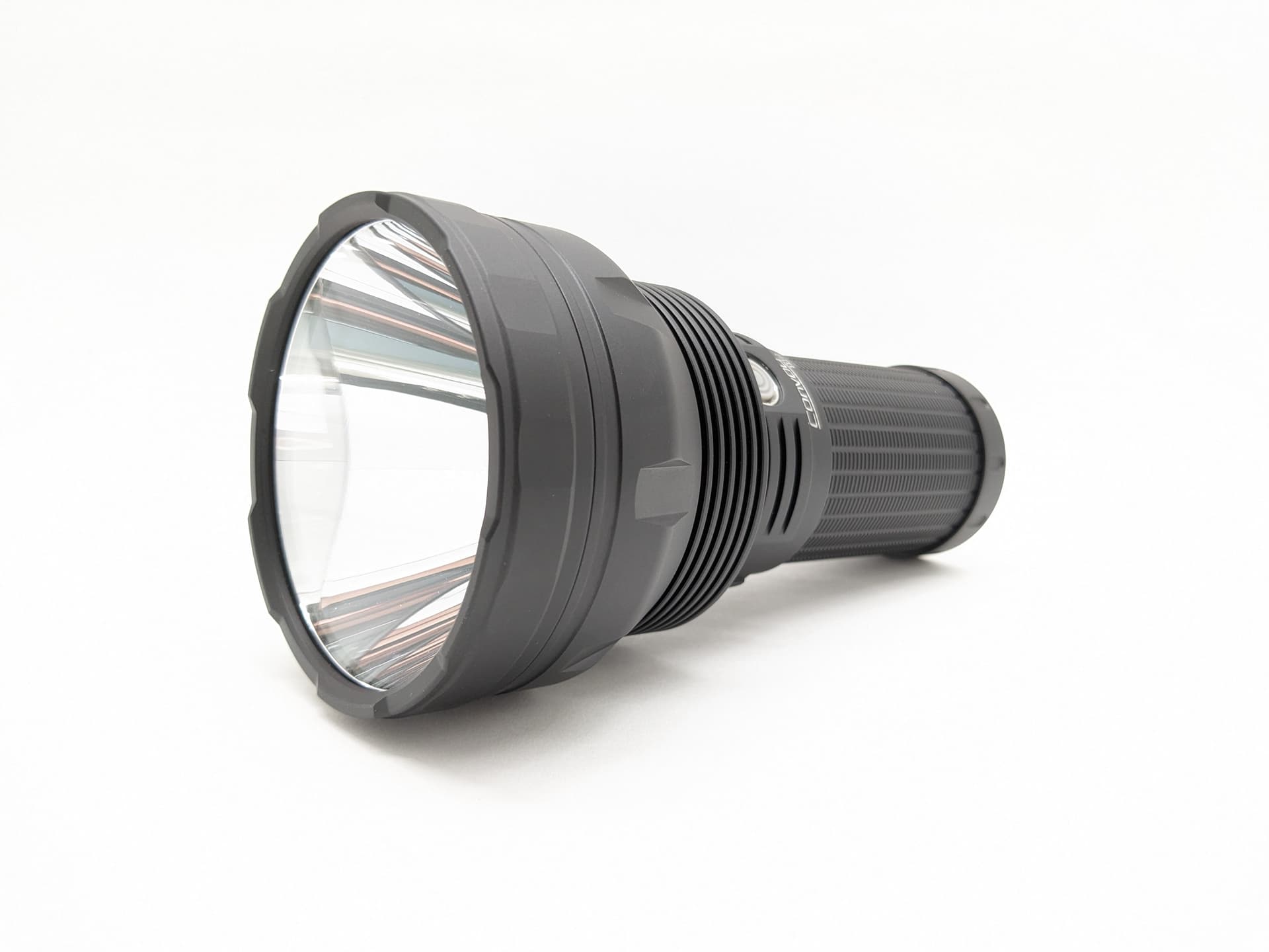

Grizzly's Convoy 3X21D Review – Best Bang-For-Buck Thrower
3X21D gives you a lot of bang for your buck. A good design, nearly a million candela, integrated charging, powerbank, and even batteries optionally included for around $100. My only gripes are the lack of an external battery indicator and some of the quirky UI behaviors. I love the performance, ergonomics, integrated charging, and low price! I think this is the most compelling large thrower on the market right now because it’s such a high value for money, and it will be replacing the Sofirn SP60 in my personal collection for the foreseeable future.

I reviewed L7 previously. You can compare the runtime graphs in my reviews of each light. I strongly prefer 3X21D now because of the integrated charging & powerbank, full control from a single switch, and more impressive beam. L7 is an excellent light but it’s less polished.

What makes the beam more impressive? Throw, spill, shape? I would like to know more :slight_smile:
The hotspot is narrower and it throws further.
Ah gotcha, so it’s the better thrower. I actually like that the L7 is more of a combo beam, but I might still want to try the 3x21D at some point. Thanks!
