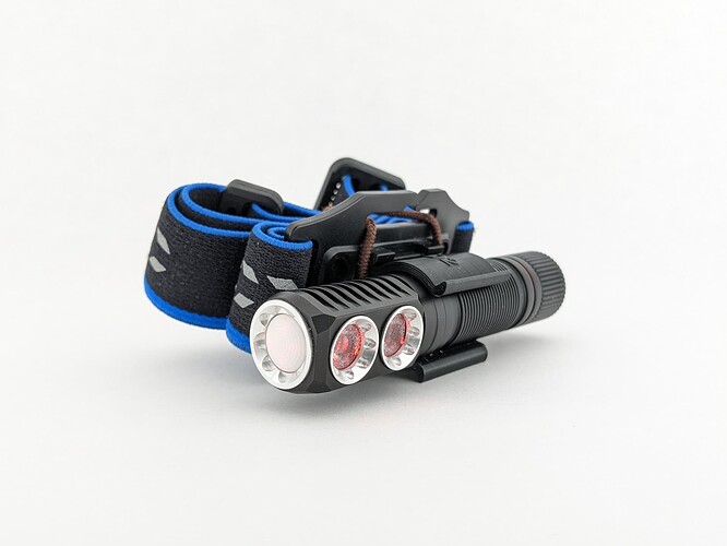

Grizzly's Emisar D2 Review - Feature Packed 14500 Light
