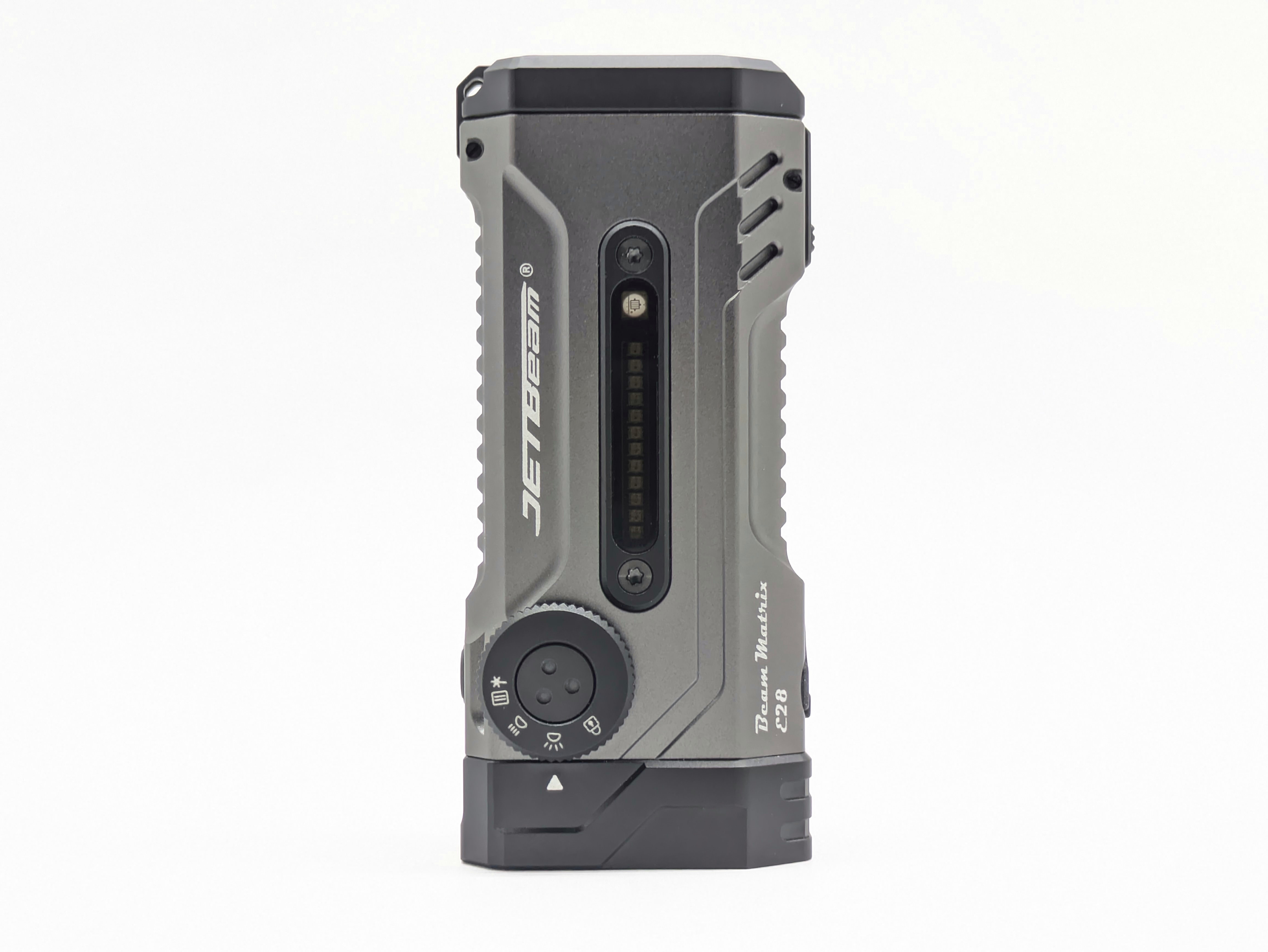

Grizzly's Jetbeam E28 Review – All the Features
Tl;Dr: The design is very similar to another popular light. Pricing is a bit expensive. The build quality, runtime, ergonomics, regulation, user-swappable batteries, and switches are all great. The brightness, voltage immunity and powerbank function are good, though my sample has a powerbank issue. The beams are fine but I would prefer a tighter spot and wider flood on a light that has both. The UI is clunky, the UV LED is in a poor location, and the clip is borderline unusable. Overall, it’s a decent option with a lot of features (spot, flood, UV, laser, RGB, user-swappable batteries, powerbank, etc).
Read the full review here!
