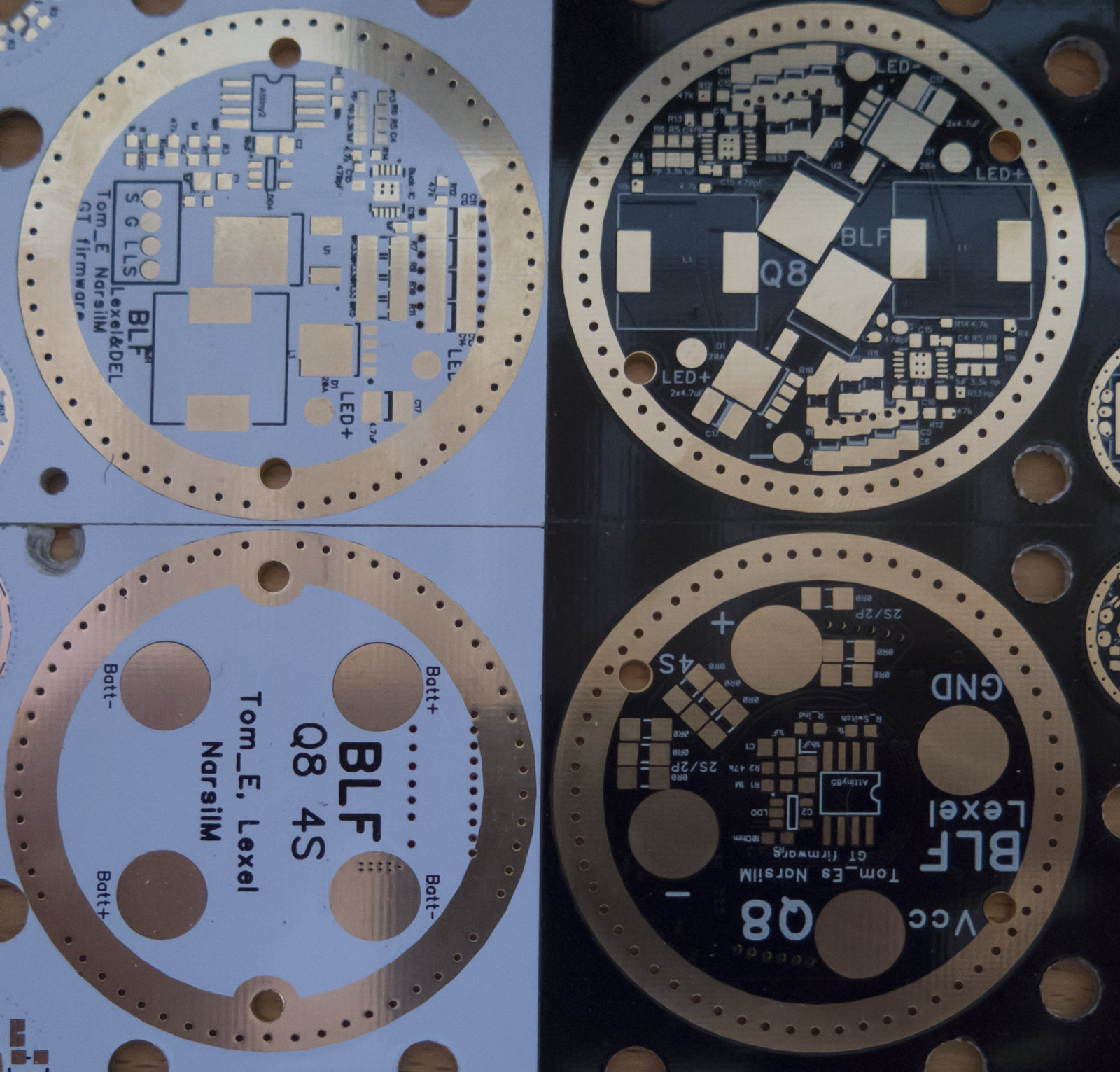

Ok the white driver is for 4S only and one buck engine. The black driver is for 4S or 2S2P and 2 buck engines for more power.
For the Black one: Vcc and ground are the inputs to the driver. + and - is for connecting the batteries with 4S and for 2S2P its connected to Vcc and ground?
Whats the maximum current for one buck-engine? 8A?
4S is for original 3535 MCPCB with XHP35 and 2S2P is for 5050 MCPCB with XHP50, isn’t it?

The only hard thing is to fix the tube on the head without rotating at the correct orientation to the driver and make a tailcap with carrousel-PCB
Do you have enough space over/between the inductors for a washer or reflector-holder, like djozz showed?
Yes, I think that the single mounting screw is the best idea. It is simple and works. There is no worry about the assembly spinning as the wires can spin freely in the center hole without binding.

In most cases it is not real. Q8 threads are not synchronized with driver screw holes.
This decision is not safe. To make it more durable, you need to add extra pcb and fix it on the tube, and change driver pads to the design that allows rotation.
A driver with pads that allows rotation are a different driver design as shown.

But with the design of lexel (and others of cause), we need a tailcap-pcb which allows rotation and the tube has to be fixed to the head at the correct orientation.
This is how board will look, it's based on djozz' measurements. I'm sending gerbers to factory tommorow.
If anyone sees some kind of error, please report.
Any need in back plug to hold cental screw?
Looks good to me.
