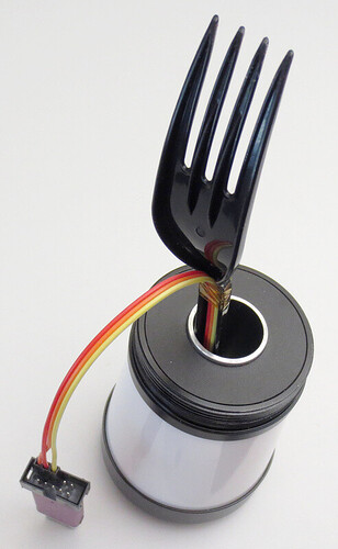

I guess that there are flashing pads… remember the plastic fork… ![]()
So I suppose that gives an option for those that have the proper flasher…and a fork… ![]()
I have flashing kit but don’t own any forks, guess I’m out ![]()
Hopefully the gchart flashing kit fits down the tube, or I’ll have to get a fork and some other hardware.

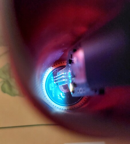

I’m pretty sure the first batch will ship with a prototype firmware from @gchart and I also guess that the flashing adapter from @gchart won’t physically fit into the battery tube. In any case it would be hard to hit the pads. There are two sets of flashing pads. One set matching the spacing of @gchart’s adapter and one set with a larger 0.1" spacing. The “fork” fits the larger one and should be easier to hit the pads.
The behavior of the red channel that @ToyKeeper has discovered holds me back from buying this version so far. It’s really unfortunate that the hardware wasn’t tested better before this run.
I don’t know if Gchart adapter is wider than mine (16mm), but it fits in a 21700 tube and has enough play in it to aim for pads located anywhere on the driver, it’s just a bit difficult to aim
though the power LED helps.

Reflashing is possible, but requires an adapter and some dexterity and a way to get little parts down the battery tube. I’m lucky I had the right spare parts here…
- a compatible flashing dongle
- DuPont female rainbow ribbon jumper cable
- pogo pins which fit into the DuPont connectors
- a plastic fork of just the right size and shape

I tested mine and it fits into the 18650 tube of a D4v2, so it should be no problem to use, if the pads remain in the PCB. It did need me to take it out of its case though.
