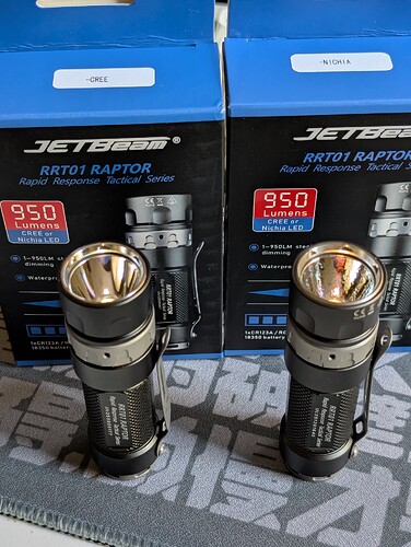

One of each arrived in Australia.
3x spare o-rings, lanyard, two spare screws for the pocket clip and an allen key.
The 18350 with USB-C charging works with USB-C to USB-C with a PinePower Desktop V1 (QC port, PD port and regular USB-A port) but the charge rate is a bit too high. 5V/1.7A.
