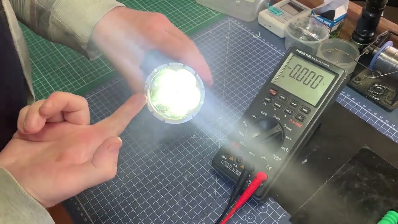

I recently ordered and received a HAIKELITE HK05 FAULTY from Banggood.
It will not turn off completely. it sill illuminates slightly even when off.
I have to remove the tail cap to turn it off completely.
I submitted the ticket with Banggood 6-6-24. complete with a video, asking for a replacement to be sent.

Ps. Given the price of the flashlight and the high shipping cost (if you would ship it back), it might almost be worth it to find someone specialized in electronics to see if he/she can fix it. Given the description of the problem, it feels to me like it might be just a faulty component on the driver.

I don’t know how your soldering skills are, but maybe you could try to order a new driver from Haikelite and swap it with the current (probably) faulty one? It might be just as expensive as the shipping costs in case of returning it, but you might end up with a working flashlight instead.

I know this may be a wild shot but have you tried with button top batteries?
That’s why I’m buying mostly through Aliexpress now. Free return is really helpful in case like @op mentioned.
Mike
I was also thinking of this, but because I’m not completely sure if this behaviour (i.e. not turning completely off) can be explained by a poor battery connection, I didn’t mention it.
As far as I know the HK05 uses 3x 21700 in parallel, so I assume that there is a (brass) positive contact ring on the driver side. If that’s the case, then it might give problems when flat top batteries are used. So trying out button top batteries or using a battery adapter like Convoy sells, to make good contact, might rule out a battery connection problem.
Might not solve the problem, but it wouldn’t harm trying it out, to rule out this possibility.

The Positive contact ring seems to sit quite a bit proud of the PCB. So it looks like the batteries are making good contact.
It certainly lights up to full brightness when it’s on.
Unfortunately I don’t have any button top batteries in this size.
But I did try to test it by adding some small Neodymium magnets to the top of the batteries. Same result.
