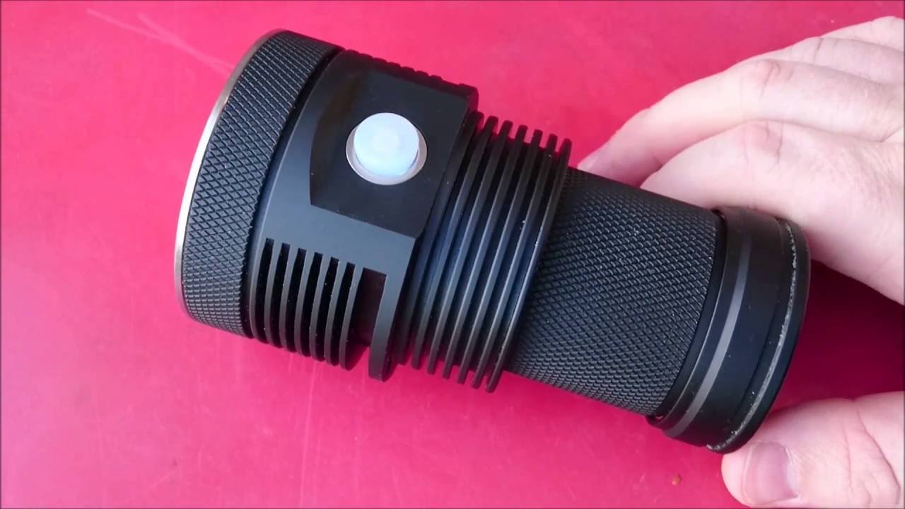

Now lets talk size the MT03 has some serious weight to it! The MT03 weights a whopping 600 grams without the batteries. It sure looks small and tiny in fact so small and tiny that you wouldn’t think it weights this much. With the batteries the MT03 weights a nice and Bicep curl ready 790 grams. The head alone on the MT03 weights a huge 404 grams just the head!
The reason behind all this mass is cooling you need a hefty built flashlight like this to help keep the LEDs cool. That is why the MT03 is able to sustain such a high output for such a long time. Without stepping down to the level other flashlights do. Even when the MT03 steps down the output levels is still amazing. The overall length of the MT03 is 127mm (12.7cm) the head diameter is 72mm (7.2cm) and the body diamante is 50mm 5cm in width. The head is a lot larger then the body on the MT03 this helps a lot with keeping the light cool its better to have the weight where you need it. Plus there is no need to make the body as big as the head because the 4 cells sit nicely as is with this body shape. This design also gives the MT03 a unique look and helps keep the weight down overall. It looks different to all other Soda can style flashlights on the market now. Most other lights look like clones of each other.

The MT03 comes with a stainless steel bezel and button retaining ring. The tail cap on the MT03 has a sliding PCB that spins around when you tighten of loosen the tail cap so you so the batteries always stay in place. The tail cap also different size prongs so you can not confuse the side. The MT03 has a tripod mount this will come in handy for a lot of people considering the weight of the light. It is a super flooder so you can mount the MT03 on your tripod and light up the park and play a game of soccer. Lots of little thing on this light shows you that Haikelite care about there products. Haikelite has even gone out of there way and can personal any of there flashlight for you. The MT03 is super mod friendly you can take this light apart in minutes. I do not think you will need to do much to the MT03 its a great flashlight stock the driver looks easily modifiable for extra power if that is what you want. The MT03 will handle extra power fine considering it takes well over 2 minutes on a warm night for the light to start to heat up.
