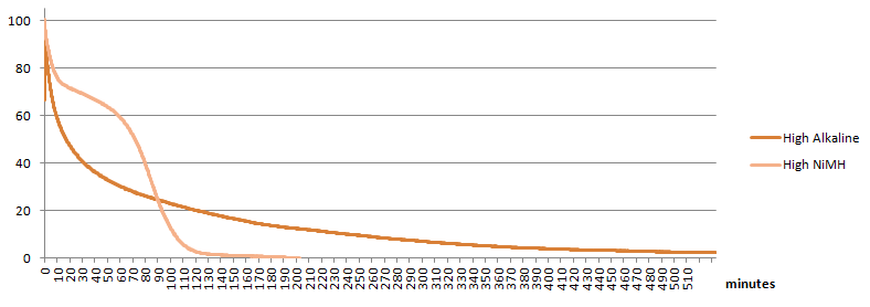

It depends on the current draw. For ~100ma or less, it doesn’t make much of a difference. For higher draws, the runtime curves look like longer versions of this*:
Eneloops maintain higher output longer, but they drop off faster once they reach the end of their charge. Alkalines dim more quickly, but they have more runtime near the tail end of their life.
*image borrowed from HKJ’s Thrunite Ti review.
