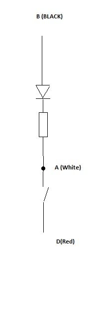

Thanks again MK96!! Sadly it didn’t fix it. I removed everything on it to draw the schematic of it. Should look like this.
It seems like the little board is missing a feed, I get 0V no matter how I measure on the wires. Perhaps something fried when I connected the battery when I got it and it had loose wires inside it. Anyway I got feed up with it and got crazy…when I connect the black wire to battery( red wire on main board) the light comes to life but I can’t get it to change mode.
Does anyone know how the mode change work on the main board?
It seems to be just an ordinary button, not switch. If you connect red and black (from the schematic you draw) together for a short time simulating the “button pressed and released” it just doesn’t do anything? Nothing fried on the main driver PCB?

I’ve tried and I can’t get it to change mode no matter what i try. I can’t see any damage on the board. I will try some more but I think I will use this light to see what it can do and then perhaps buy a new one.
