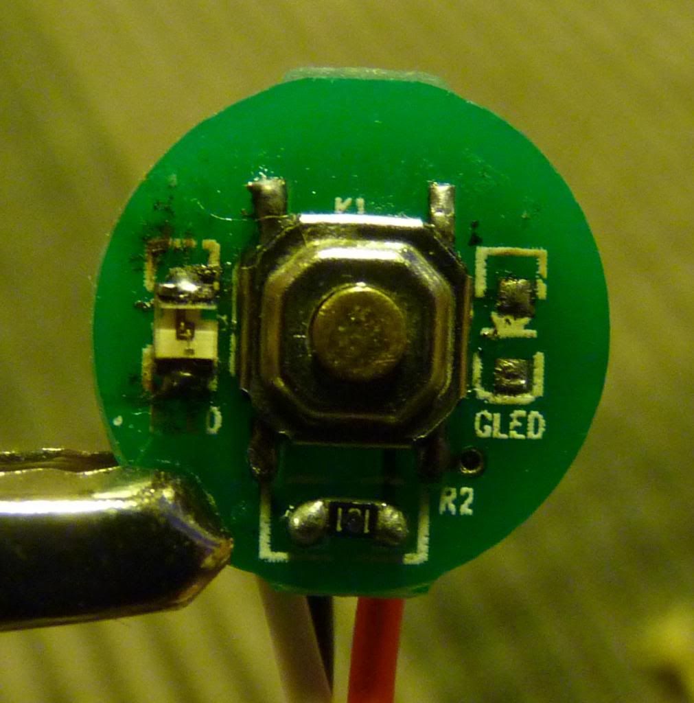

Regarding my broken light I have opened it up and found two loose wires going to the board with the on off button. Lightmalls claimed that he checks all lights before shipping, well he didn’t check mine. I’ve planned to mail him and ask for a picture of the on-off board with the correct wiring but haven’t got to that yet. Perhaps you could help me with that?
Also on the on off board there are one led but on the circuit board there is a marking for another led, my board only has one led. A picture of the board would be really helpfull!

I understand, the wires is a mess and short… I’ve tried to sort it out but if I recall there is 4 connections total on the board and with two loose wires it is hopeless. I will email lightmalls, he said that he would help me.
There should be about 20% efficiency between XM-L and XM-L2. Yes mine are all from Lightmalls. I think resistor mod will be possible (you may add additional heatsinking to the driver board), but this 7 XM-L without resistor mod is as powerful as the one you gave in link 7T6 with the resistor mod. You should have 7 wires going from/to the board. The red/black from the battery, another thick red/black to leds and finally red/black/white thin ones going to power button (I think the thin white is the wire to the green led on the button PCB, black is usual minus but I will try to find that out).

I have soldered my loose wires now and it got the leds on the back of the light going but not the leds that matter
MK96 does your board look like this? Notice the green little dot on the led in the right upper corner. If you look at the markings on the other side where one led is missing you get the feeling that my led should be in the other direction? Also while measuring I’ve notices that the led is green but on the board it’s marked “RLED” and while on the right emty location it’s marked “GLED”. It makes no sense!
