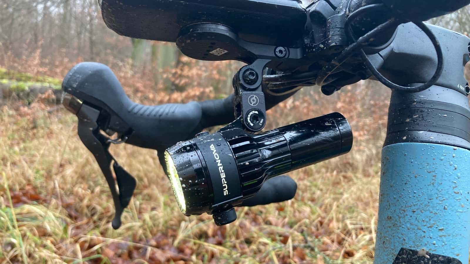

For context, this is pretty much what I’m looking for

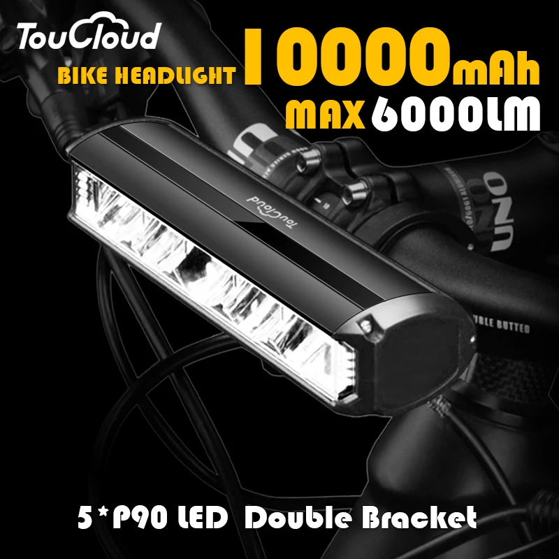

Just as an information for you, I have this light on my bike:
The 5 LED Version with 10Ah battery. I changed the LEDs with 519A 5700K because why not (wasn’t necessary, the tint was OK).
The light is very bright, but you should only use this light without anyone coming towards you, because even with the right theoretical reflector design (LEDs on top shining down), there is a lot of spill upwards.
Luckily I only use it to ride around really dark passages in the forest for example where noone is at night, so it’s good for me, but for the streets it’s definitely unusable.
