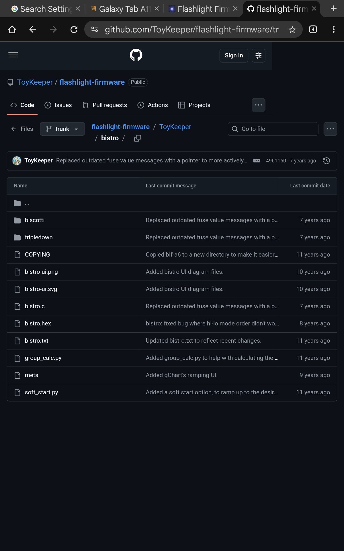

Ok well while i wait can someone point out the correct file to download for Bistro?
Here is where im looking.
.hex is the compiled firmware extension.

bistro.hex found and downloaded.

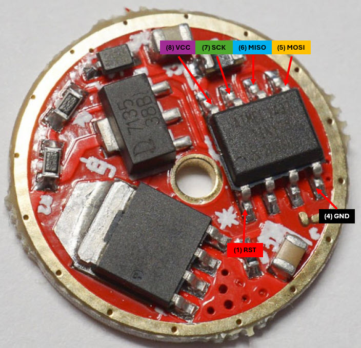

Look accurate to those who know?
Made these for myself but if they are good they may help others.
Checking against the ATtiny25 datasheet, this looks correct (as long as the SOIC clip is installed the right way round).
Non-complaining sidenote, I’ve never seen “GRD” used to abbreviate ground :stuck_out_tongue:
