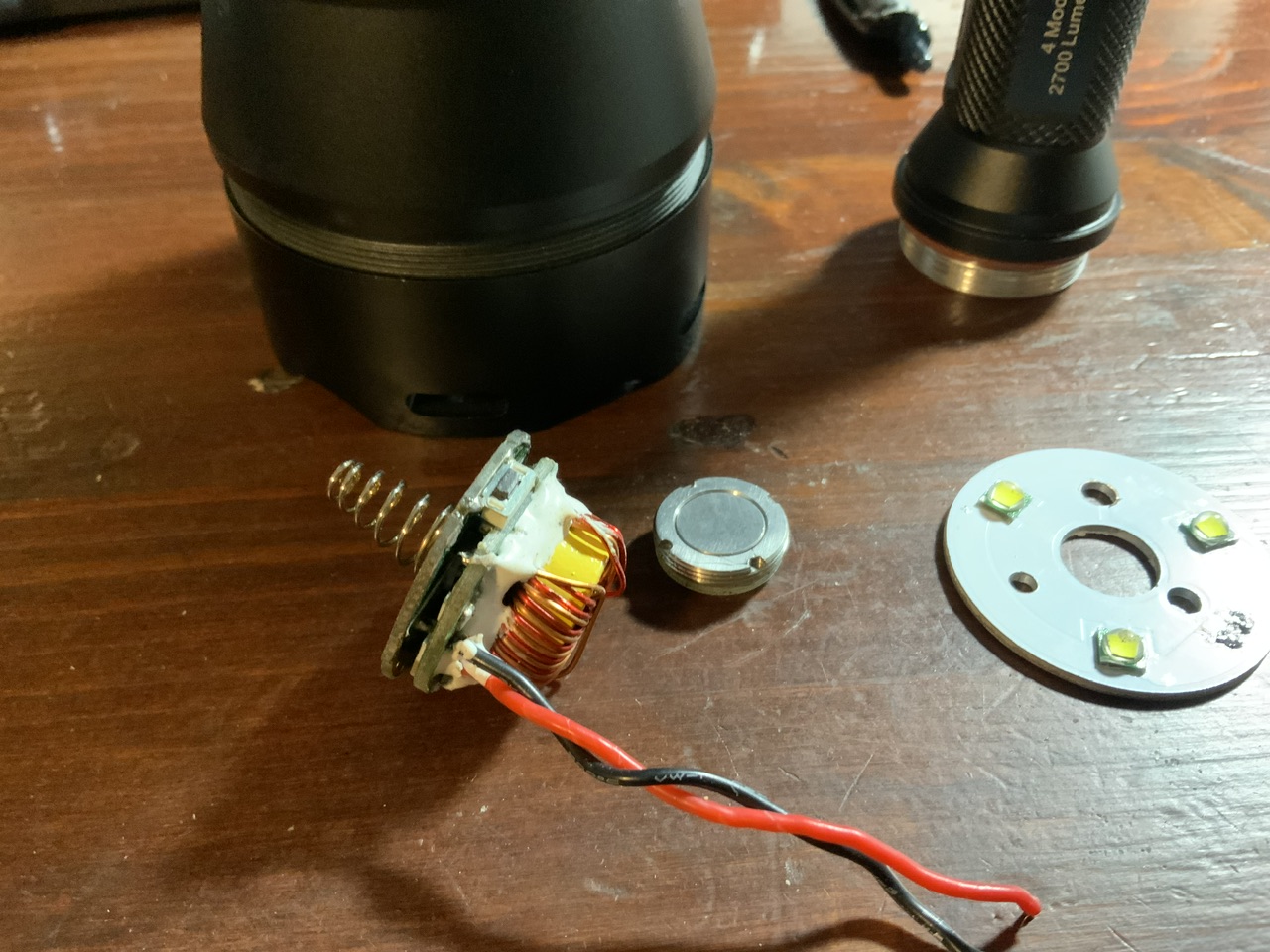

I have a MF Tactical (Monster Flashlight Stingray I purchased in 2020. It uses 2 or 3 18650 batteries. The case say is stamped with 4 mode 2700 lumens. I literally used the light about 3 times and it quit working. Two of the 3 LEDs just have a faint blink. I sent it in for repair but was told the board is bad and they are no longer available. The light was returned to me but I hate to just throw it away. Does anyone know where I could get a new board? I’m not necessarily concerned with the number of modes. On and off is fine. It measures about 29.9mm. See picture.

Now, as for your bad driver, can you post a photo of the light? It’s important to know if it’s got a mechanical clicky switch or an e-switch (like a computer mouse) as this will impact driver choices.

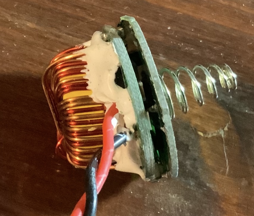

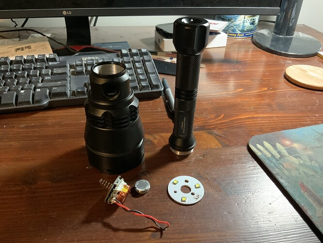

Thank you both for responding. Yes, it runs on 2 or 3 of the 3.7V batteries in series. Yeah, I’ve read other posts about their lights. I don’t see any markings on it so not sure. It didn’t last long so not surprised if at least the board was some junk. I was just hoping I could get a part to fix it rather than throw it away. The switch is on the side of the board. There is a mechanical button on the case that pushes the button on the board. See pics.

Still unclear what the LED connection is, series or parallel. Having a mechanical-only switch is bad news–I don’t know of a mechanical switch driver with such a large diameter. I can imagine stripping this dead driver clean and piggybacking a small mechanical-switch driver on top of it, but not sure whether that is a modification that is accessible to you.

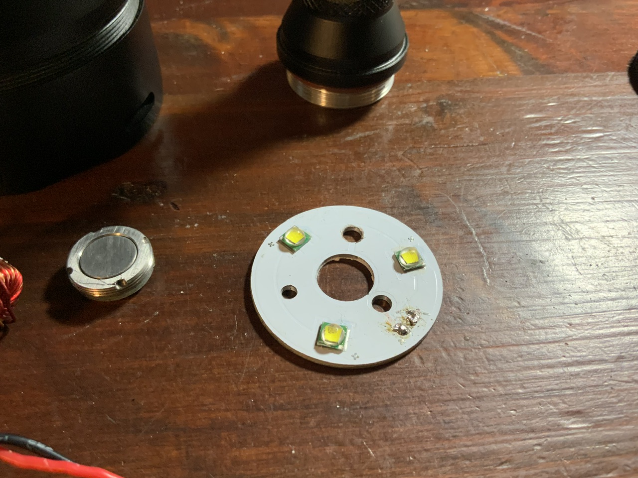

Can you tell from this picture? I think they are in series but not certain.
Parallel config is probable since I see the PCB traces separated into inner (-) an outer (+) rings. But I am not certain.
Wow the factory reflow of the LEDs is godawful, every single LED is off-center, and by quite a lot. No wonder the driver failed so quickly…
