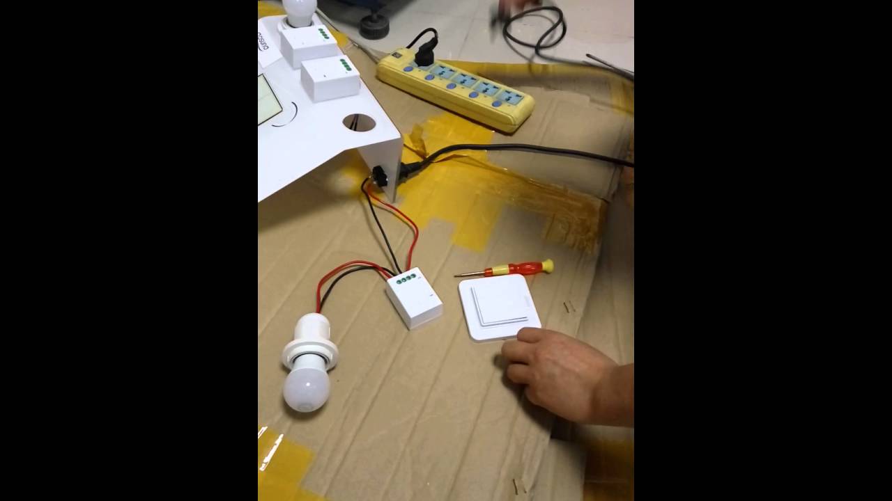

Okay, here it is. I’m a licensed Electrician. This device does look to be simple to install. As others have said, the instructions are at the link provided by dobylili. But what’s missing from the instructions is a description of exactly HOW to make the connections.
Before you begin, read all the instructions and make sure you understand them entirely. Also, make sure power is disconnected from the lamp. If it is a ceiling light, turning off the switch will work, unless you either don’t have a switch or are replacing the switch with this device. In either of those cases, you will need to turn off the breaker (or remove the fuse) that feeds the circuit to that light. If it is a desk, table, or floor lamp or any other kind of light with a plug cord, just unplug it.
From the pictures, it looks like the four green holes on top of the receiver contain Phillips head ( + shape slot) set screws. The small openings on the adjacent side are for the wires. So, you strip off the insulation from the ends of the wires just enough to slip them into the holes on the side. If the wire has multiple strands inside, as most do, then twist the strands of each end so that they don’t separate, before pushing them into the holes. If you are installing this device to any lamp with a plug cord, you will have to cut the cord. That will leave you with the four wires to connect to the receiver. Put the stripped ends of the wires into the holes as shown in the instructions, then turn the screws on the top to tighten down onto the wires.
As has been said also, this receiver should be placed inside something so that the exposed metal connections cannot be touched while in operation. The instructions say that it is best to put the receiver inside the lamp. If you cannot put it inside the lamp, you should buy a small plastic junction box with a cover to install it in, so that it is fully enclosed. After all the connections are made and everything is closed up, the power can be turned on (the lamp can be plugged in). The button(s) and the receiver(s) then need to be paired to each other, using the instructions also provided at the link.
